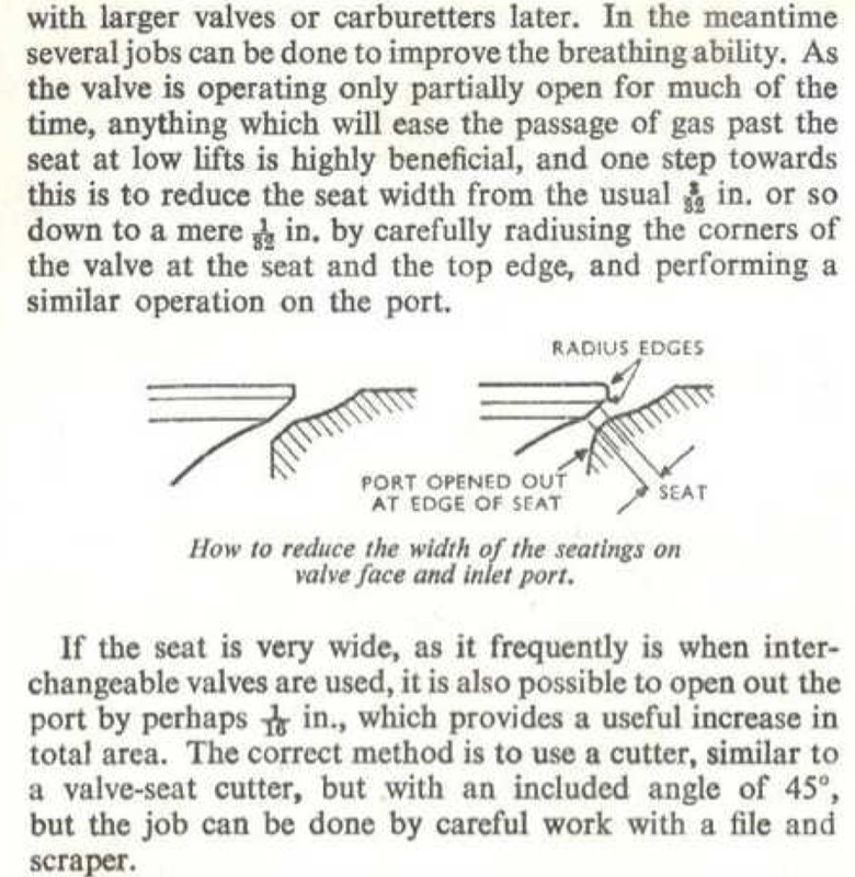

JackyJoll wrote: Sun Jul 13, 2025 5:20 pm P E Irving recommended a minimum 1/32” inlet valve seat width, although that’s for competition.
Are you familiar with three-angle valve seat cutting, to avoid making the radial flow change direction more than 15 degrees at a time, when the valve is open by a small amount?
Err no.
I do know i need to look for a copy of Tuning for Speed. I thought my Dad might have had a copy, but we haven't found it yet.

Try googling Tuning for Speed download. It is or was available as a free pdf here and there.

JackyJoll wrote: Sun Jul 13, 2025 5:50 pm Try googling Tuning for Speed download. It is or was available as a free pdf here and there.
Just had a look and Scribd has it.
AbeBooks also have hard copy versions for sale as well.
