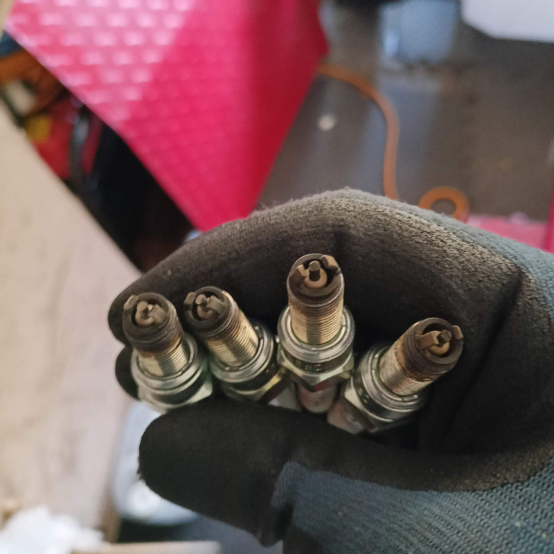

As for the dyno runs, the actual machine agreed with my arse-dyno, with mine logging 4.5HP less than it did at Brands on the same dyno, putting me just about the bottom of the pile in terms of HP (69.9 for anyone interested) with everyone else’s on par with their Brands results.
Hmmmm, some further investigation needed – at the circuit that was limited to looking at the plugs (all looked good) , pulling the back of the airbox off to check that we hadn’t ingested any woodland creatures or anything else that shouldn’t be there (all good too), and that rear brake wasn’t binding or anything like that.
And therein a found a problem, with bad and unusual wear on the inside of the rear sprocket and a small bit of play (again
) in the rear wheel bearings.
I whipped the rear wheel out and one of the bearings fell out- admittedly when I’d replaced them at Brands , one of them had needed very little persuasion to come out, and went in easier than I was completely happy with, but it wasn’t like this.
