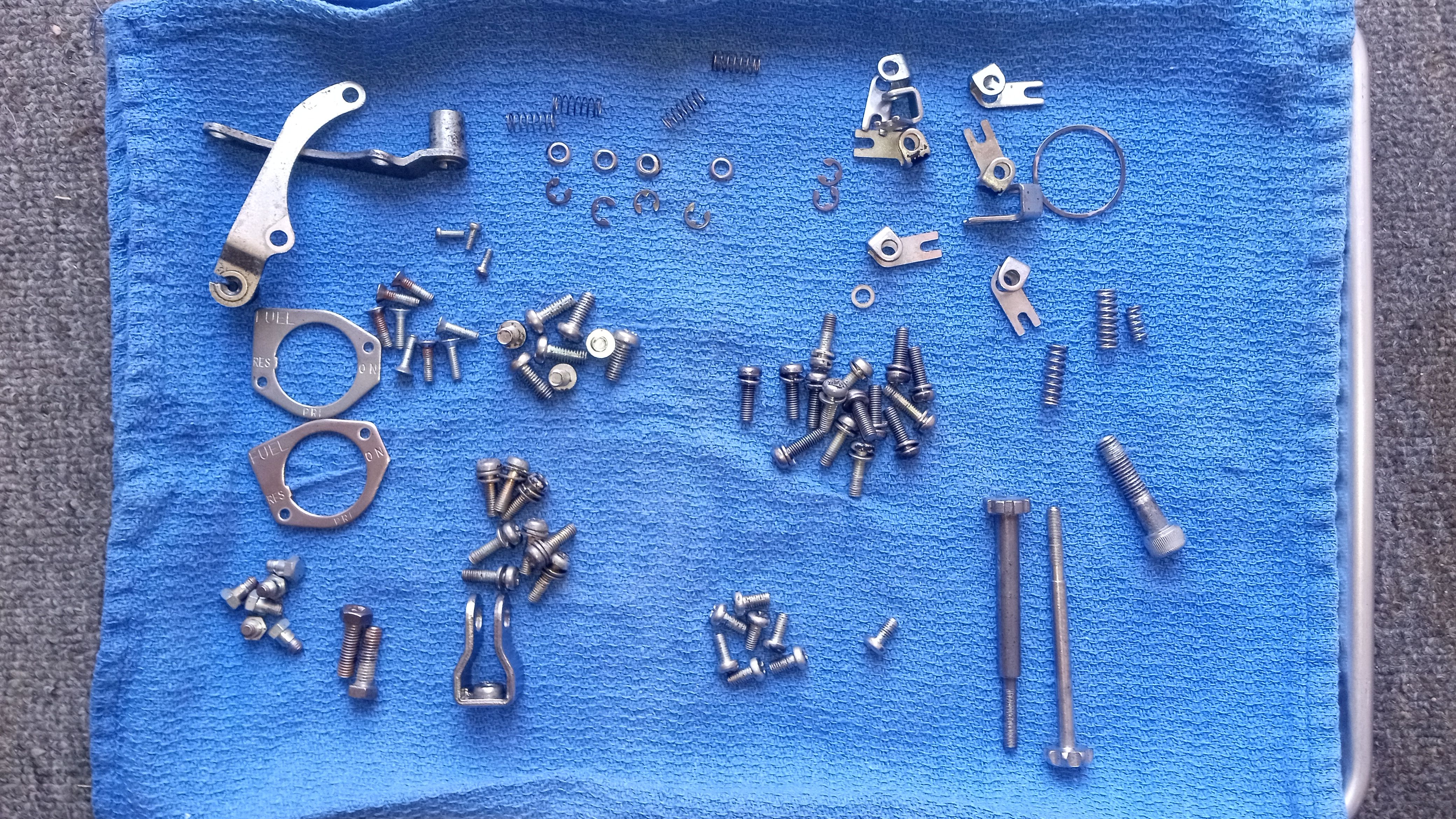

Emptied out the tumbler this morning to see if I missed any parts in there... it's like picking fly shit out of pepper. The media is 8mm stainless steel pins
Threw another load in there for 3 hours.

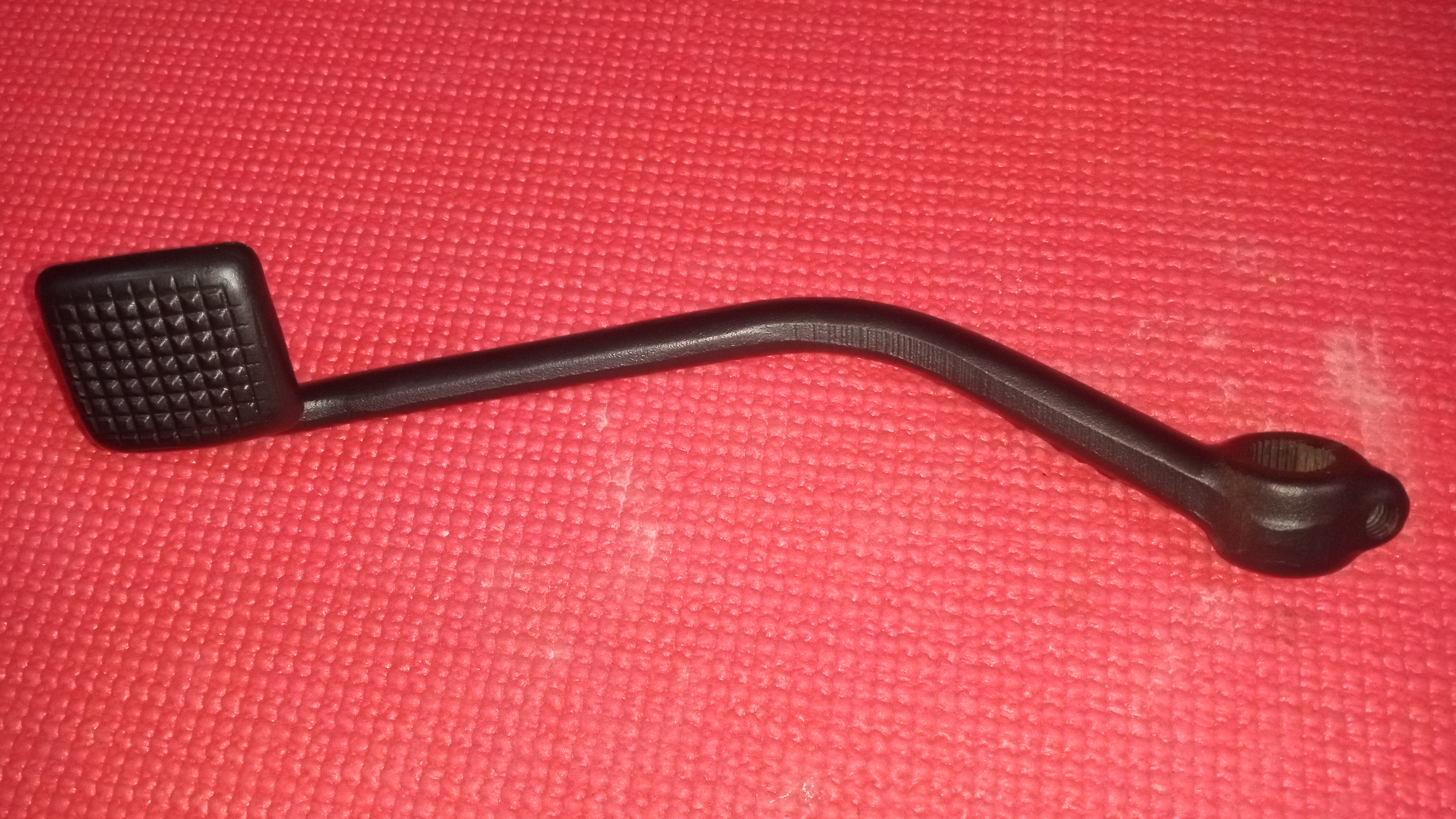

Carb rails & brake lever got the Steel-It treatment this morning. Lever looking spiffy... other bits just got turned over & painted on the other side, so they still sitting in the Sun
Have to be a bit quick with this paint as it comes out of the rattle can like a frigging fire hose.

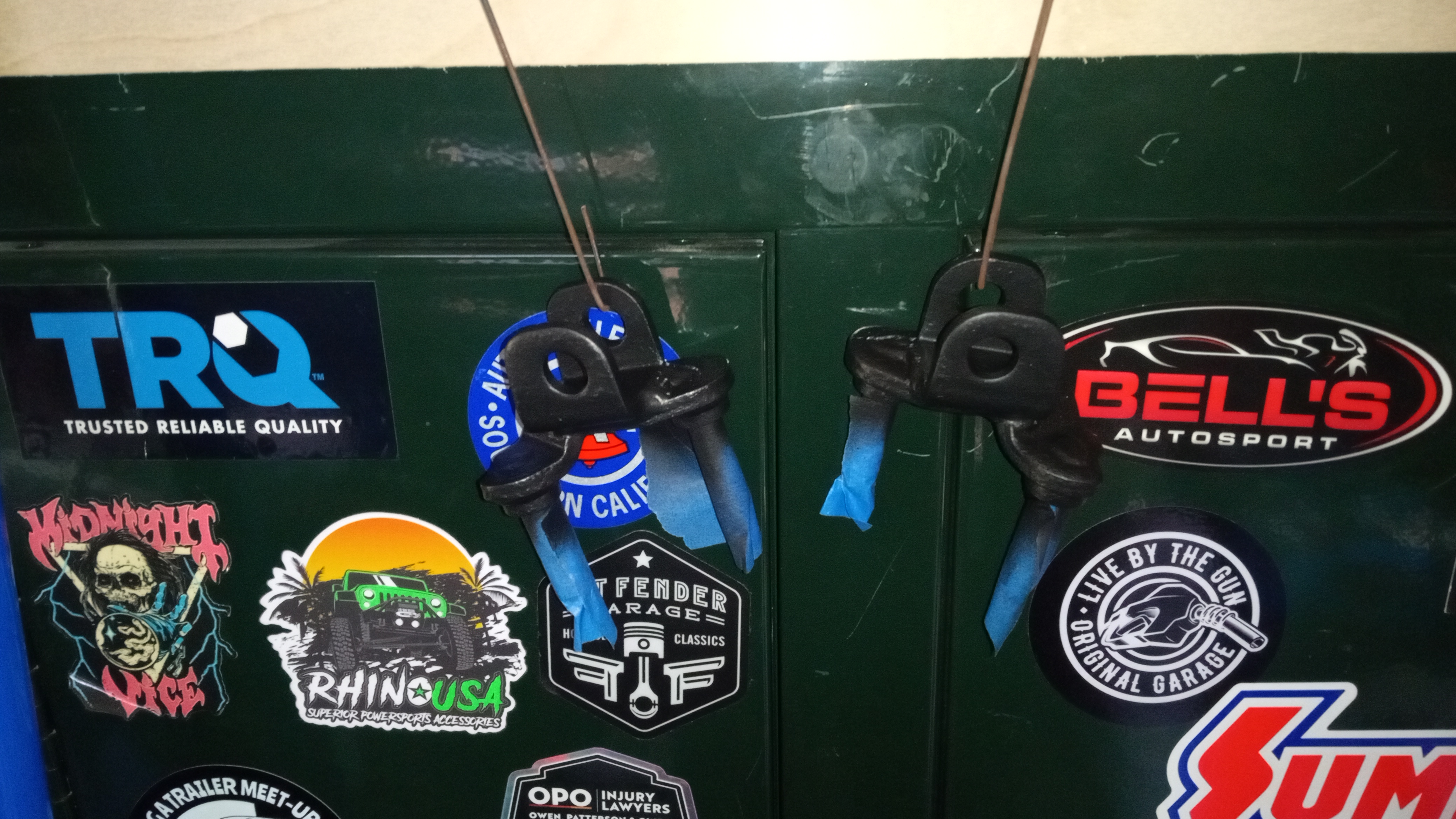

Rear brake pivot doodad also just got the Steel-It treatment, currently hanging on a piece of welding wire outside in the sun.
Finished the tumbling...well, for now. They'll be more hardware from the fairing, front fender, footpeg mounts etc when those parts get pulled off the bike.
There's duplicates in this pile as some parts are from the spare set of carbs. Ferinstance, the thicker idle screw is from the original carbs & the thinner one is from the spare set, as are a lot of the screws.

Front footpeg mounts got Steel-It...Shift lever gubbins will get the same as it's kinda rusty & tatty looking.
