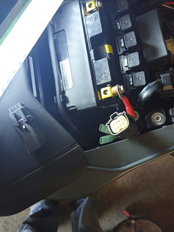

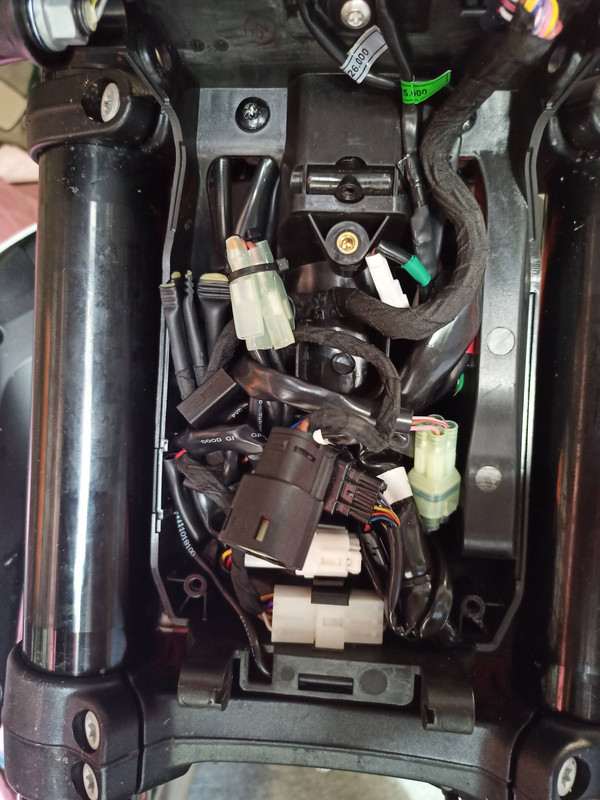

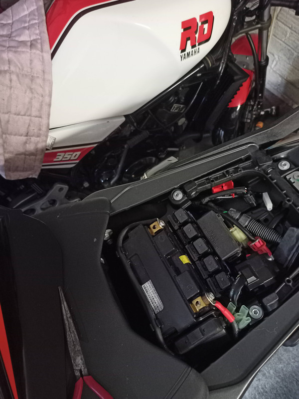

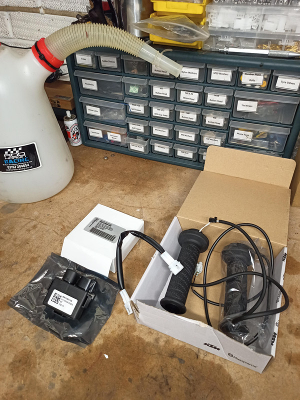

Heated grips time
Choices here were aftermarket (Oxford , Koso etc) or KTM PP option. The 890 differs from the (pre-2020) 790 Duke in that for the 890 the KTM option is available as a fully integrated option, ie, the grips plug straight into the standard KTM wiring loom, and are operated through the existing main LH handlebar switch and dash, rather than add-on with separate switch.
You pay a premium for them, but they are a better product IMO, installation is far neater and a lot easier (you’ll see why in the pics below) than when I put Oxford ones on my old 790 , which involved whittling away the standard throttle grip on the tube as its a one-piece moulded item, and the new grips are absolutely identical in external diameter size and design etc to the factory-fitted standard non-heated ones.
All things considered, it's a no-brainer and I plumped for the KTM ones.

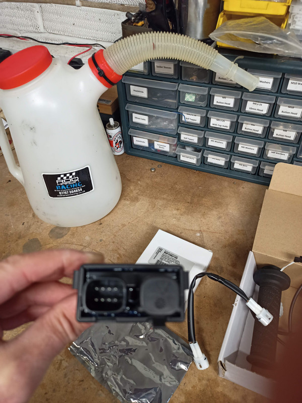

So this is what you get- basically just the grips themselves (RH one is moulded with the throttle tube) and a little electronic control unit, and… no instructions....

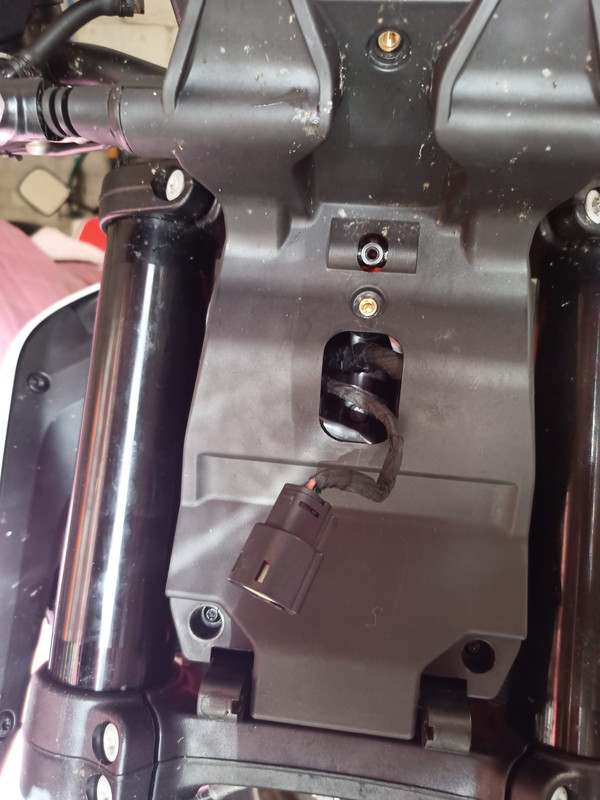

That wasn’t really an issue, it was just a matter of working out where the control unit goes;- a quick google discovered that the connector for it is very conveniently tucked away under the passenger seat next to the battery, and (most importantly for me ) that it doesn’t require a visit to the dealer to enable them in the ECU, so all good.
The control unit connector with it's blanking plug removed
And with the control unit installed

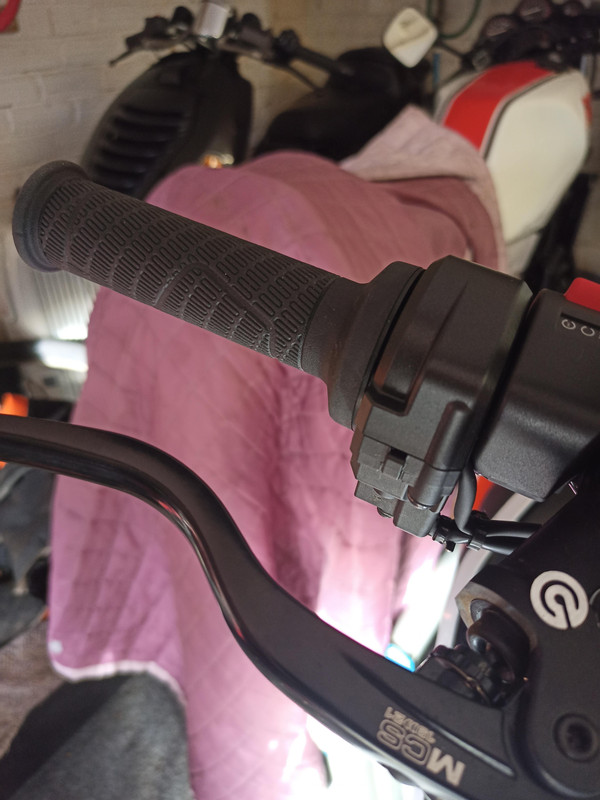

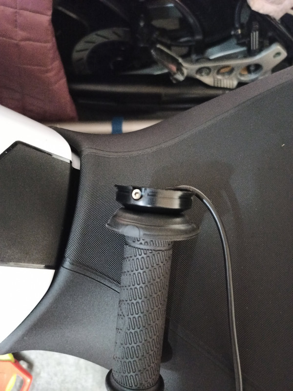

Now to swap the grips themselves, which is even easier than a very easy thing- no knitting needles or glue or needed here, just remove bar end weight, peel back the lip of the grip to expose the locking screw , insert and twist a T20 bit and Robert’s your mother’s brother, off the LH one slides
And of course, as it's FBW, no throttle cables or the like to mess with on the other side, it all slots in nicely with pre-cut channels for the wires in the housing, as you'd expect.
The most involved part is getting to the connector behind the headlight and routing the wires, but that couldn’t really be much simpler

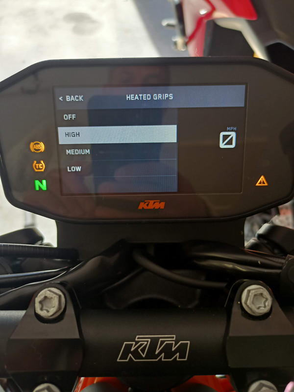

And Tada! - 30 mins or so after I opened the boxes we have lovely toasty grips, fully integrated into the dash
