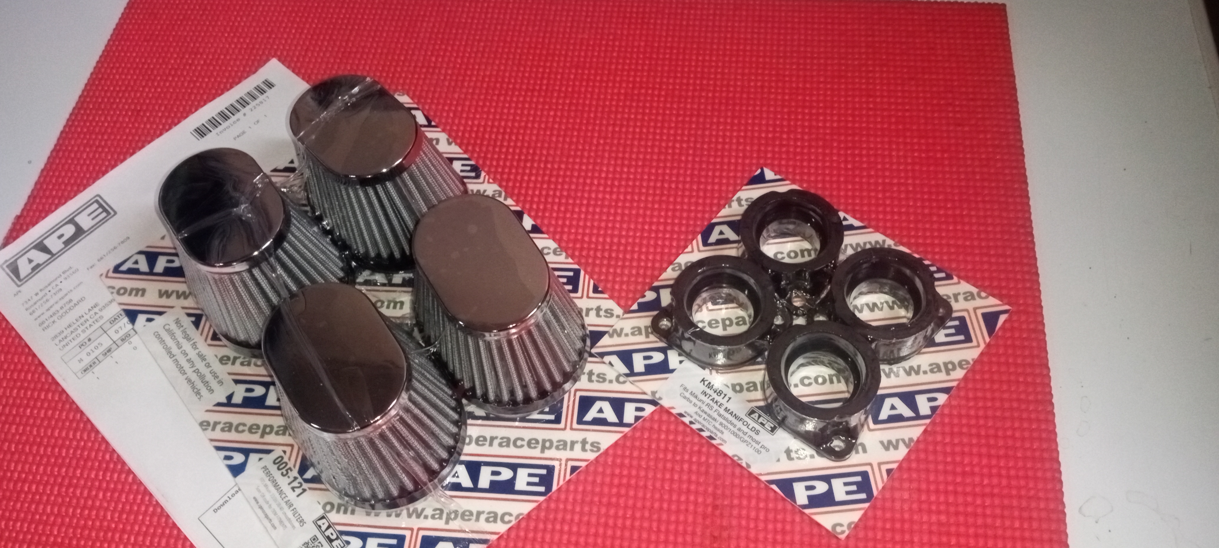

WooT!! Pods & manifolds, $145.

Now, choices..
Option one: Do I put the news pods on the GPz750...
Option two: Put them on the ZRX11 & take the ones on the ZRX11 & put them on the GPz750?
I'm tempted to put the new ones on the ZRX with the spiffy green filter oil I have, so extra green on the ZRX11 making it even faster...

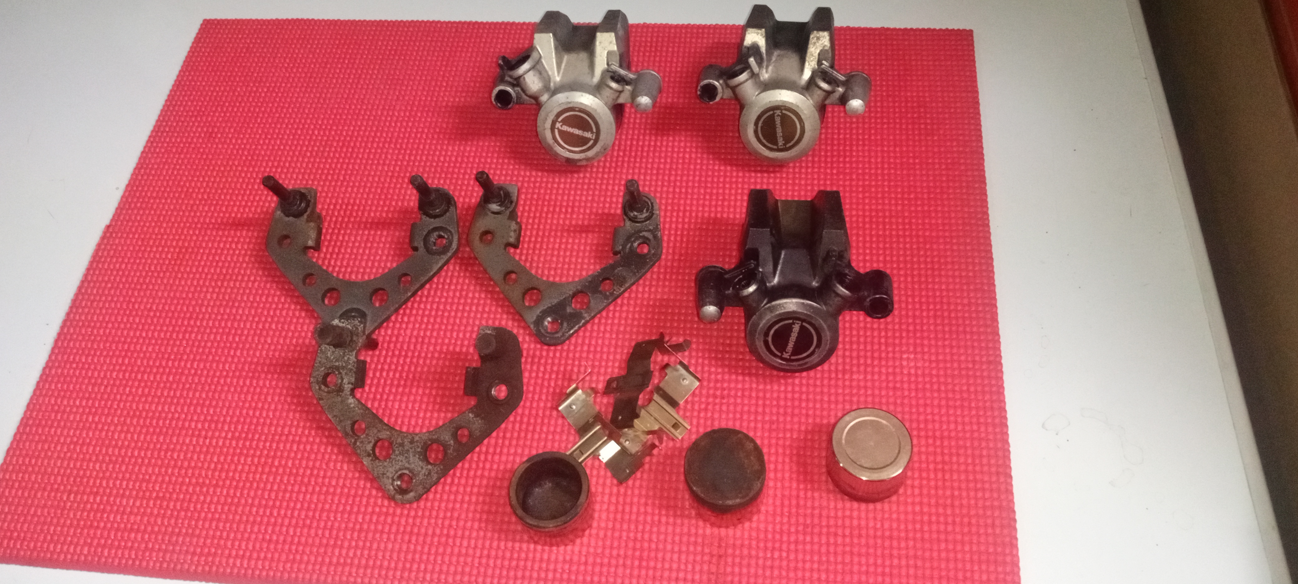

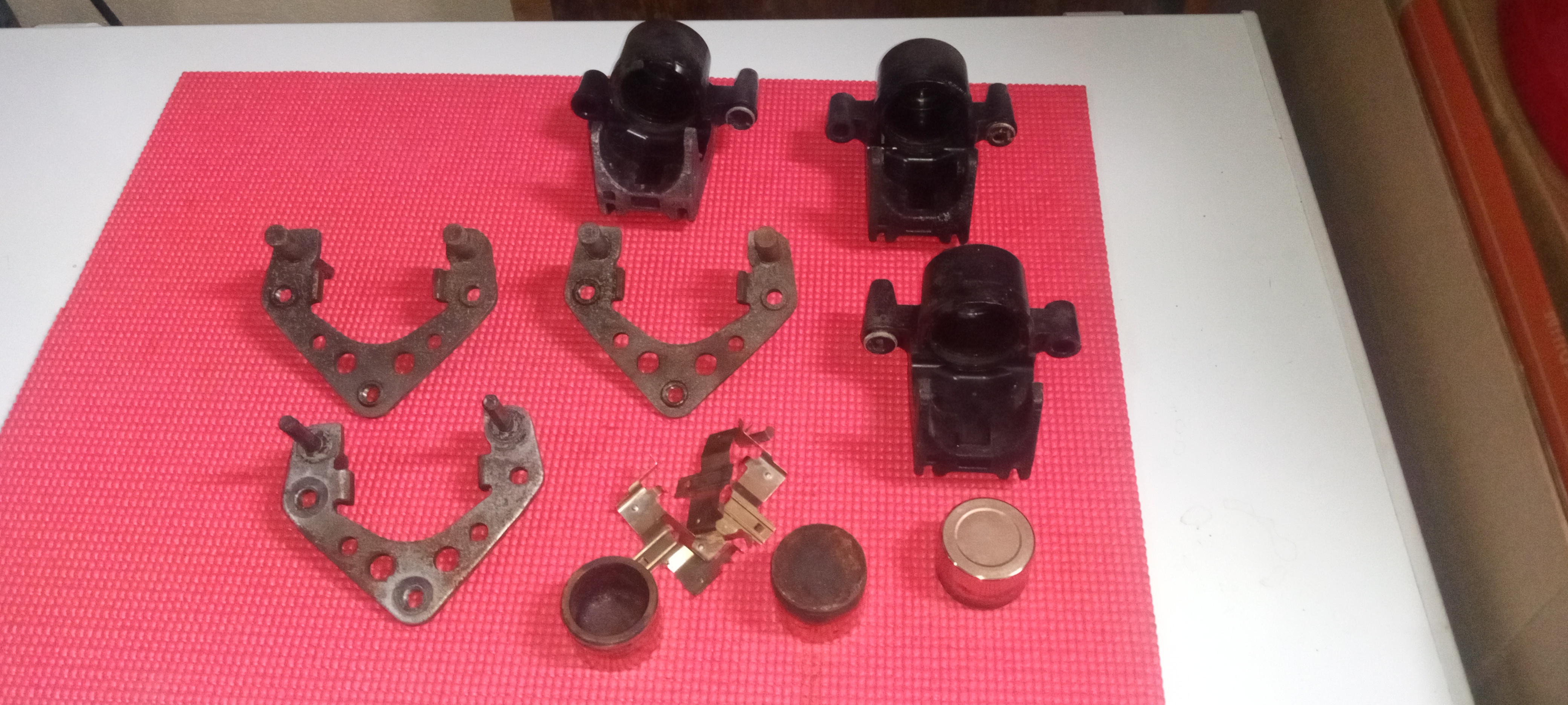

Dismantled three brake calipers (fronts & the rear are the same). Had previously ordered rebuild kits without the pistons.. however, I need the pistons...
Bugger.
Gonna order three new kits WITH the pistons (FFS).. & I guess I now own 3 rebuild kits for the '83 GPz11 which has the same brake calipers etc.
Calipers, mounts & other gubbins had three 30 min sessions in the ultrasonic. Calipers were originally anodized, but that's all faded to shit on the exposed surfaces (which is why the rear caliper is still dark). May paint them, or install as is...undecided.
bluergh... Can't understand why people reuse the same solution in ultrasonics for weeks, all that snarge on the bottom decreases the efficiency of the machine.. but they save maybe 10c on detergent, the cheap fucks.

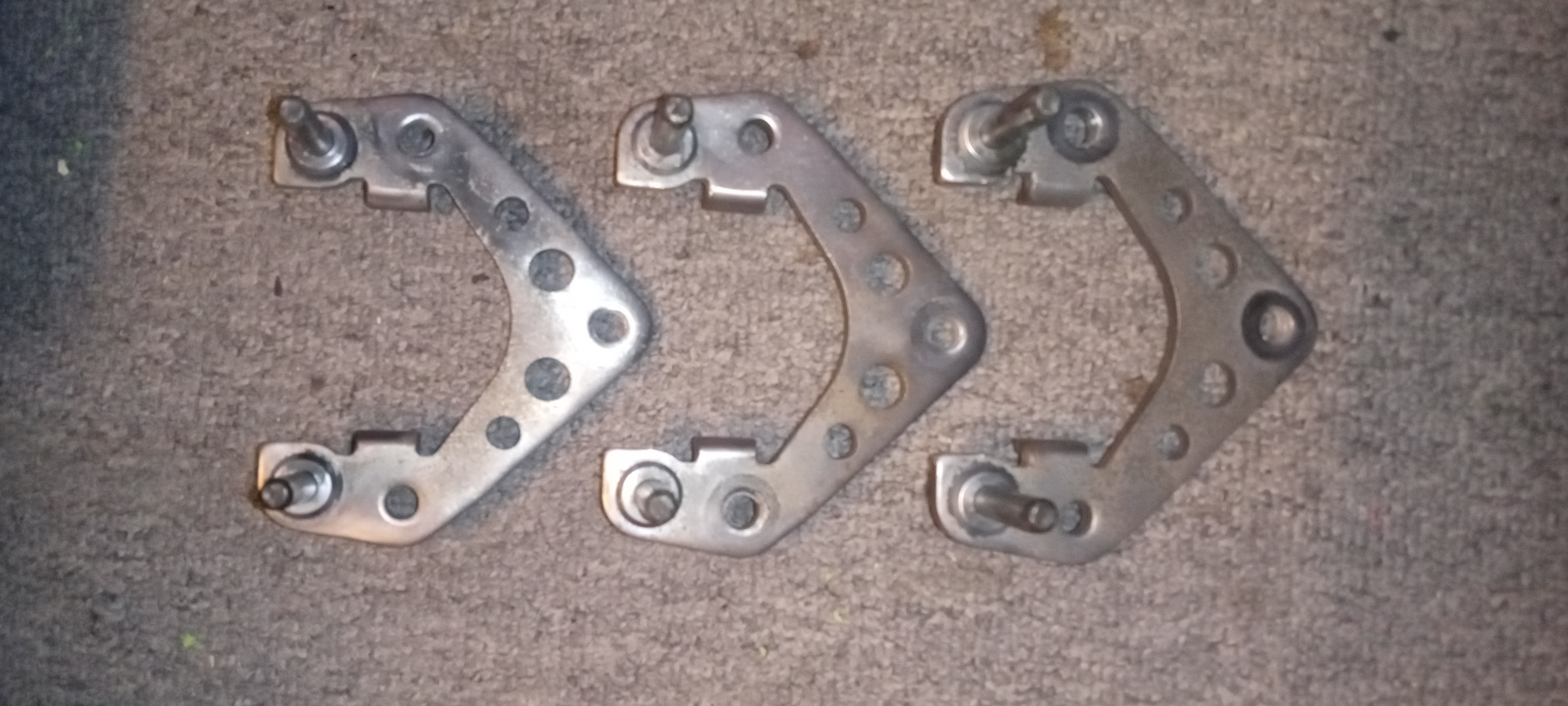

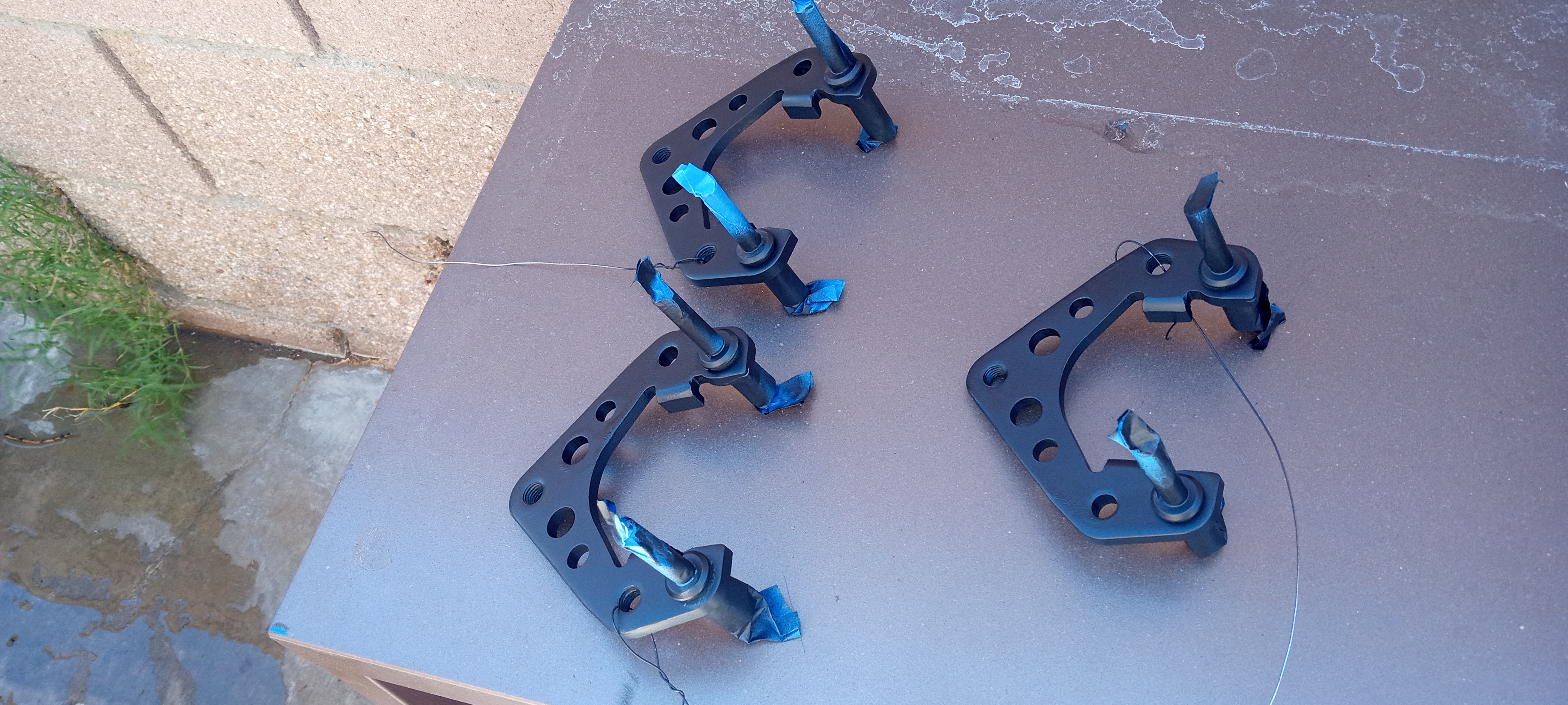

Cleaned up the caliper brackets & gave then a quick squirt of that Steel-It paint. In related news, that stuff matches the original finish on the GPz750/1100 rear brake levers. I hadn't noticed when I painted the lever off the GPz750, then I was working on the GPz11 last week & realized it's a perfect match.

Unmasked the brake brackets.

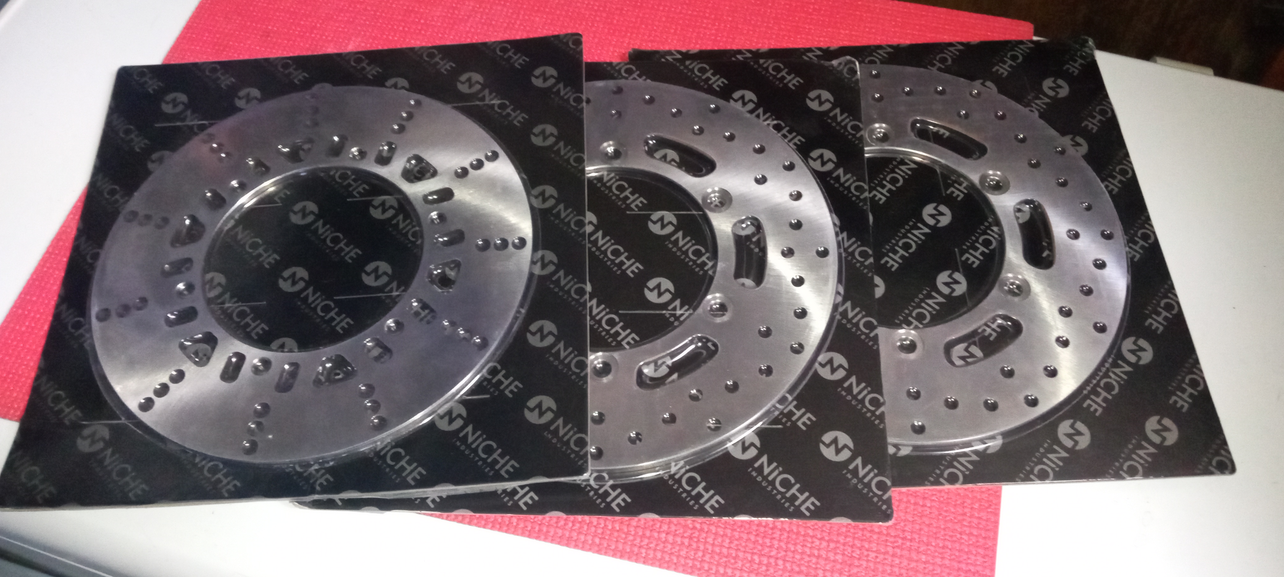

WooT! Other two rotors showed up

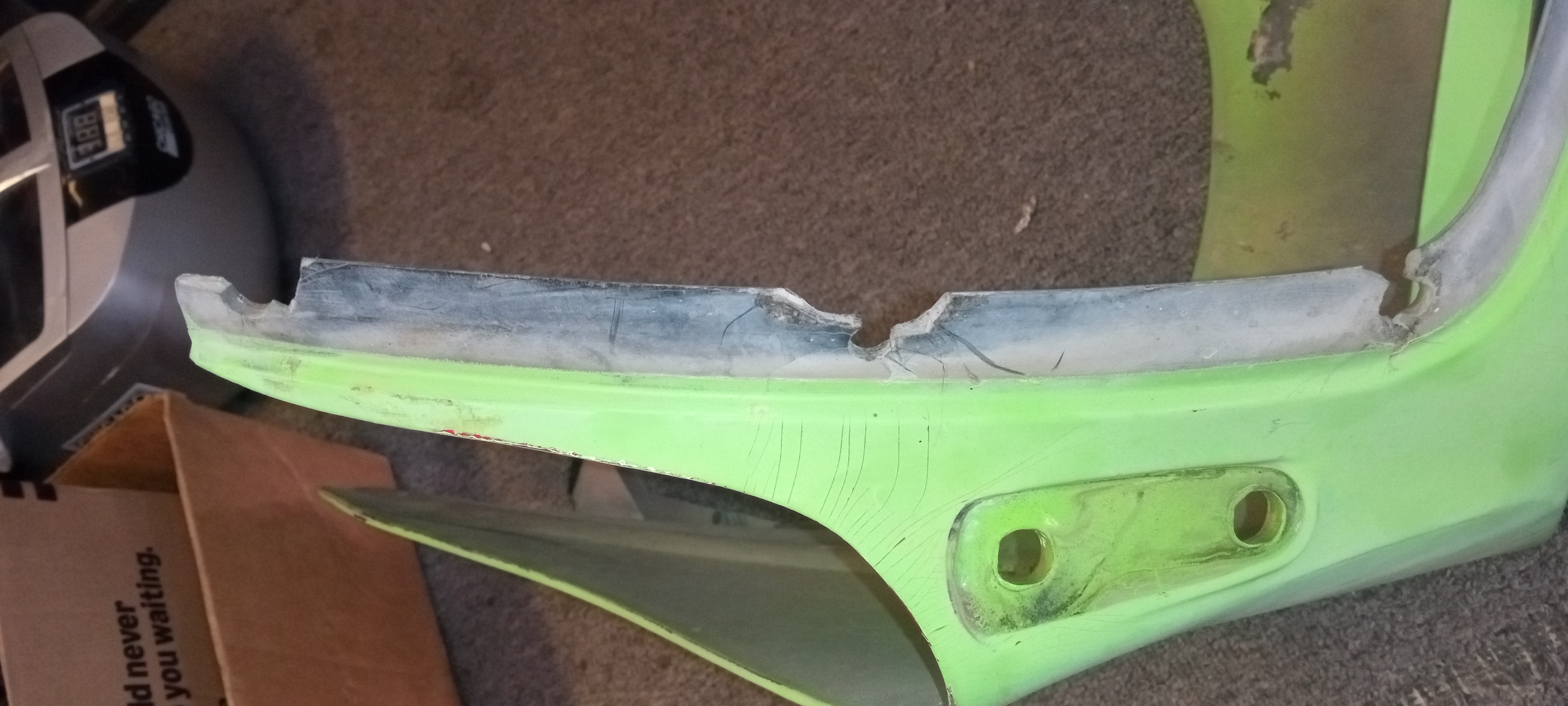

Fairing dismantled, hardware is in the Evaporust until tomorrow. Then after derusting it will go in the tumbler.
This is the damage I'm dealing with where the screen mounts...

Gonna try the baking powder/superglue method to start

Interesting, how does that work, useful to know? Cheers C

Exothermic reaction, gets really hot as it kicks off & emits methyl cyanide gas so don't snort the fumes.
