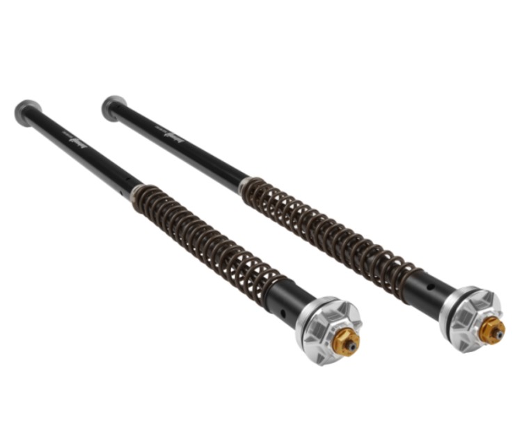

For the front I was toying with the idea of fitting a K-Tech SSK fork piston kit but whilst these are a cheaper upgrade at circa £200 they are not a DIY fitment so you have to pay for the labour charges at an approved fitting centre. I spoke with Brook Suspension for the best part of half an hour and decided to go with an Andreani Misano cartridge kit. At £571 it was only slightly more expensive than the K-Tech with fitting. One cartridge does rebound damping and the other does compression damping.
Andreani Misano Cartridges.jpg (32 KiB) Viewed 249 times

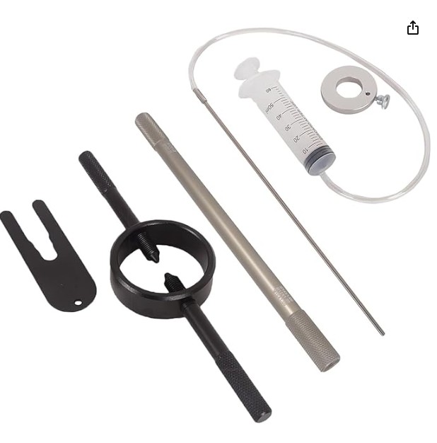

I was advised the job would be easier with some tools:
  • a syringe for setting the air gap - fill the fork leg with oil, set the rod to what the air gap should and suck out the excess, no need to mess around with a ruler.
    a damper rod bleed tool - this screws on to the top of the damper rod so that you can extend/compress it until it's filled with fork oil. You can use a pair of pliers instead but this works better and makes the job quicker and cleaner.
    Spring compressor tool - this collar fits around the fork leg with a 'finger' on each side to hold the fork spacer allowing you to put pressure on the spring and accessing the lock nut securing the fork top in place. In theory it's supposed to allow one-man operation but I wasn't working alone (thanks @maccecht)

The Misano cartridge is pretty much a straight replacement for whatever's in the fork leg and fitting is therefore quite straightforward, the only real problem being the threaded inserts at the bottom of the cartridge are an M10 x 1.25 pitch whereas the bolt from my fork leg is an M8 x 1.25. Brook Suspension sent out the correct insert quickly and FOC. Swapping the insert on the rebound cartridge was easy enough because you could get a screwdriver through the cartridge so as to hold the cartridge in place. The compression cartridge was slightly more difficult because you could use the screwdriver method. Instead some heat was needed to break the blue thread lock on the insert.
The instructions from Andreani aren't the best either but that didn't hinder progress.
Both the shock and front springs are weight-appropriate. The difference with both fitted is quite literally night and day. I'm not riding any quicker and I still don't really know what the suspension is doing but the bike feels more stable, more confidence inspiring particularly in corners with the bike holding its line better, more comfortable over rougher surfaces.
