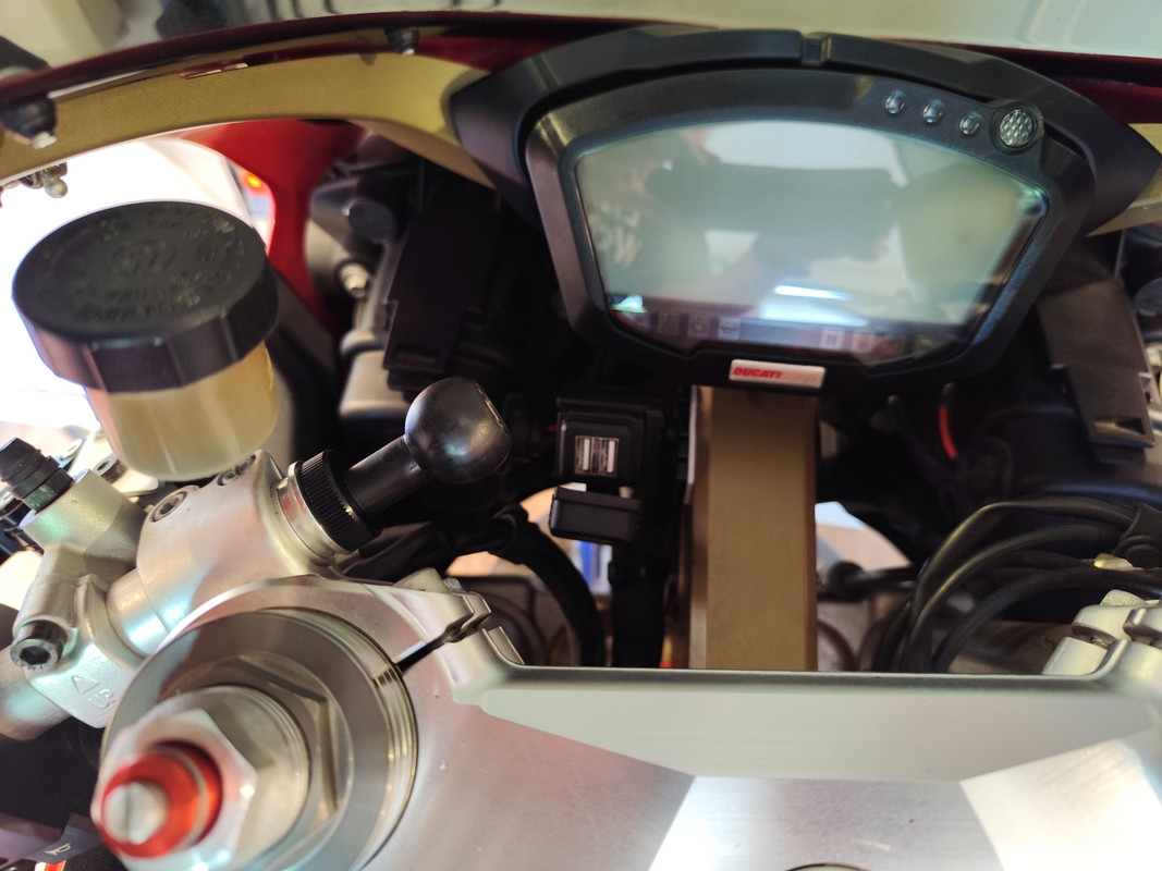

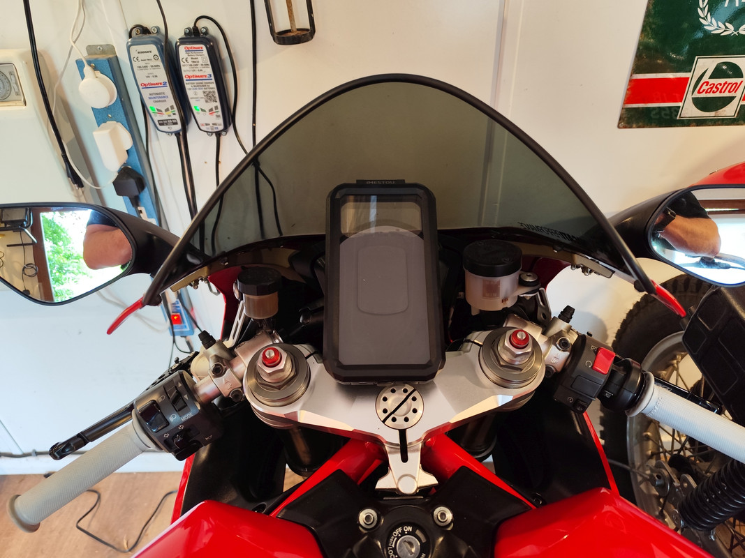

Htf are you supposed to see the clocks?derek badger wrote: Fri Jun 06, 2025 3:59 pm New grips fitted, Ram mount for phone holder and fused USB sockets wired in.
- derek badger
- Posts: 1184
- Location: Surrey Hills
- Has thanked: 1091 times
- Been thanked: 1759 times
Re: NBD: Ducati 848
Digital dash and it doesn't show much at all. Google maps has a speed built in and there's a shift light on the top of the dash.Rockburner wrote: Fri Jun 06, 2025 4:29 pmHtf are you supposed to see the clocks?derek badger wrote: Fri Jun 06, 2025 3:59 pm New grips fitted, Ram mount for phone holder and fused USB sockets wired in.

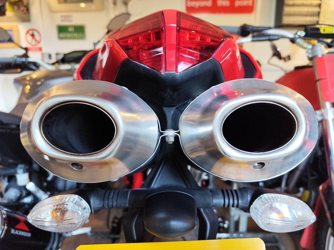

Did a sedate 30 miles today, decided I might remove the baffles again as it sounded a bit sewing machine compared to a couple of other bikes at Newlands Corner.

Removing the baffles from the Termis was the right decision; it's loud, but not too offensive, and very similar to my old 900SS.

You're right about those mirrors. All I can see is your elbow.

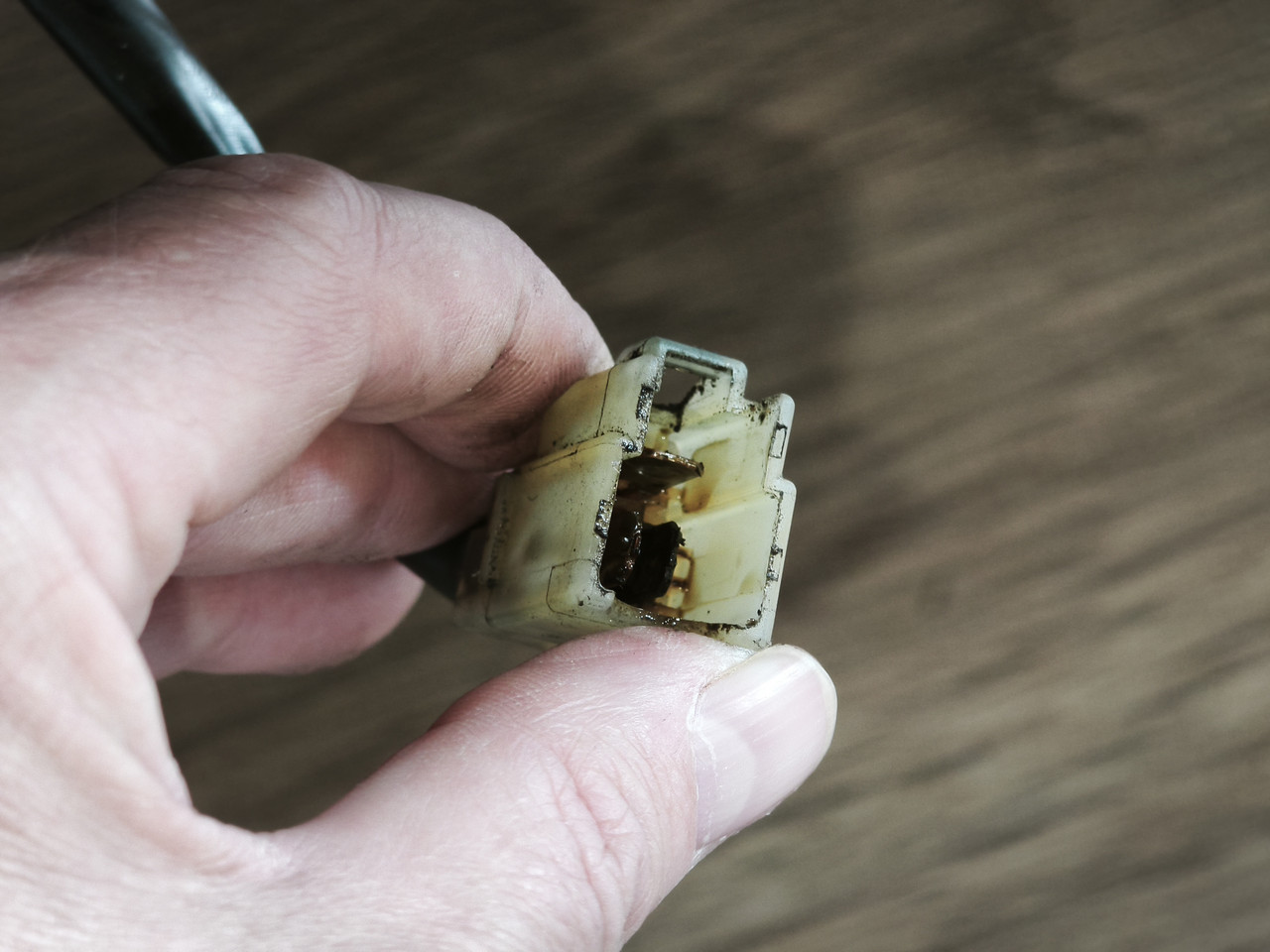

So the last two rides the headlight and dash back light have flicked on and off occasionally. A quick Google points to the R/R being the likely culprit so I've just whipped the side panel off to have a look. Bleauuurgh...
I'll be picking up some replacement connectors at Kempton and splicing in some fresh wire.
