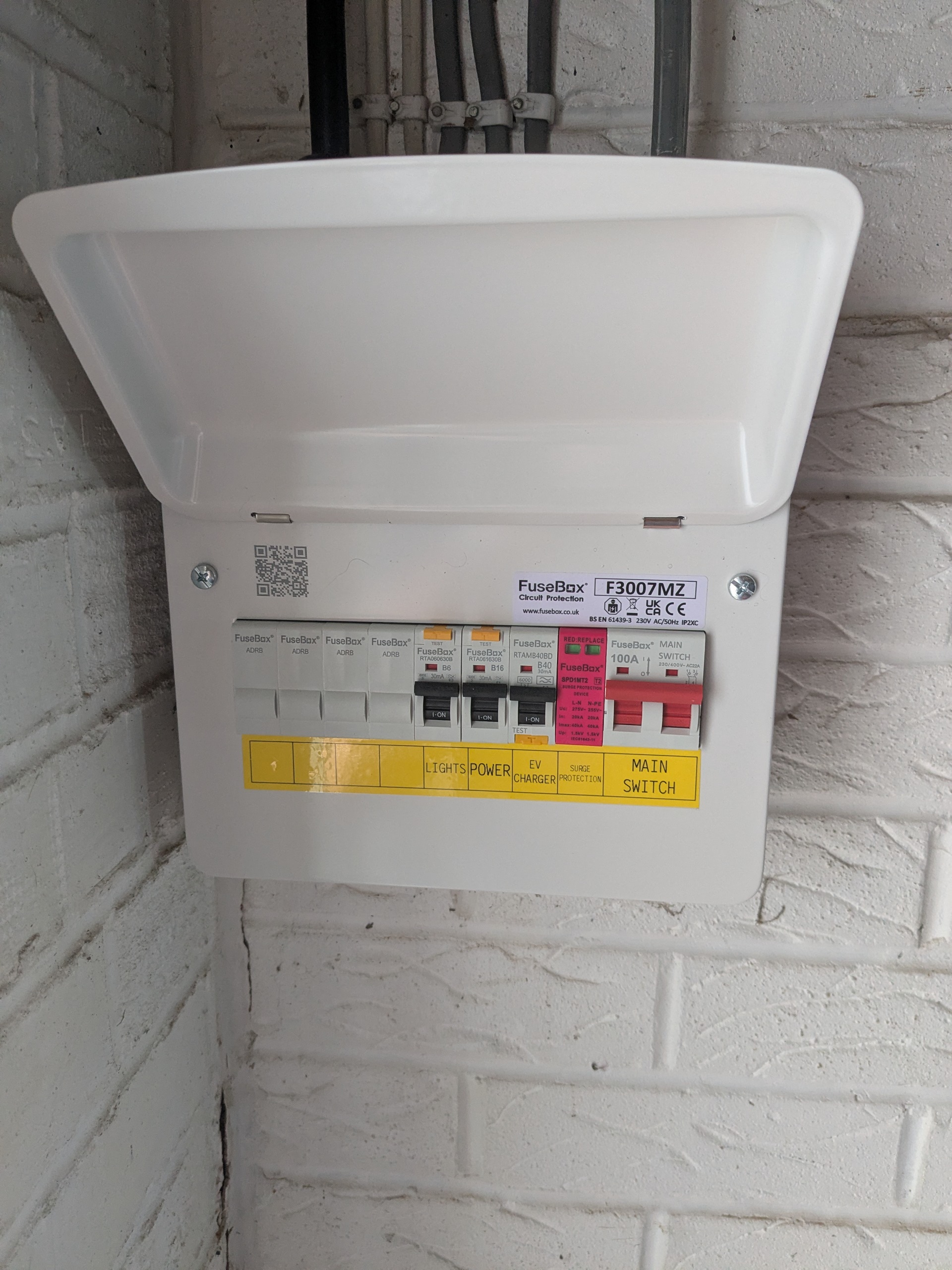

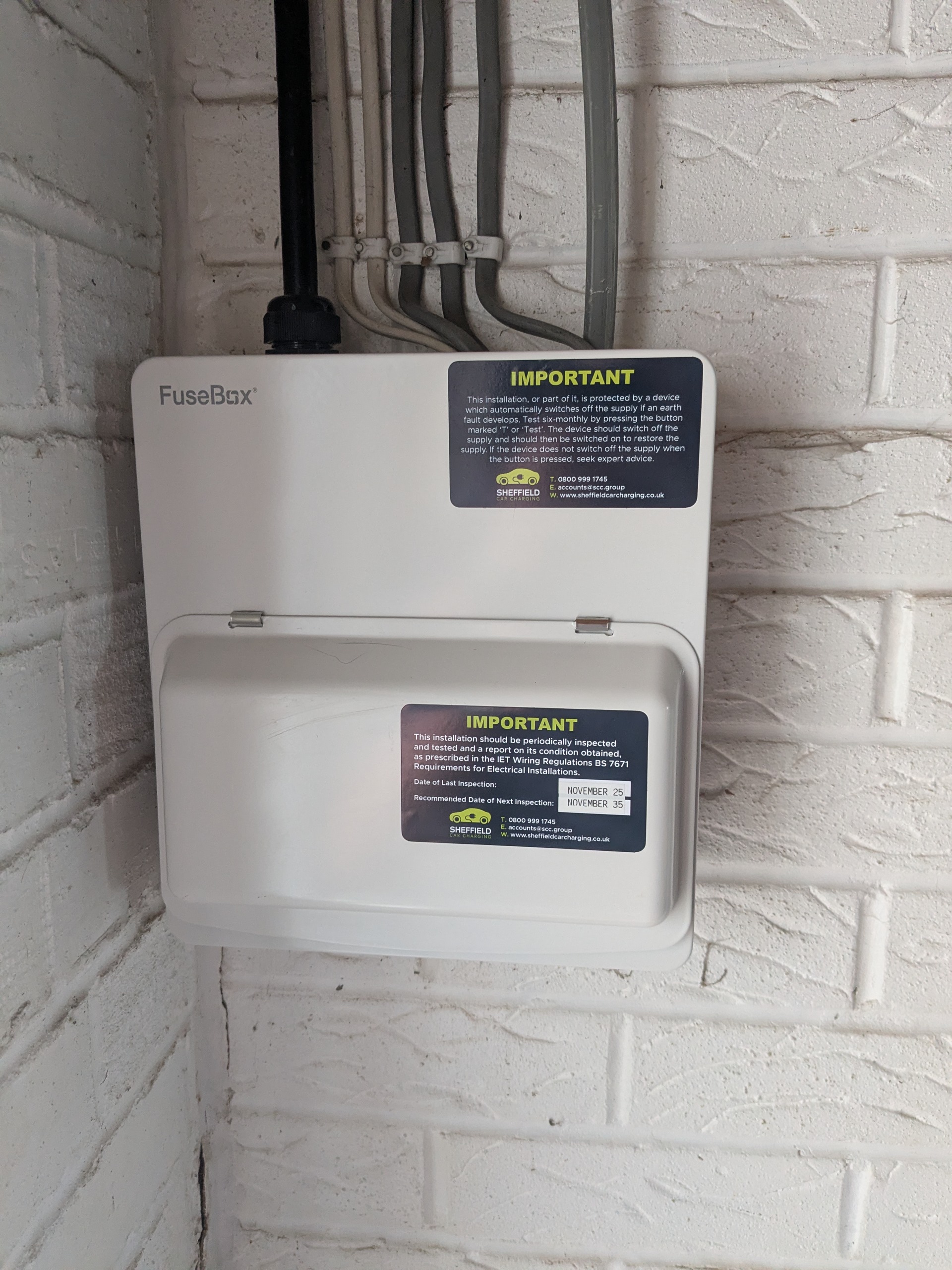

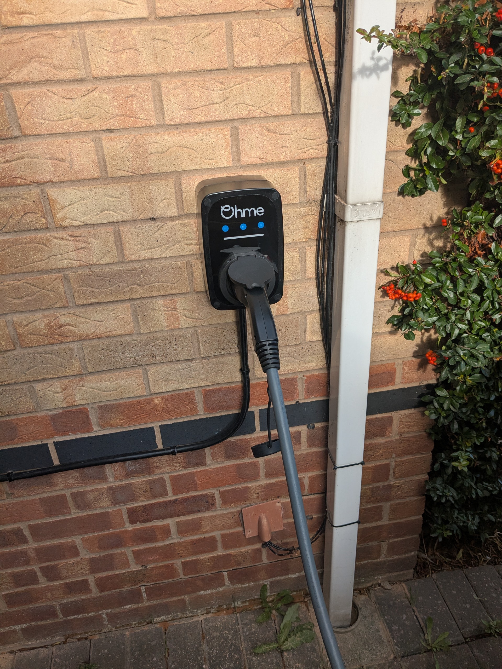

So rightly or wrongly I've had my charger/fuse box done today.
The bloke was lovely, a proper nice fella, all the work looks neat and I'm very happy.
The car charges at the full 7kwh fine and nothing seems to be on fire.
I'm not going to use the charger much as it's free at work, but it's a nice to have just in case.

You did say the feed to the consumer unit is on a 32A mcb from the house and on the RCD side too ? The car charger is on a 40A so that’s against the regs as there’s no discrimination, if the car charger overloads it won’t trip the 40A first it’ll trip the 32A in the house. There’s also the issue of the house RCD which will be a type AC and these can be blinded by a car charger in fault so aren’t recommended to feed them.
If the car charger is on drawing 32A and you plug anything of load into the socket you’ll also run the risk of overloading the 32A and the cable feeding the CU.
I’d def be asking questions of the installer here mate.
