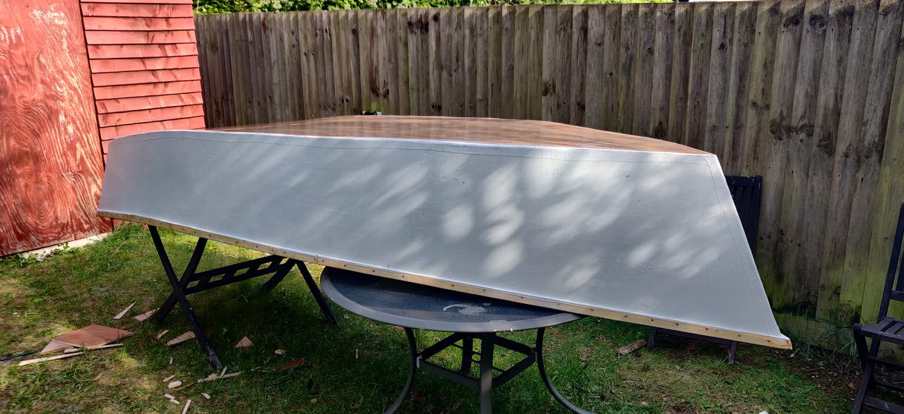

I was going through old threads and realised I never completed the saga of my boat build, so just in case any of you were watching it at the time, here is the ending!
Got it finished, coated in epoxy and then painted

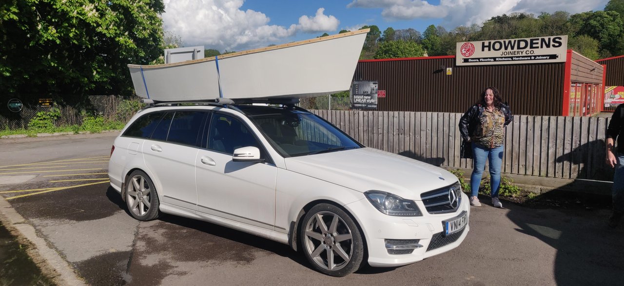

heaved it on top of the car, strapped it down, and headed down to our local canal with a couple of mates

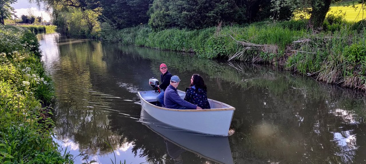

Popped in Ito the water, checked for leaks (it didn't, luckily!) and went for a row about for a bit. It was easy to propel with oars, but lacked directional stability as these isn't any keel, so I stuck the outboard on the back, much better!
We spent a happy afternoon messing about on the water, then took it back home and put it back in the garden.
