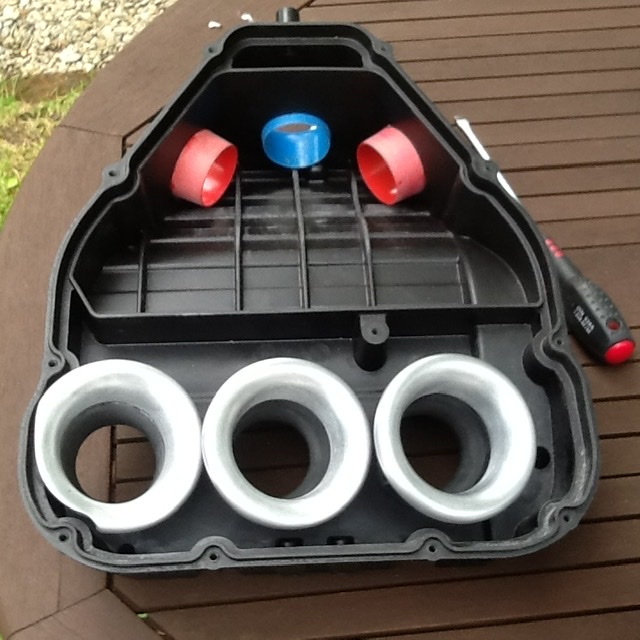

Pah! My cunningly modified 1050 speed triple air box, an afternoon on the dyno saw it making just about the same horsepower as a bog standard one🙄
Kept me amused for an afternoon though, and it did sound nice😂
Kept me amused for an afternoon though, and it did sound nice😂6C61E80E-CF7E-4F5B-9F4A-B8C6DBCA2545.jpeg6EC423F9-4746-4ED0-8775-D72BF47AD831.jpeg
Looks like one of the spaceships in The Night Garden. Is it the new Ninky Nonk.

Yebbut, it's a static device ie no moving parts apart from the air so I wondered how, for example, you could look at Singlesman's airbox and work out why it was worse than standard and how it could be improved? How do you get, what is effectively a box and a few tubes, to behave linearly or otherwise across the range of flows, guessing that there's more to it than trial and error. Just intrigued 'cos at first sight it seems like voodoo. :D
Edit: From what Fromage says above they may not all be static.
