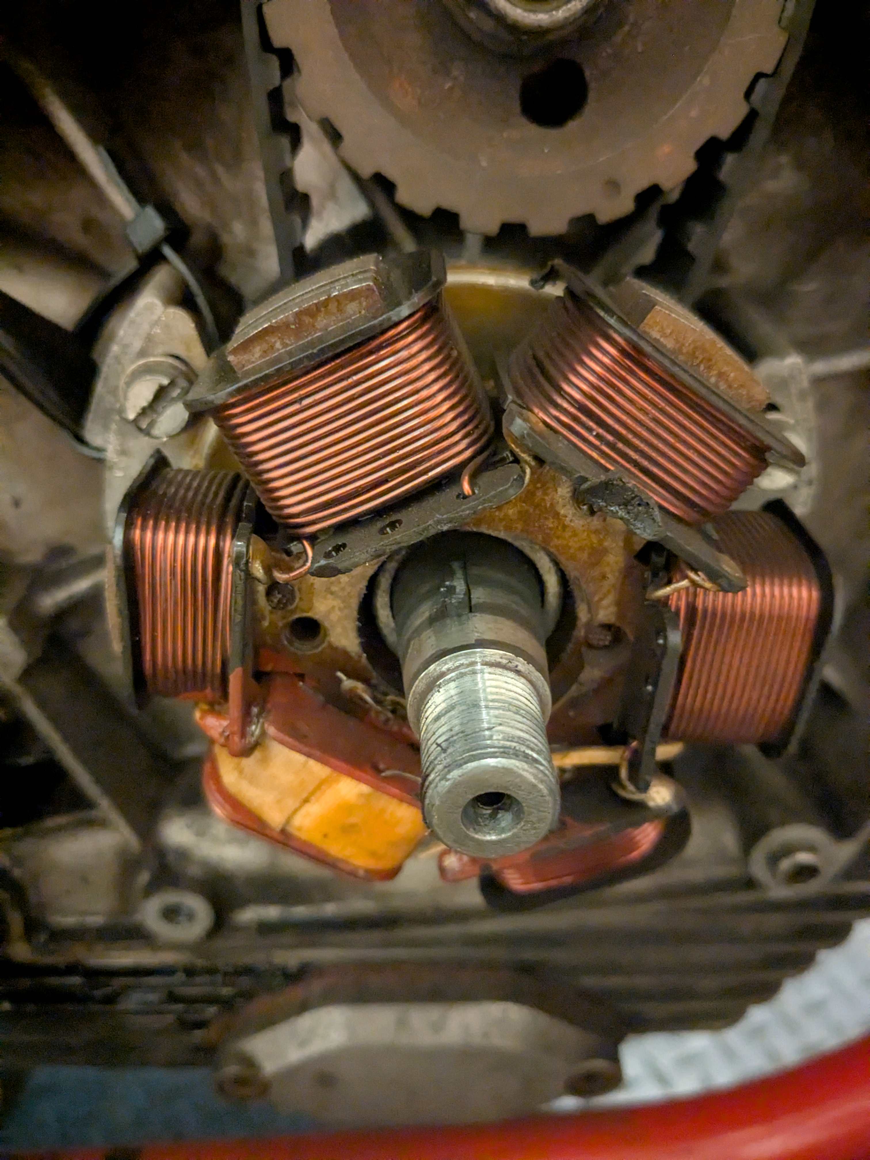

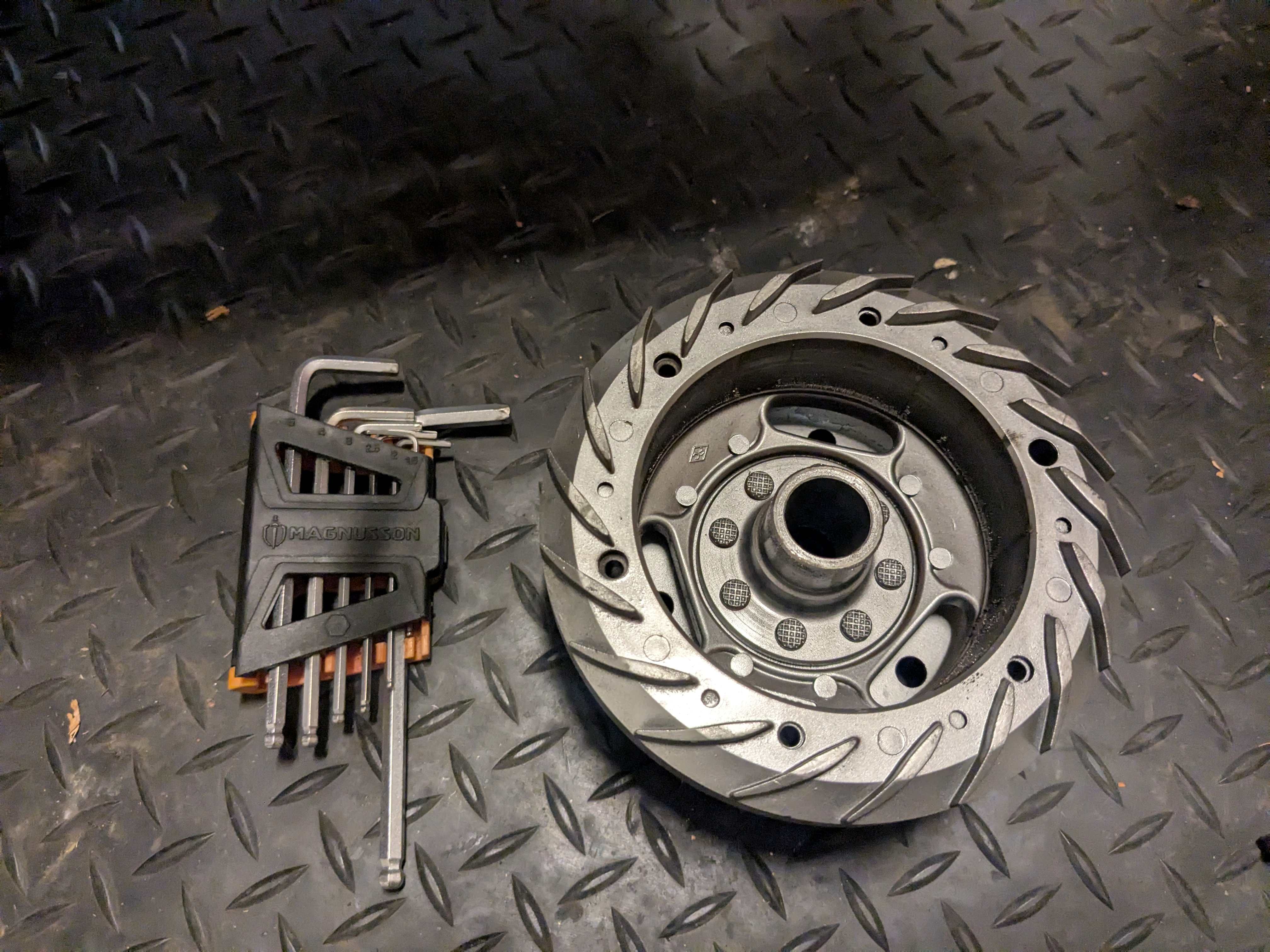

At last had a chance to get the spanners out, luckily it looks like a pretty easy fix, the magnetic rotor had come loose & sheered off the woodruff(?) key, just need to find out what size key is required & if any special tools are required to hold in place whilst I torque it back on, fingers crossed I'll be able to sort it our this weekend.

Just have to hope the key channel isn't chewed up. Woodruff keys were the bane of my life. Well, one particular key was, once. :lol:
(It sheared, as they're supposed to in certain situations I imagine. What wasn't supposed to happen was it chewed the edges of the slot when it did. :( I suspect the flywheel had loosened on the taper which was what, ultimately, led to the failure and the damage).

Apparently I need to be meticulous with the fitting of the taper mating surfaces to make sure it all stays in place, a bit of fine valve paste and spinny spinny for a while should do the trick.
