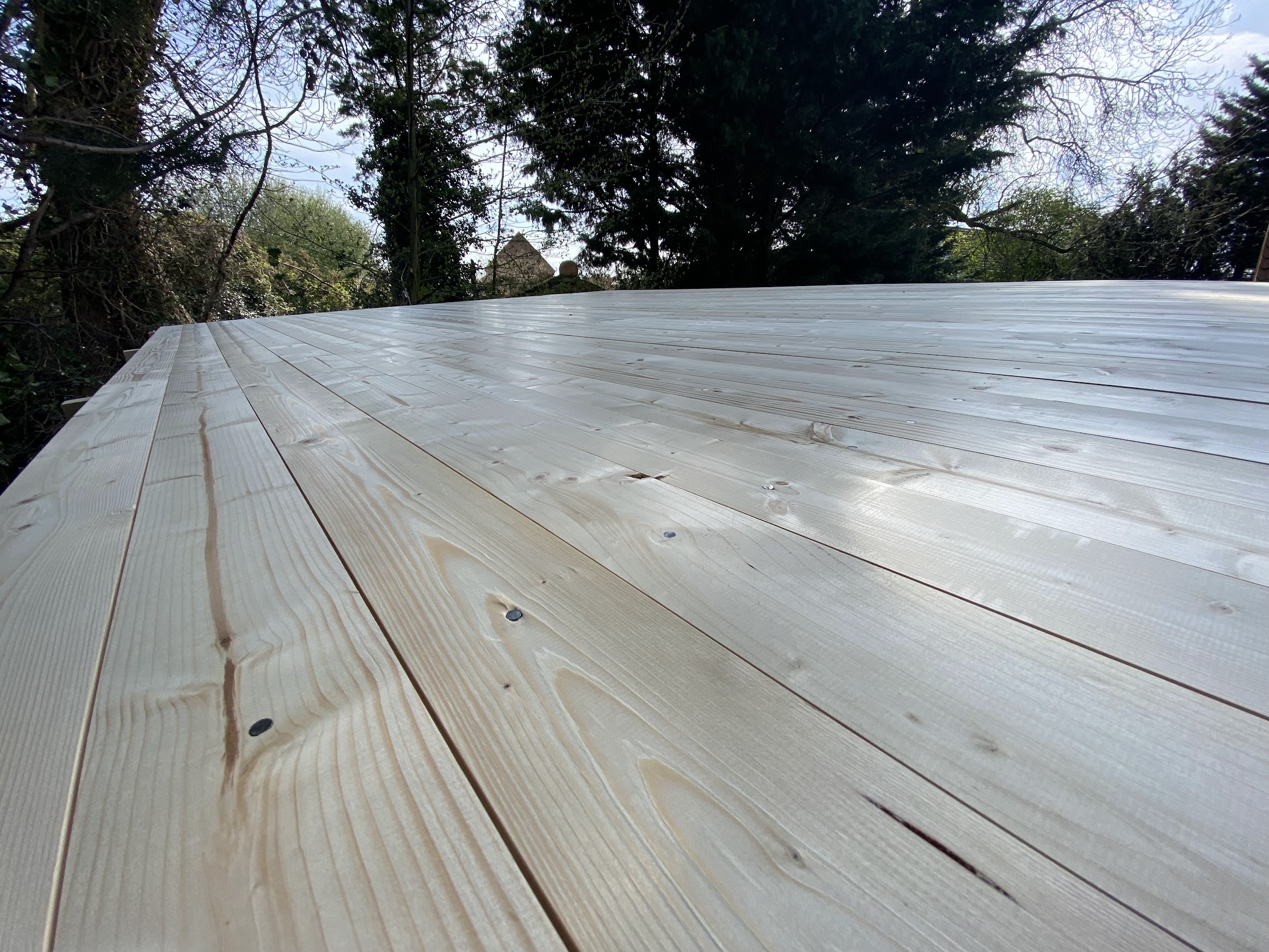

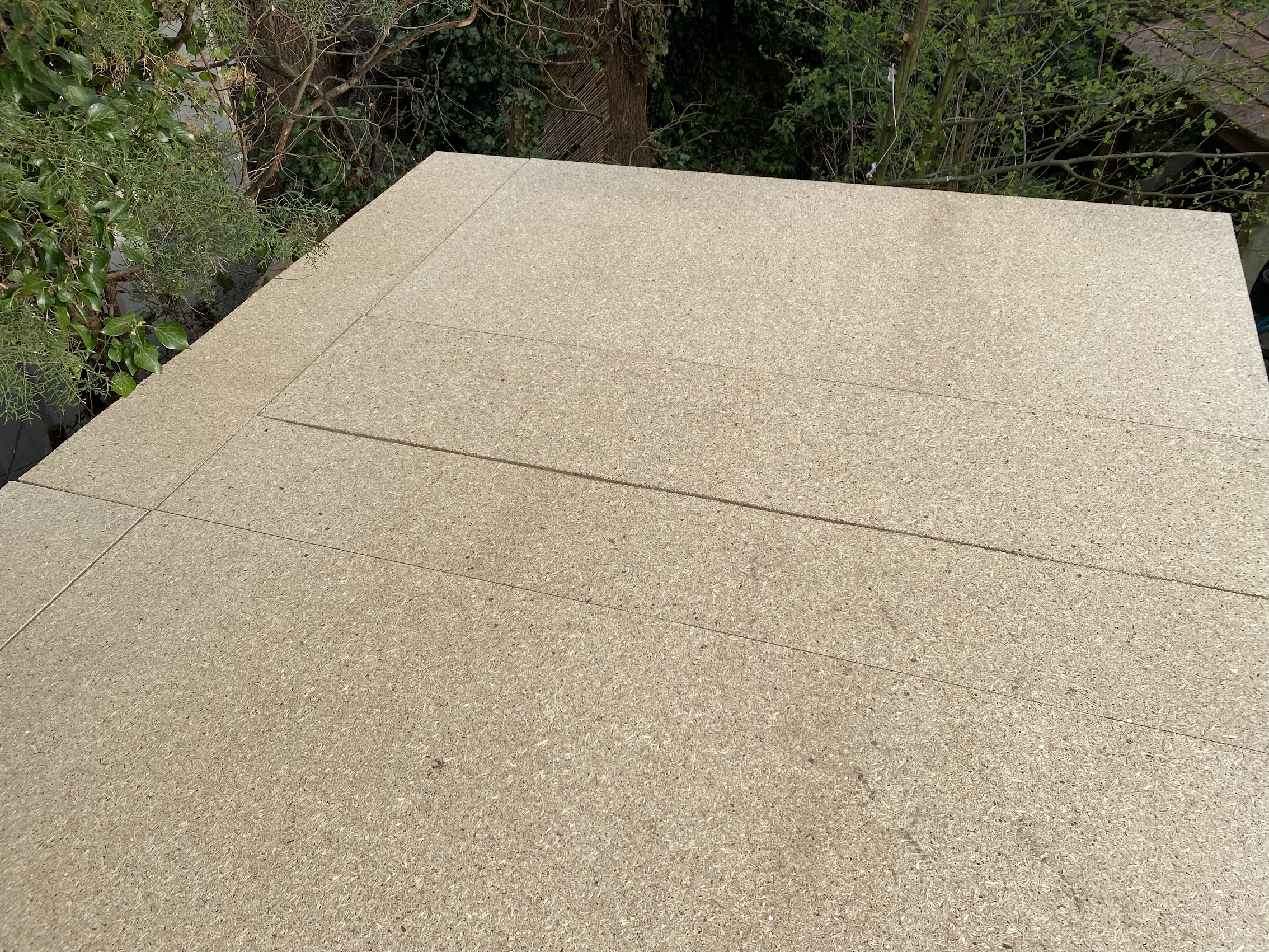

First part of the roof is the pine planking that makes it look nice inside...
...next is sheets of chipboard glued to 25mm of insulation...
...and the finally is a membrane topped with roofing felt...

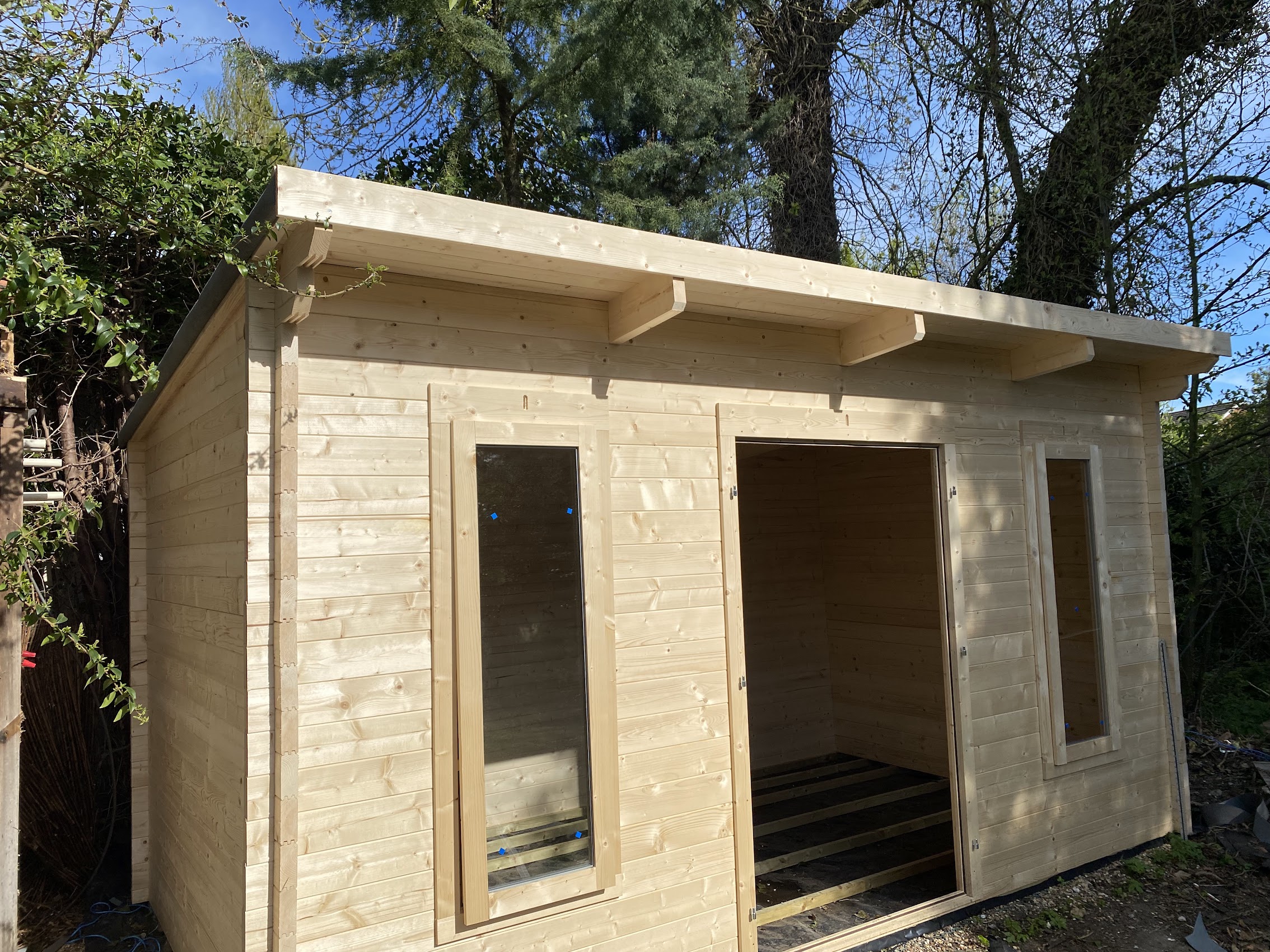

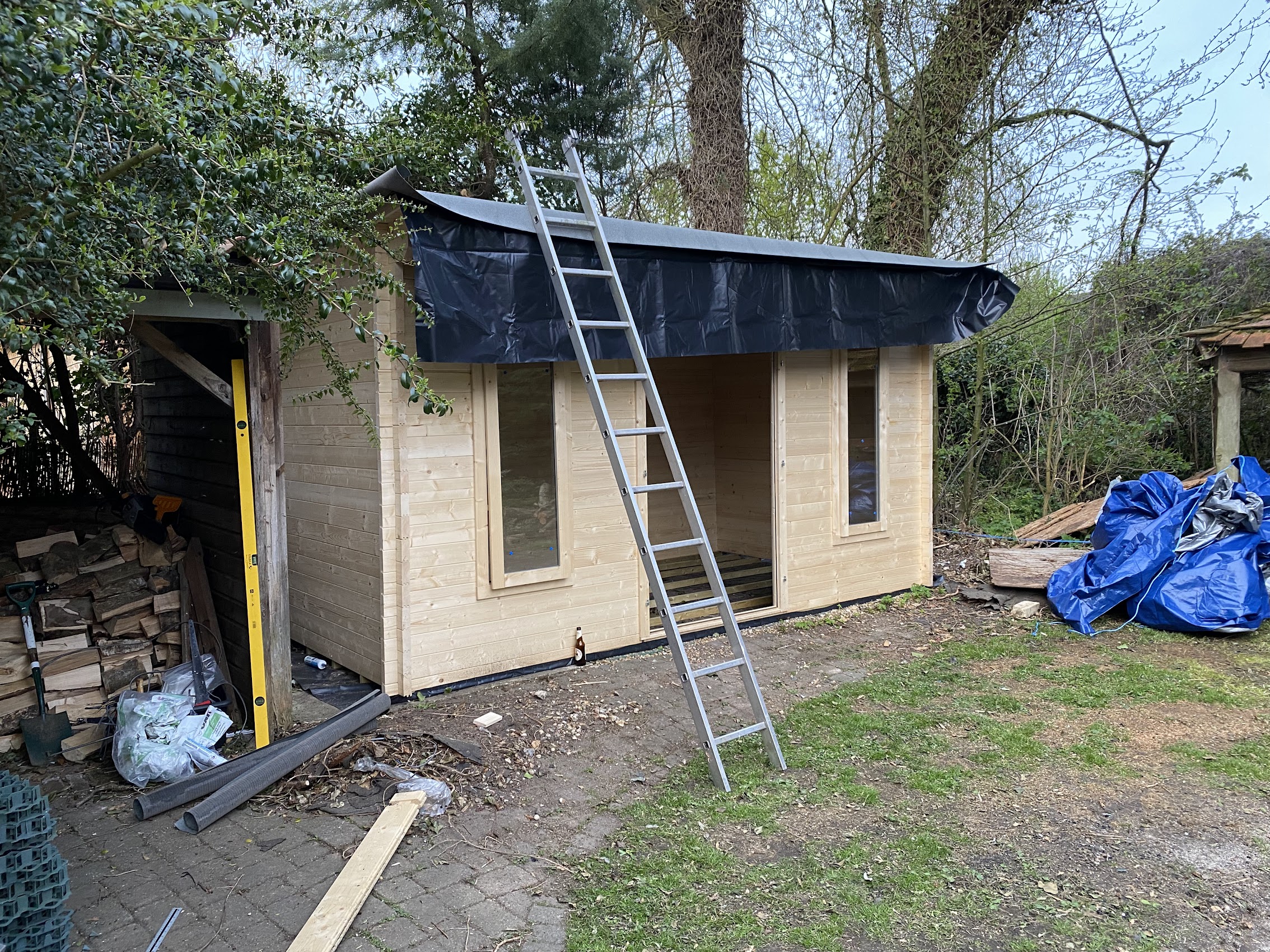

Which results in this...
...which you then trim to give this...

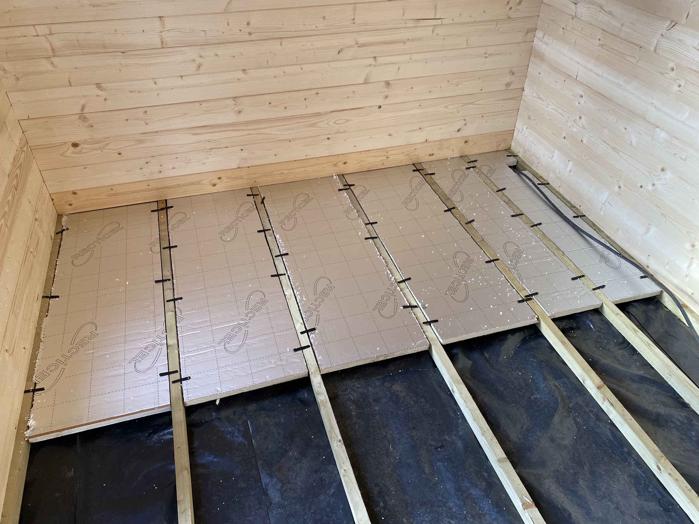

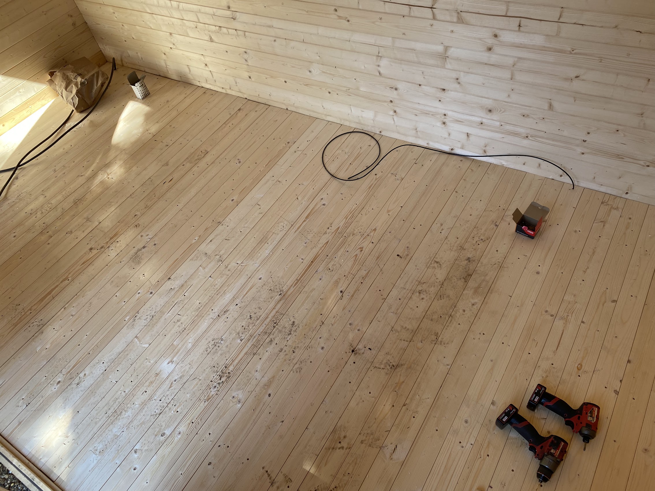

The floor is 25mm insulation sheets suspended on clips and the topped with pine planks...

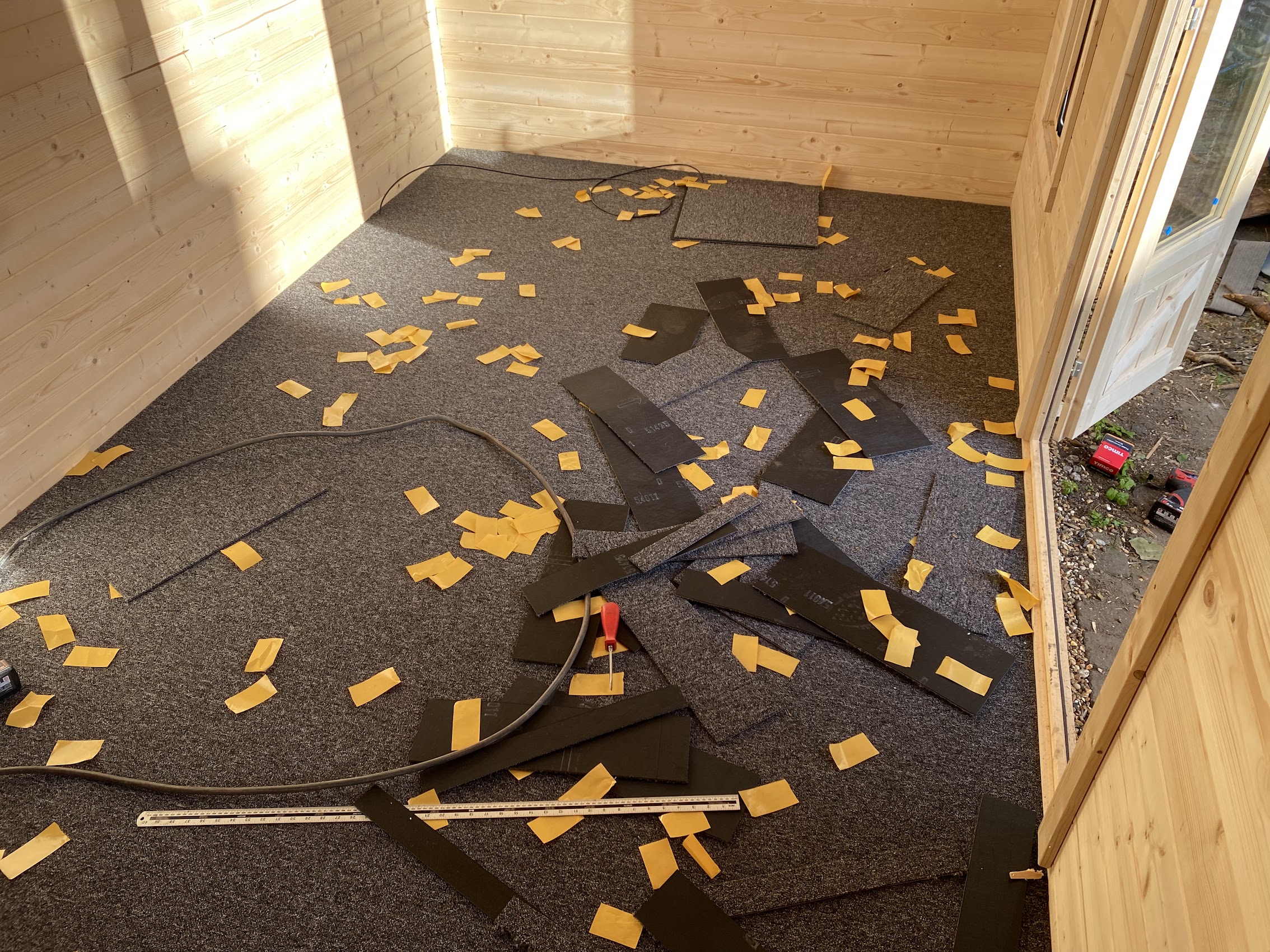

Finally carpet tiles rated for wheeled office chairs installed...
Next job is some trim around the carpet edges and finish painting the outside and it's done. Just need to get the electrician in to install the consumer unit and sockets.
Posts: 15914
Has thanked: 8048 times
Been thanked: 5698 times
Re: New Shed/Workshop(ish)
dern wrote: Sun Apr 20, 2025 9:39 pm Finally carpet tiles rated for wheeled office chairs installed...
You'll have job on sorting those Post-it notes! :lol:

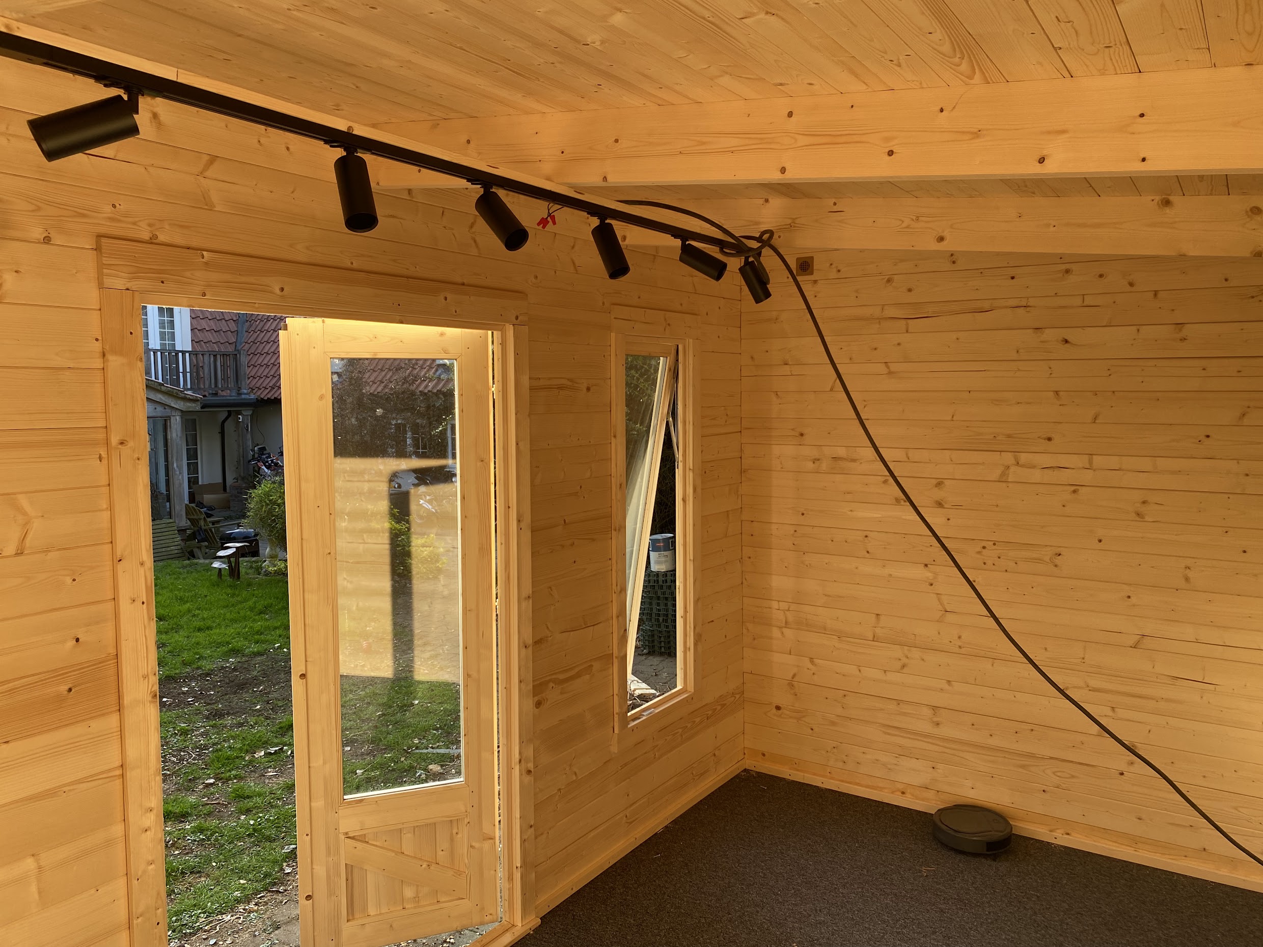

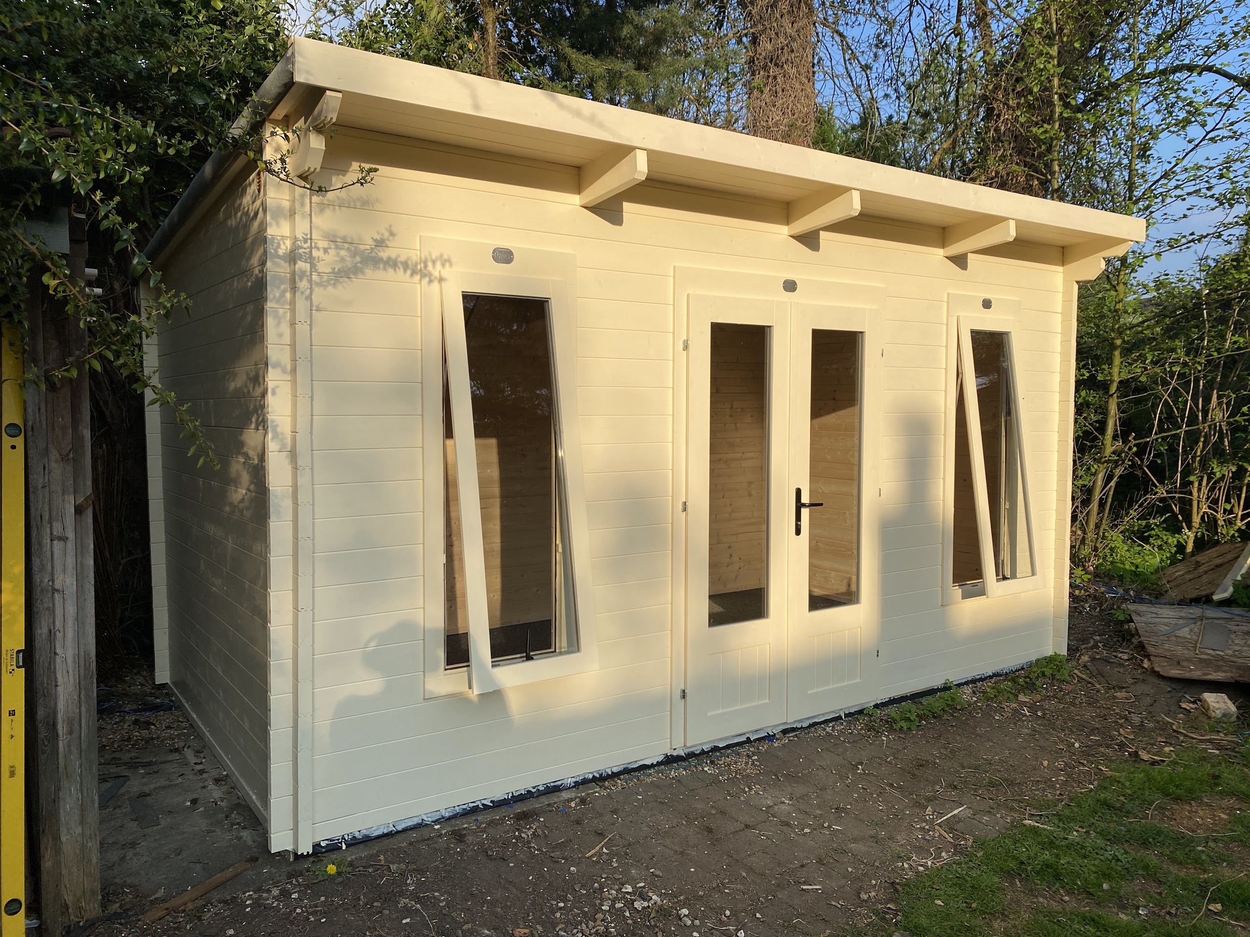

Finally (just about) finished. Need to run the ethernet cable to the house, get the electrician to add power and find something to trim the front bottom edge.
Posts: 15914
dern wrote: Sun Apr 27, 2025 9:51 pm Finally (just about) finished. Need to run the ethernet cable to the house, get the electrician to add power and find something to trim the front bottom edge.
The base on mine is trimmed with decking boards but you'll need a v long, straight cut for that one! (It's low maintenance, weathers well and contrasts with the shed colour. The base on mine is quite deep, particularly at the back because of the slope).
I had those lighting-rail spots installed but had to put daylight lamps on all the work/reading areas. The spots look ok and are easy to install but I never got an even spread of light or got them exactly adjusted for all eventualities. In hindsight I'd have gone LED 'tube' lights and, maybe, uplighters. (Same issue, only worse, in our kitchen. Previous bloke put 8 spots on two lighting bars. If you're working facing a wall you're always standing in your own light shading what you're doing. I put LED 'tubes' under all the cupboards to illuminate the peripheral work surfaces).
dern
Posts: 2540
Has thanked: 1187 times
Been thanked: 2281 times
Post by dern »
Count Steer wrote: Mon Apr 28, 2025 8:16 am
In the last office I put the same led strips above my desk with uplighters. I though I'd give this a go on a dimmer circuit to provide general lighting but will install the led lights as well as otherwise the desks will be in my own shadow with the lights behind me.
Our kitchen is exactly the same, all the work surfaces and the island are all in shadow. Need to sort that out before I lose a finger.
I think that I'm going to use some pressure treated wood across the bottom. I like the idea of the decking board but that long cut would be a major pain.
