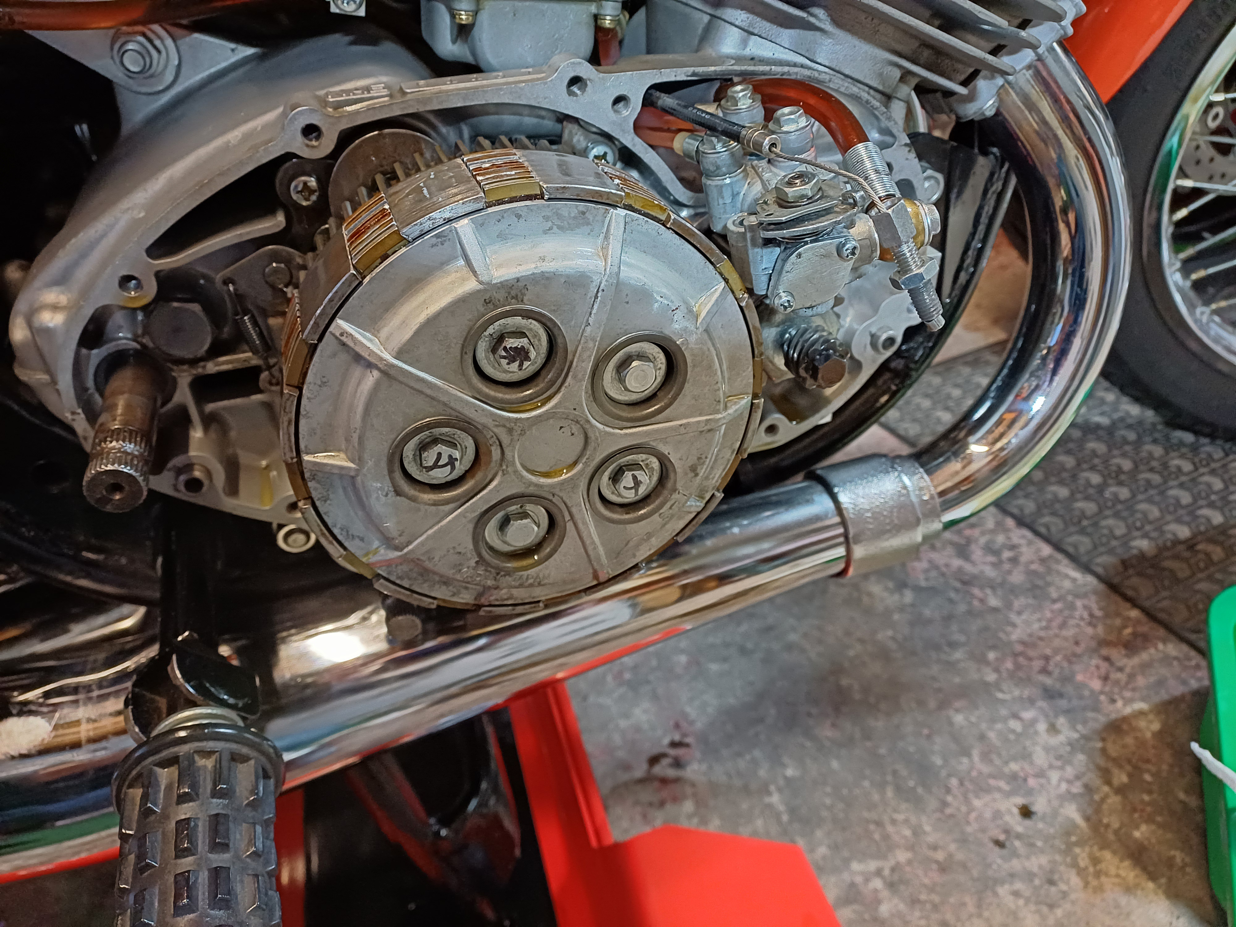

I finally got around to pulling off the right side crankcase cover to see why the clutch was slipping at high revs.
I managed to remove the cover without disassembling the oil pump and those very delicate 52 y/o fine threads. They are well known to need helicoiled at the drop of a hat. I had a new gasket for under the oil pump body. The oil pump cable removal was the biggest faff,not much room in there to get at the cable adjusting screw.

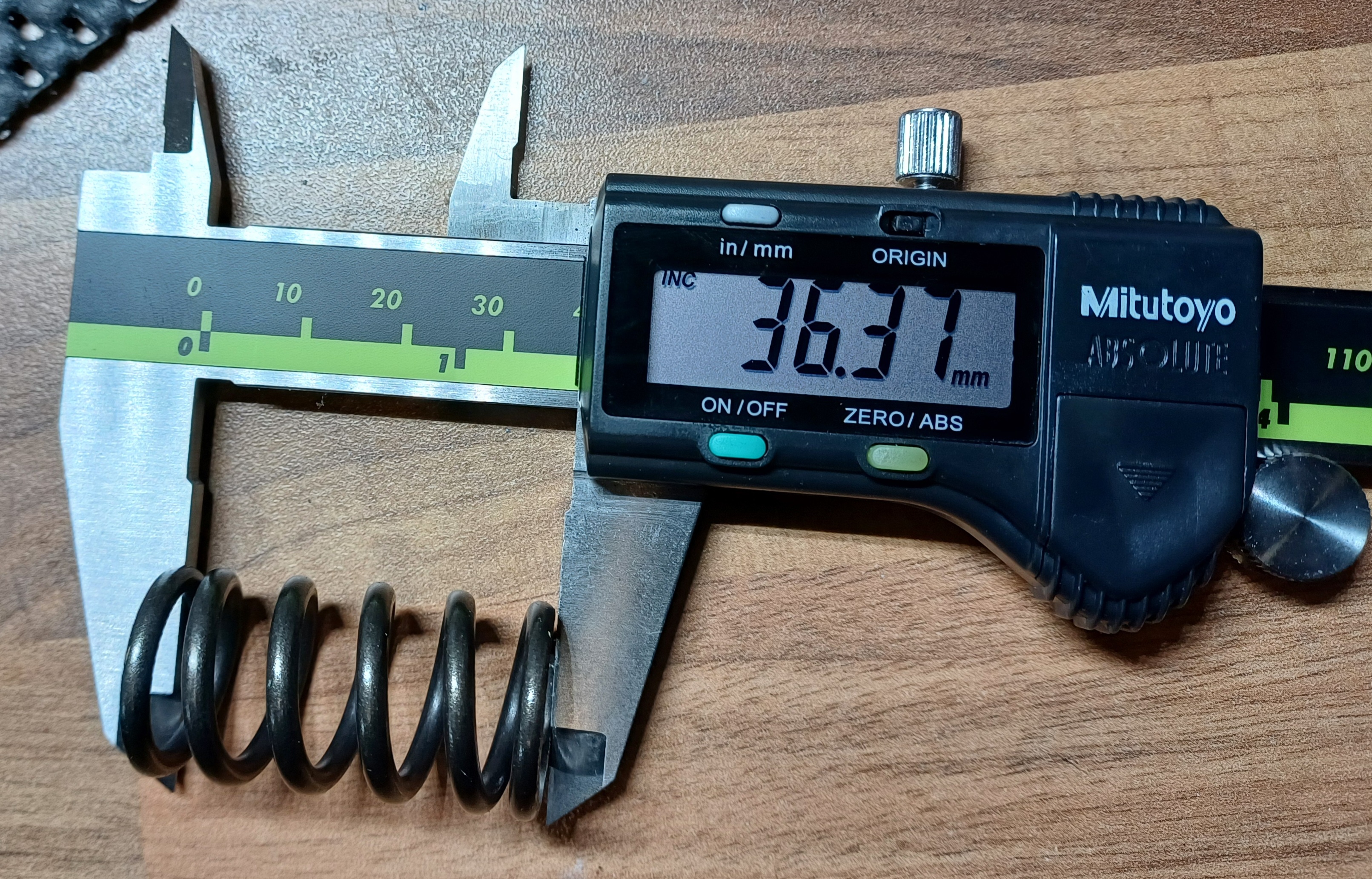

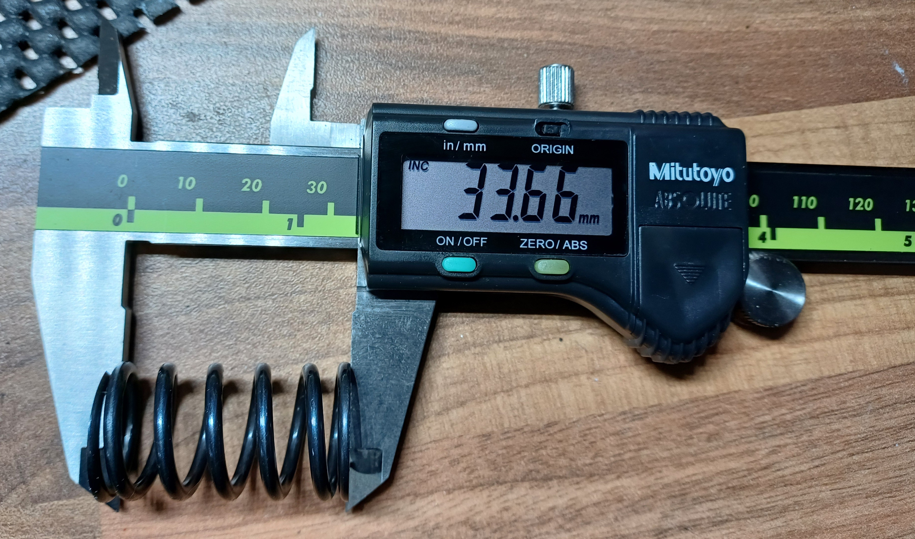

The minimum service limit for the clutch springs is 34mm,some were a little over that,but most were under. I replaced the worst with 3 ebc heavy duty springs. I didn't do them all,because the pull at the lever was noticeably heavier with 3 springs and I didn't want it any heavier,if I can get away with no clutch slip at that.

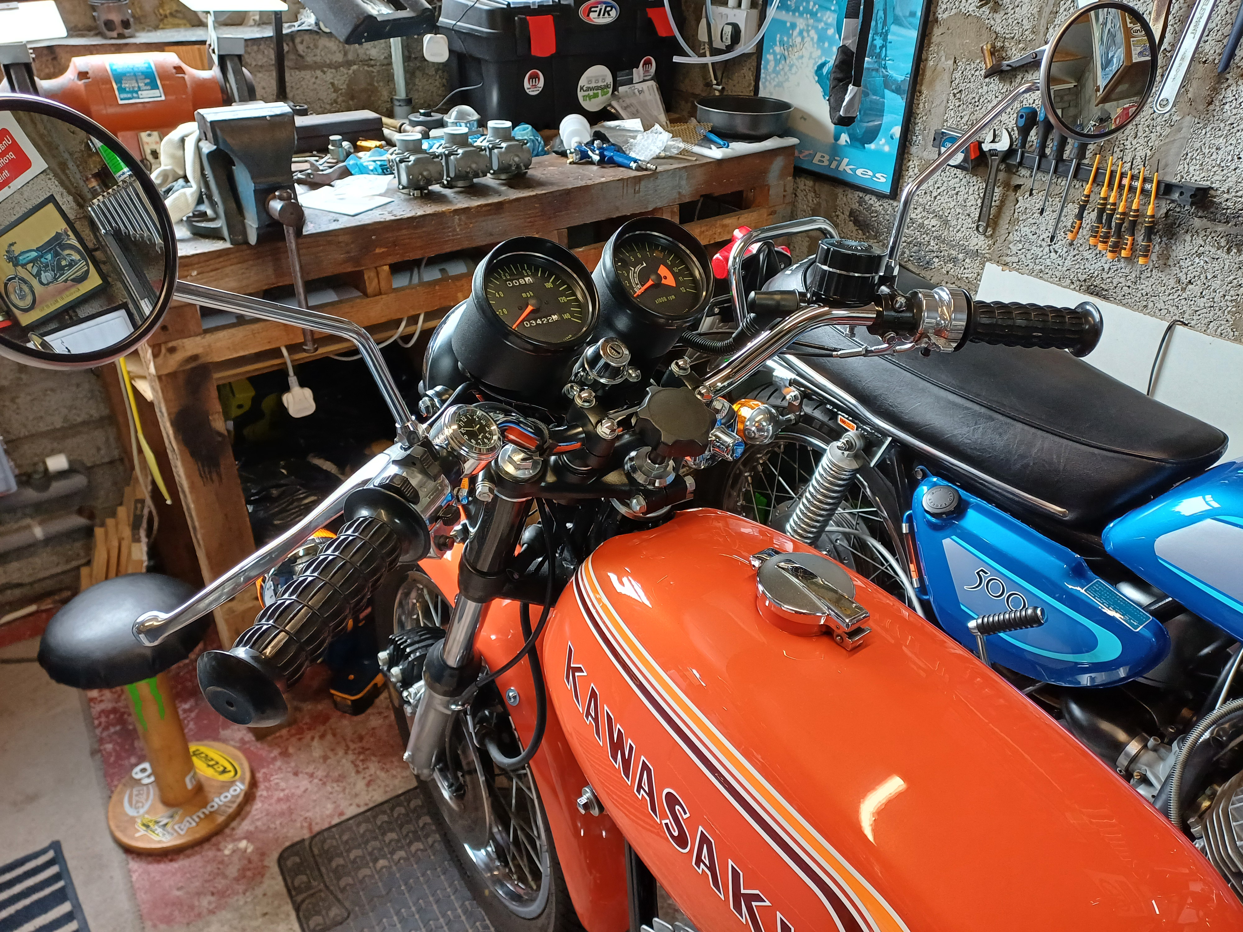

I fitted some lower bars to Mr.Orange today. The Murcan spec bars were too high for my taste and not very comfy either. Maybe help a little with the wayward handling at speed too. Hopefully.

Good move, they look much better. But I think it will take a bit more than a set of bars to fix the handling on a Kawasaki triple
- Been thanked: 14171 times
Re: 1972 Kawasaki 500 H1B
Ha! Very likely.Druid wrote: Fri Apr 25, 2025 7:03 pm Good move, they look much better. But I think it will take a bit more than a set of bars to fix the handling on a Kawasaki triple![]()
It's strange though,the B is everything you'd expect of a 70s Kawasaki triple,yet the H1A handles very well,considering. It's the limitations of no brakes and ground clearance,but no normal death weaves on the A. The B over 70 is er...interesting and requires full attention.

Those Merkin spec high bars are a bad idea. They turn the rider into an involuntary sail, so you're unwittingly pulling on the bars and making the front end light. So good move with the lower bars. Hope it makes Mr Orange a little less flappy.

I had a short run today and I'm pretty satisfied the lower bars were a good idea.
