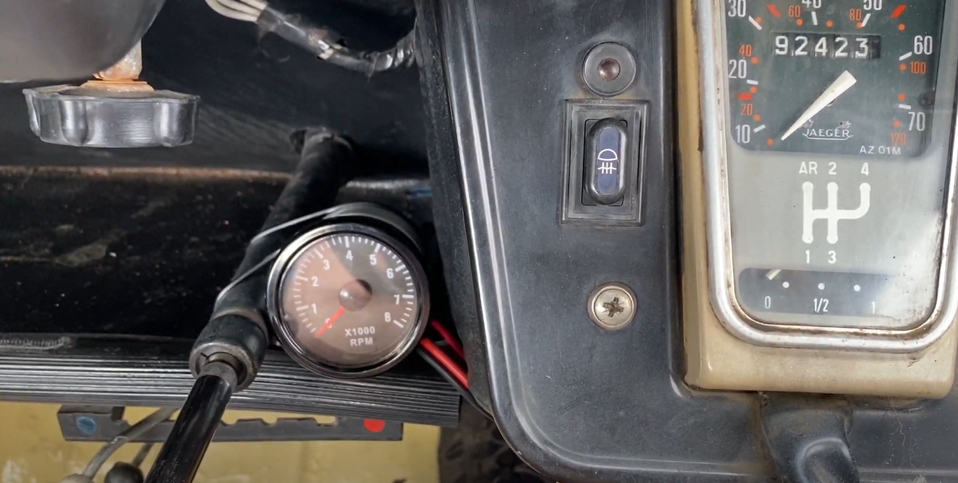

Also fitted a tacho because I wanted one...
Screenshot 2023-08-07 at 10.59.56.png (1.38 MiB) Viewed 2718 times
It's a bit heath robinson at the moment but I'll tidy it all up at some point. Interesting to see what the engine is doing though. It's routine to take the engine all the way to 6k before changing up and cruising flat out is at 5-6k. Earplugs are needed for long journeys.

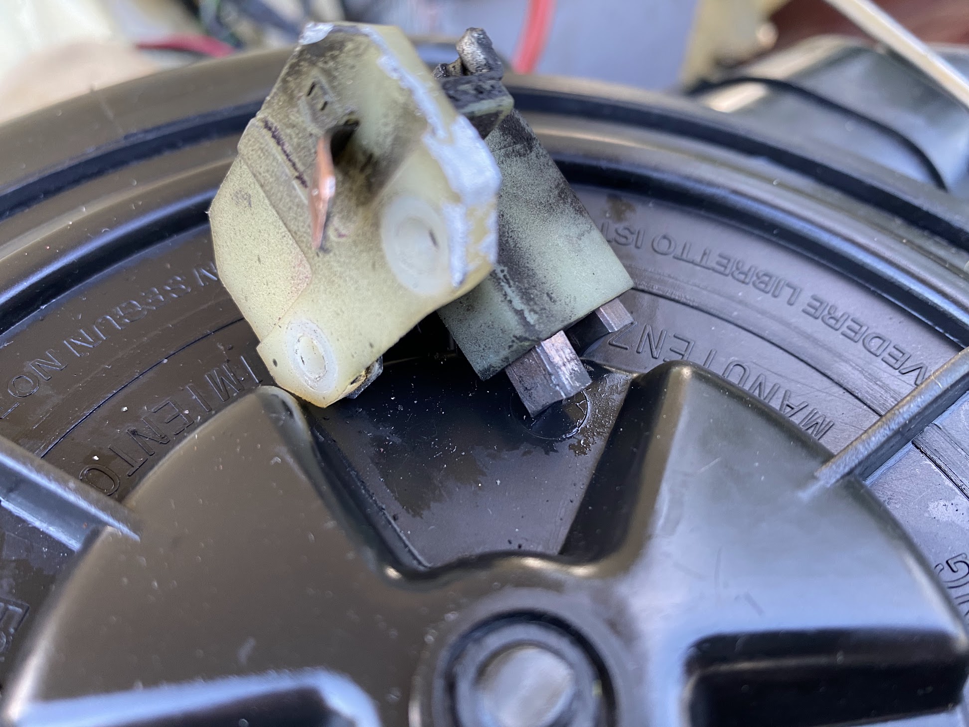

The job for this lunchtime to make the most of the unseasonably dry weather was to replace the bushes in the alternator. The battery wasn’t charging reliably and everything else looked ok so pulled the bush holder out and found they were very worn indeed. New bushes installed and the battery is charging again.
Bush comparison…

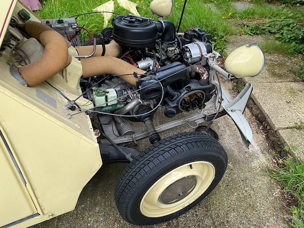

Bit of a service today. Oil and filter and checking the points and valve clearances. Oil was pretty mucky but it doesn’t stay good long in these engines. Points gap was fine but the valves needed adjusting. No pattern to it really, just small adjustments and the engine is running more quietly now and both sides of the engine sound the same.
It’s very easy to take the bodywork off to get to the valves and generally makes working on the engine a lot easier.

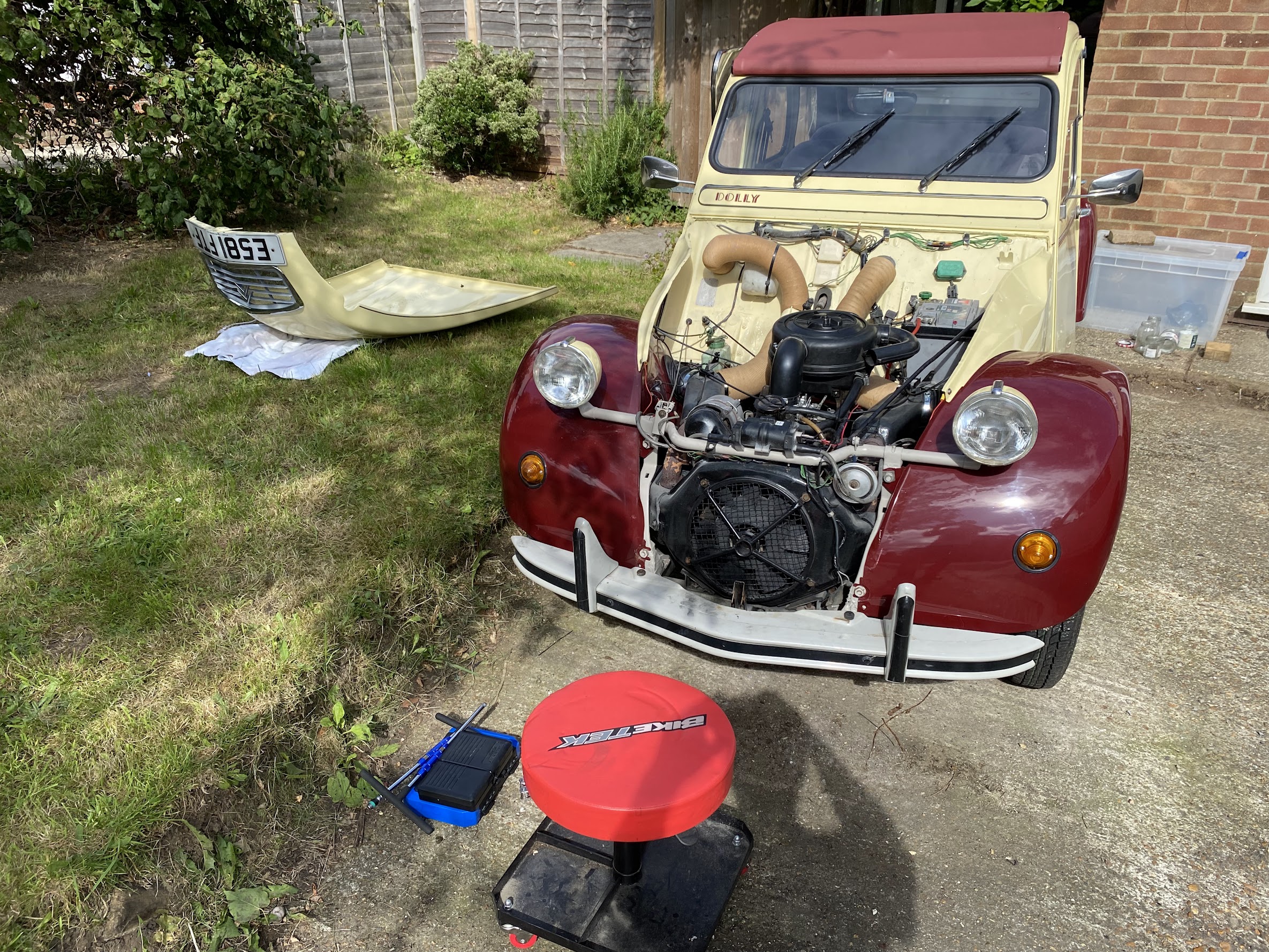

Decided to replace some parts to increase reliability and improve starting.
First job was to take the bonnet off and reinforce the leading edge that the catch bolts to with fibreglass. This flexed too much for my liking.
Next job was the fuel pump. I'd noticed that there were some air bubbles in the fuel line just before the carb so bought a new one. It's a mechanical pump that runs off a cam on the camshaft that pushes a rod which actuates the fuel pump. I fitted a version that has a priming lever which is kind of neat I think but probably not needed. Does make priming easier and the fuel can drain back to the tank if left for a while.
