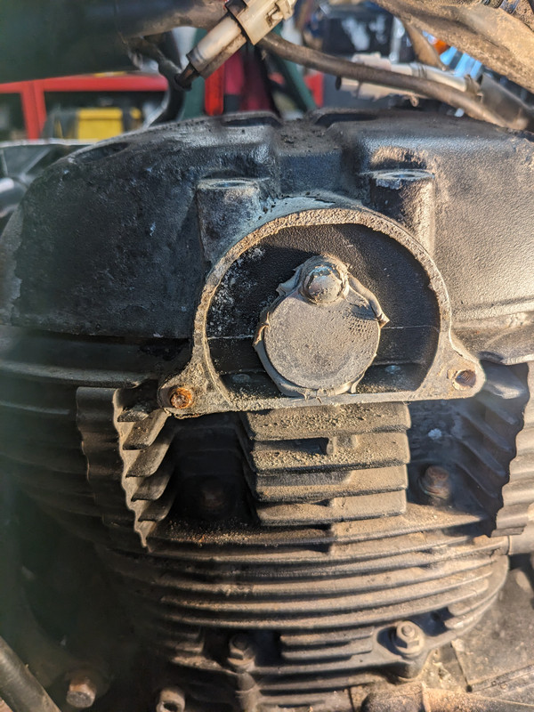

Well the head is off, one small wrinkle is that the timing sprocket retainer decided to free jump down the timing tunnel. Hoping that it's not too difficult to access, oil draining now.

Got to be worth trying a stud extractor on that first. Blow torch on the head first then have go?

Timing sprocket clip retrieved, broken bolt not budging despite heat and rust blaster. It's going to the mechanic tomorrow to see if it's worth him having a go.
