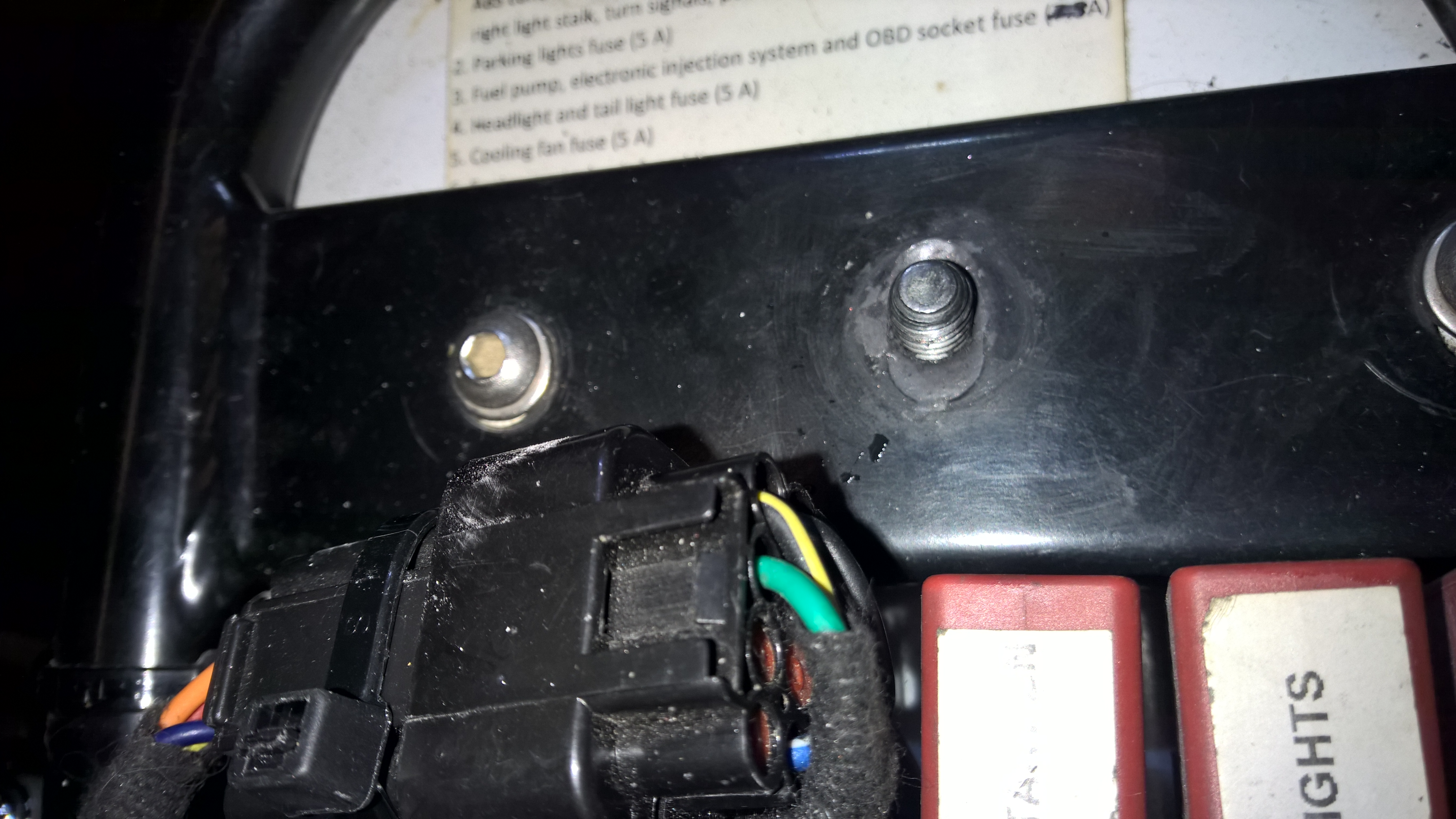

Post by Dave G »
Just remembered this mod I did. When I raised the tank up so that I had clearance for the new engine this had a knockon effect of pushing the seat back due to the tank taper. I got around this by slotting the seat fixing hole, filling it with JB then drilling it out in the new position for the fixing bolt.

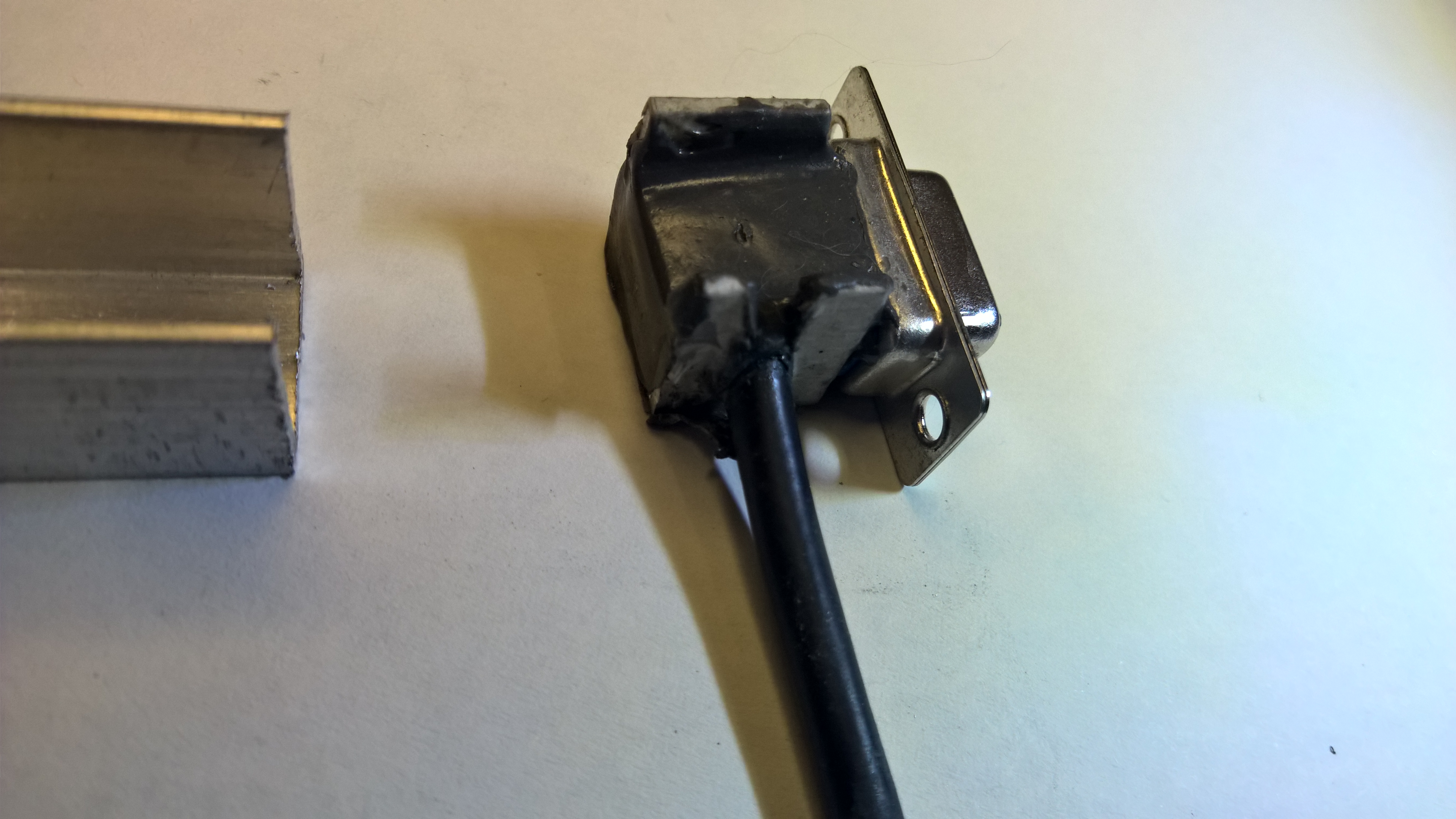

Post by Dave G »
Used some JB in my latest project which now enables me to access the CDI port without removing the seat.

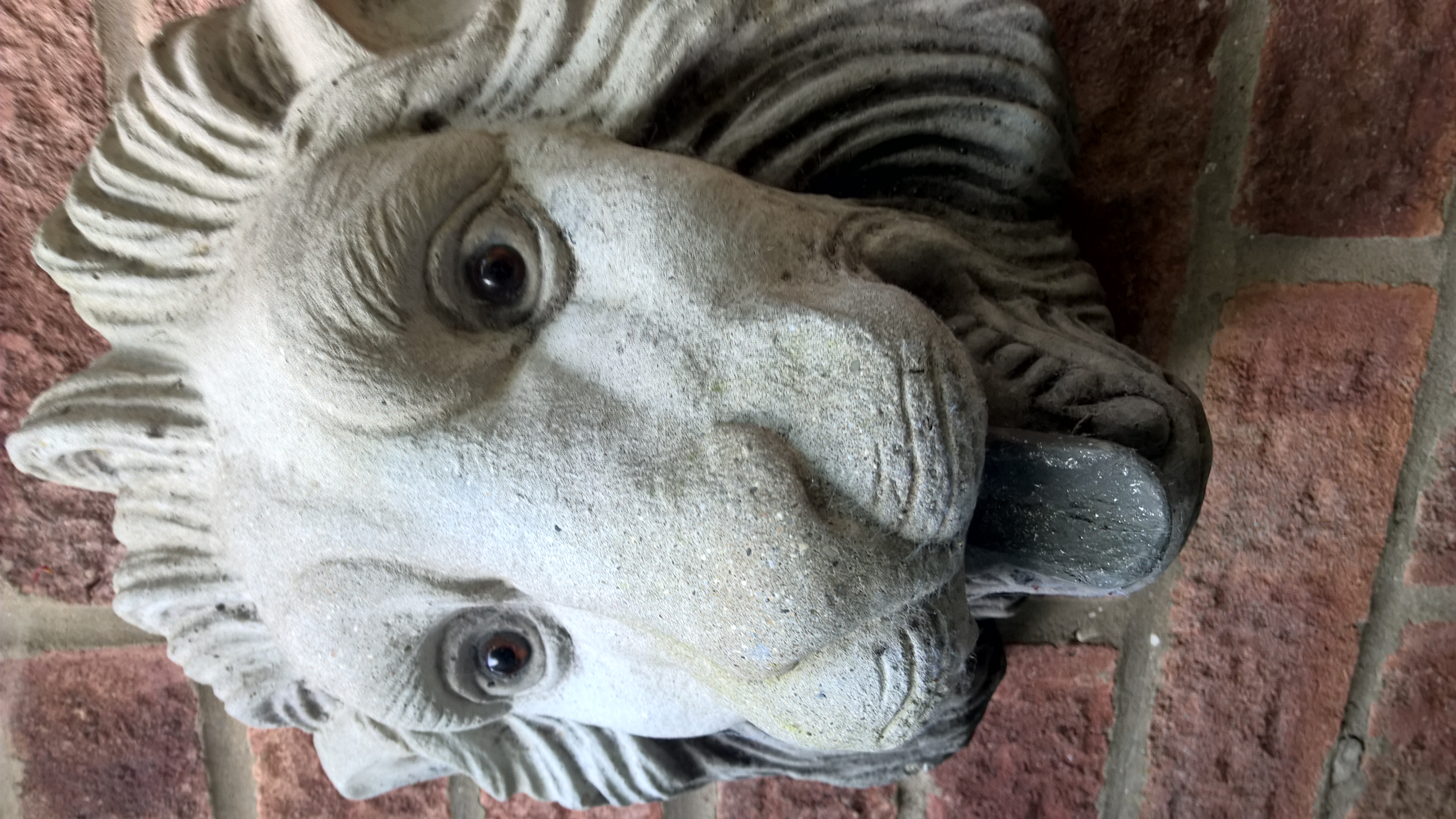

Post by Dave G »

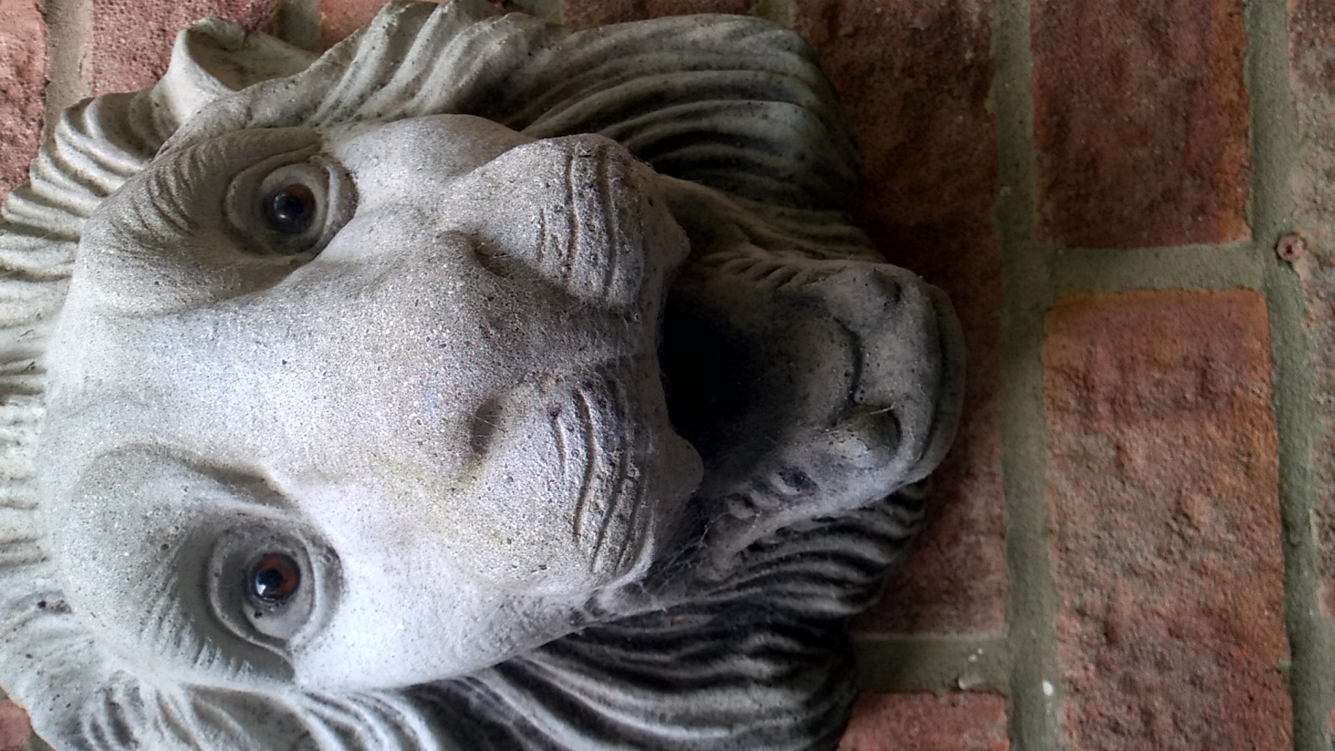

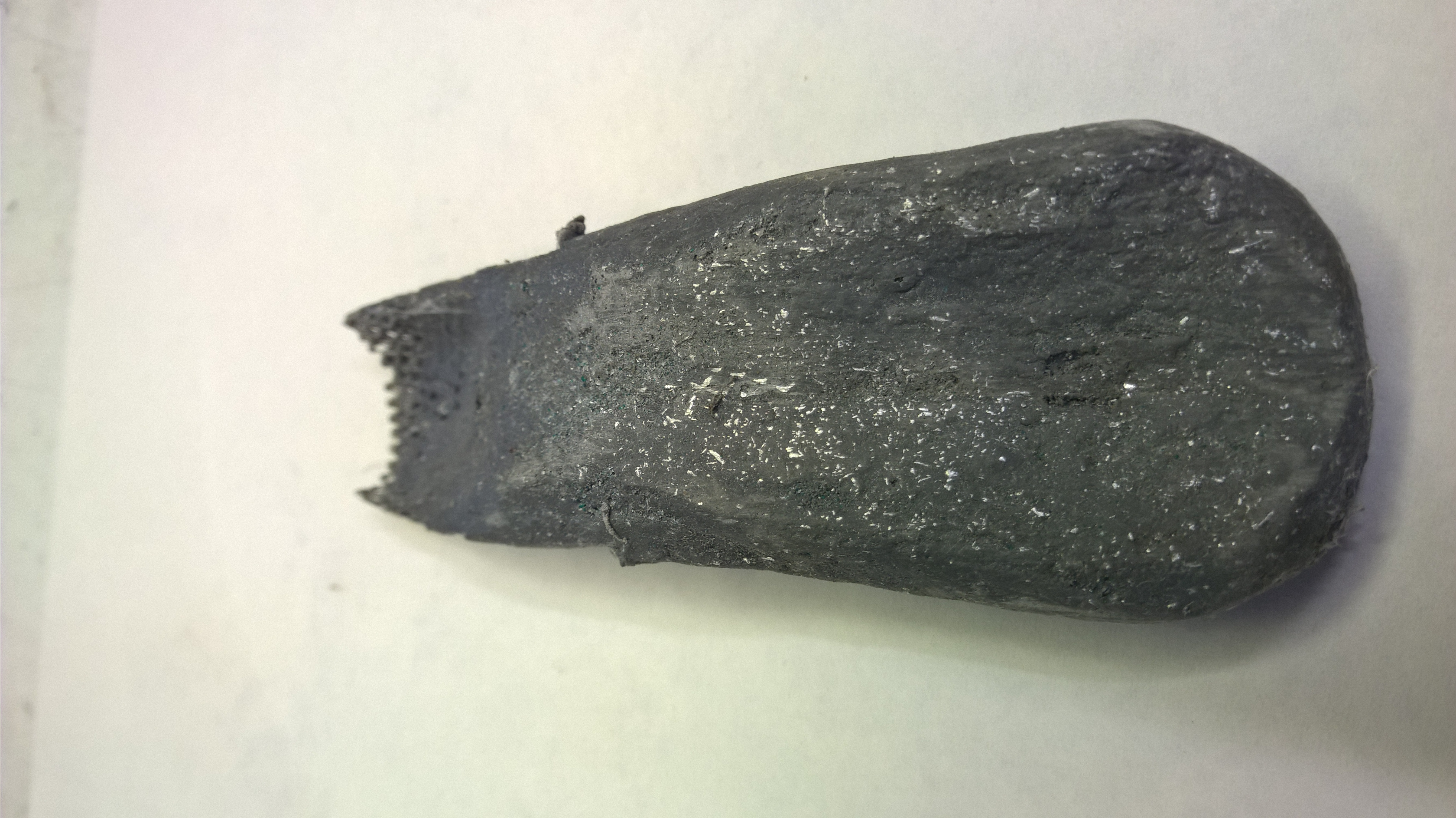

Here's another project using JB, not bike related but since no one else has any examples I thought it might keep the topic going for a while. The lions head had a hole at the back of the mouth for a water spout which I wasn't using so decided to make a tongue moulded using JB, some soft ally mesh
and a few ally filings.
Without tongue.
Tongue.

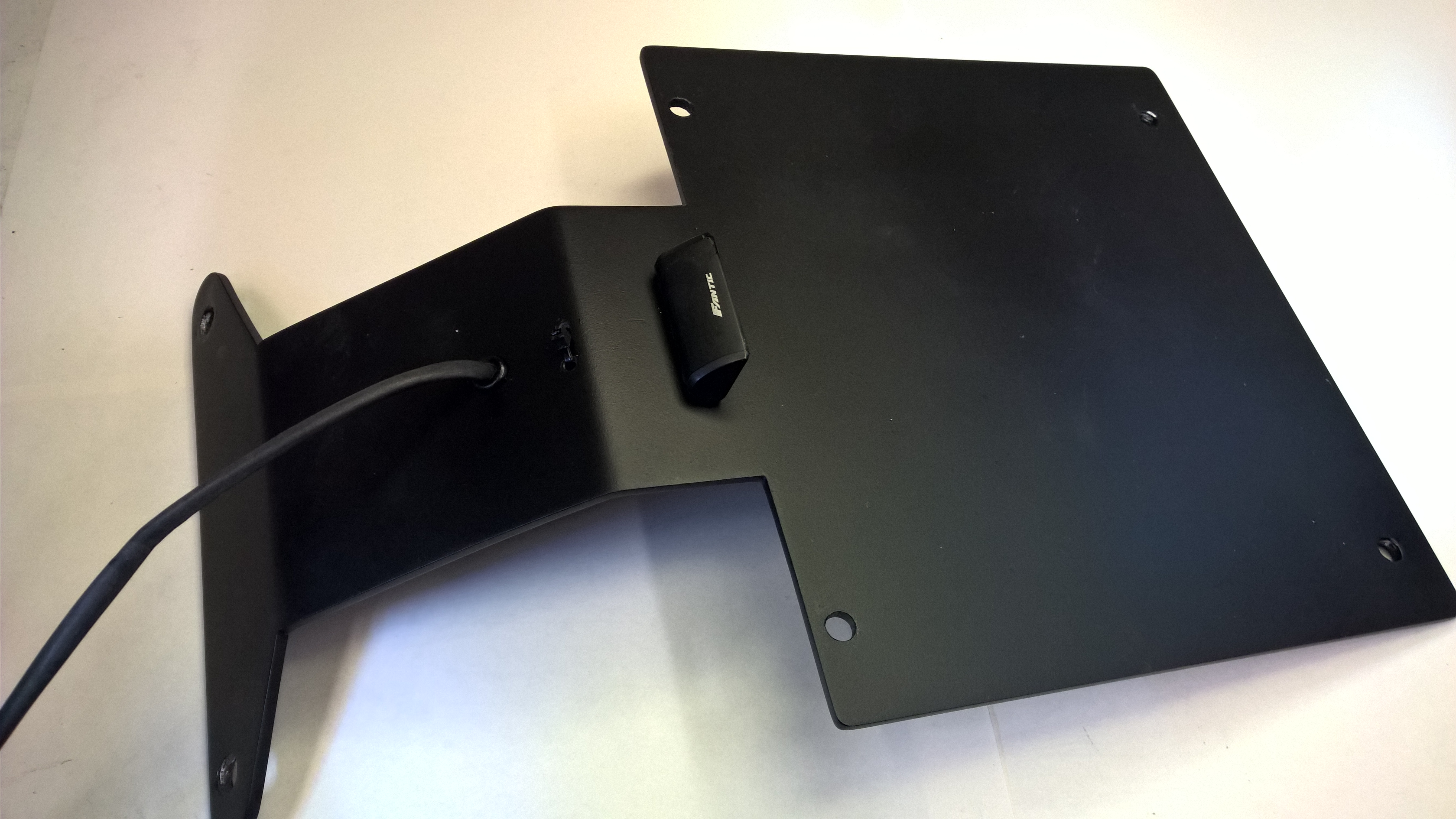

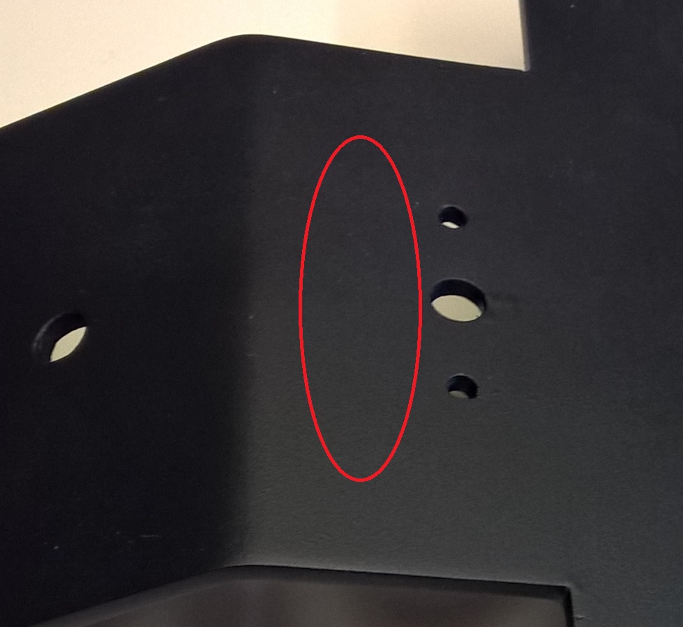

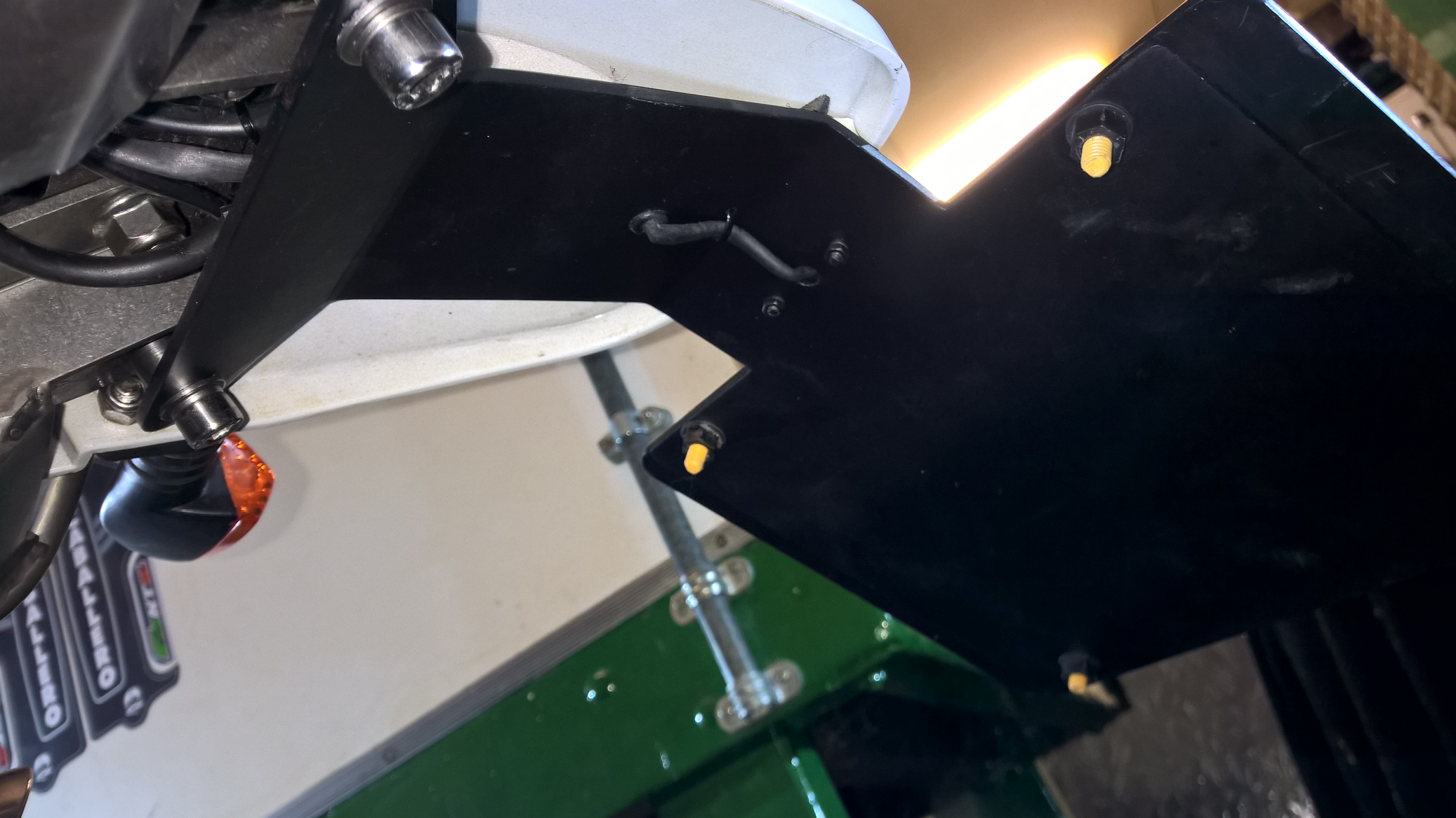

Used some JB to fill-in some license plate light holes that I drilled incorrectly in a tail tidy. Can't see them now but there somewhere in the red circled area.
