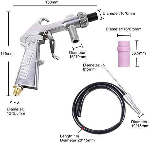

However, I just found a fairly cheap (5x as much...) alternative on Amazon which will be here later today (& is made by a company with the unfortunate name of Wogaboo :wtf: ):

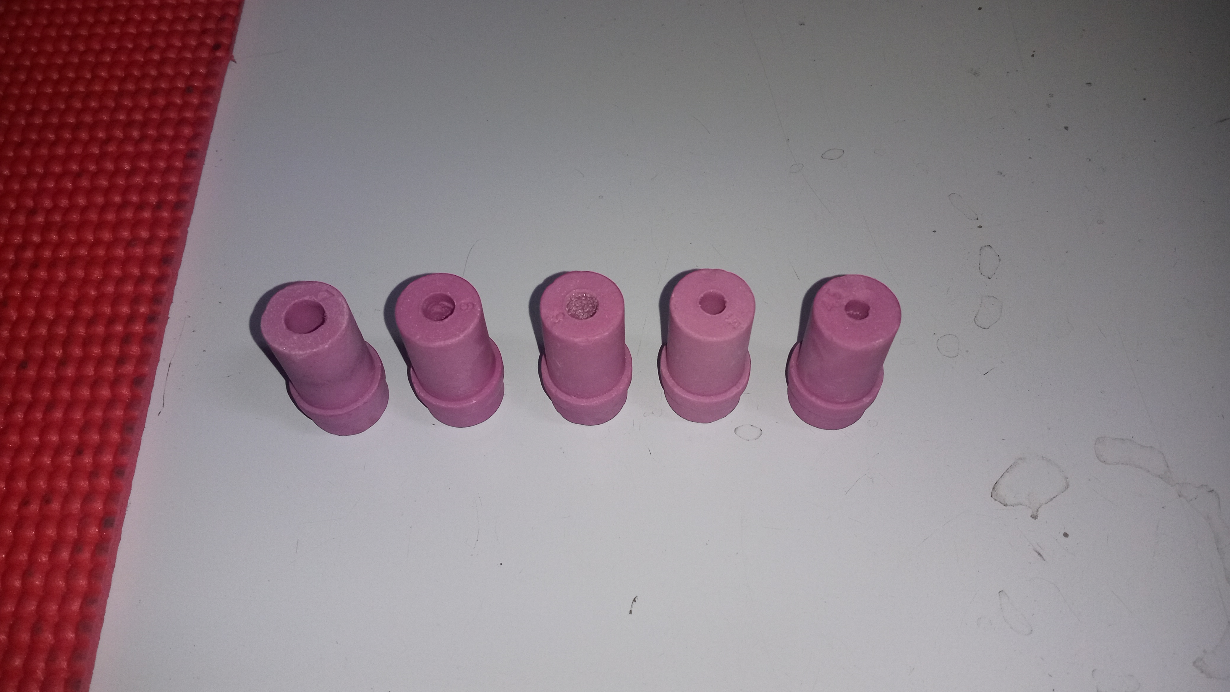

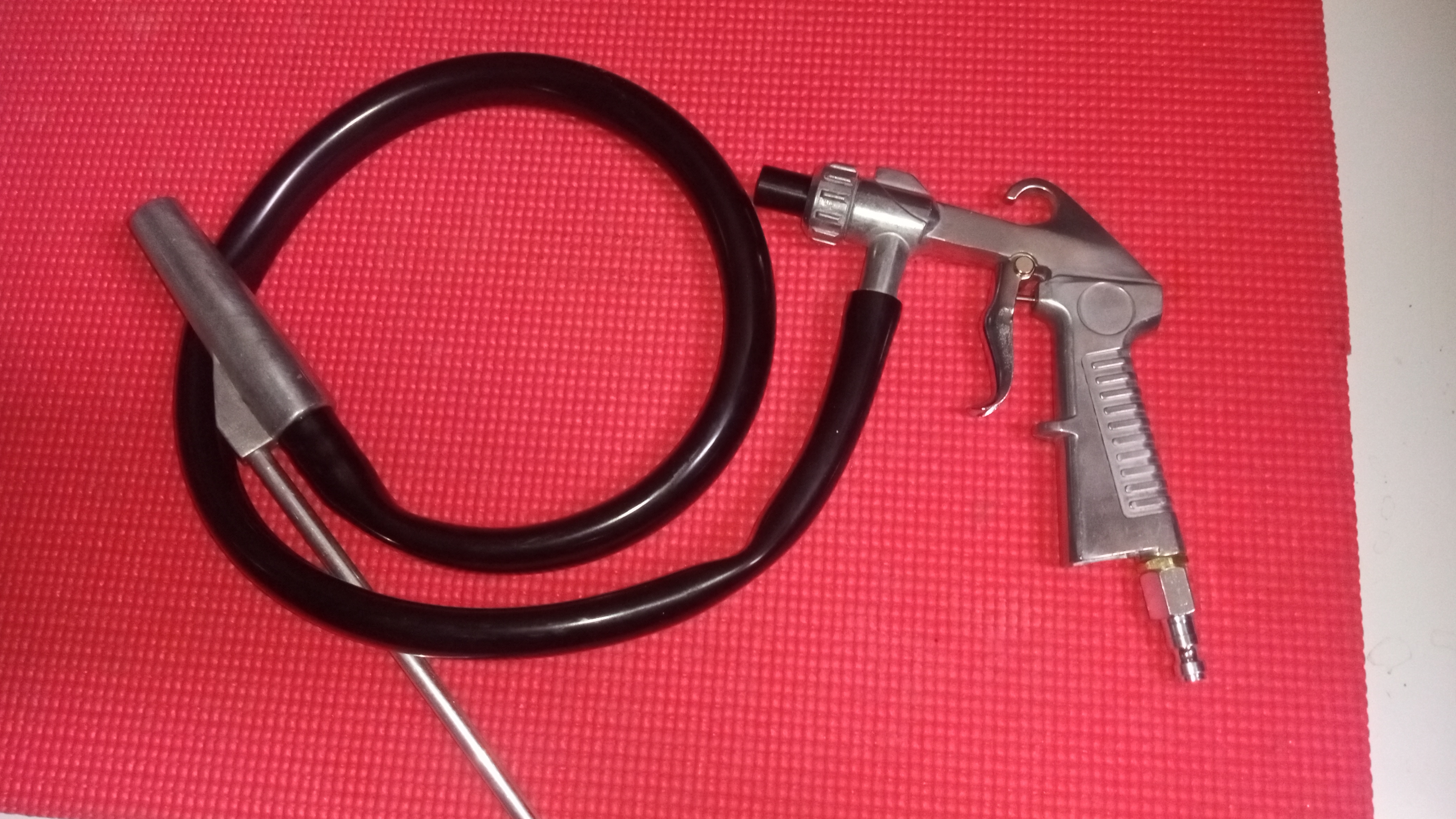

The $25 version showed up... Pic above shows a 1m hose. However, the package stated 10ft...It was neither, it was 3ft & of such crap quality that it will betting upgraded/replaced with 4ft of the clear tube that has the nylon braids in it.
Pics on Amazon also showed it with 4 spare nozzles, it actually came with 5. :thumbup:

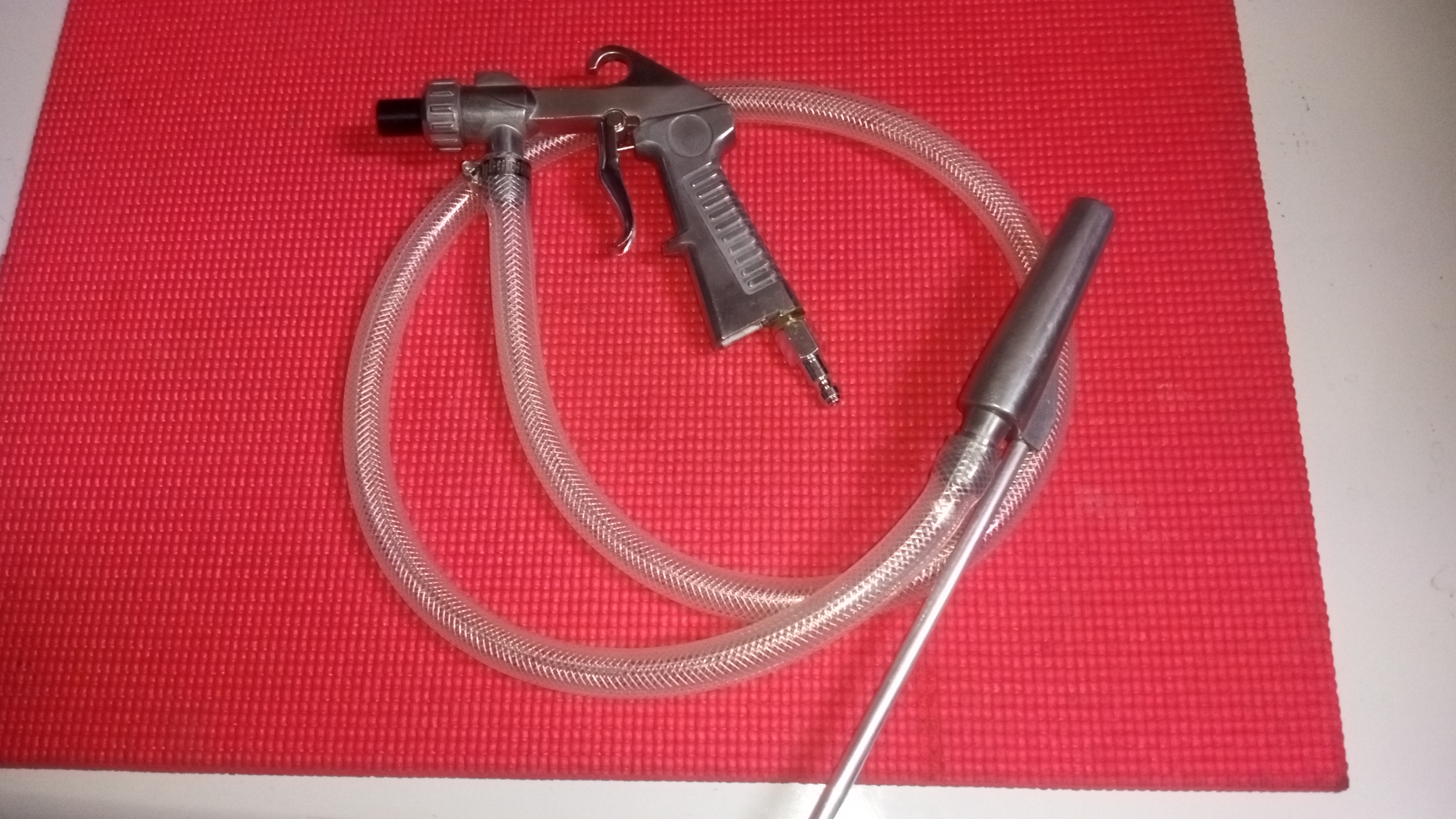

Upgraded hose fitted to the blaster....

Bought 10ft of hose, the other 6ft will be used to allow the ultrasonic to drain straight into a bucket. :)
