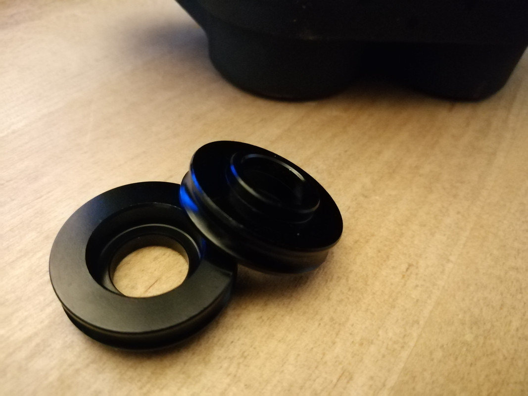

If you can see the image it's the shoulder I need machining off to sit flush against the brake mount.
BBB
Posts: 255
Joined: Mon Apr 19, 2021 10:56 am
Has thanked: 393 times
Been thanked: 118 times
Re: Finding a lathe person
Post by BBB »

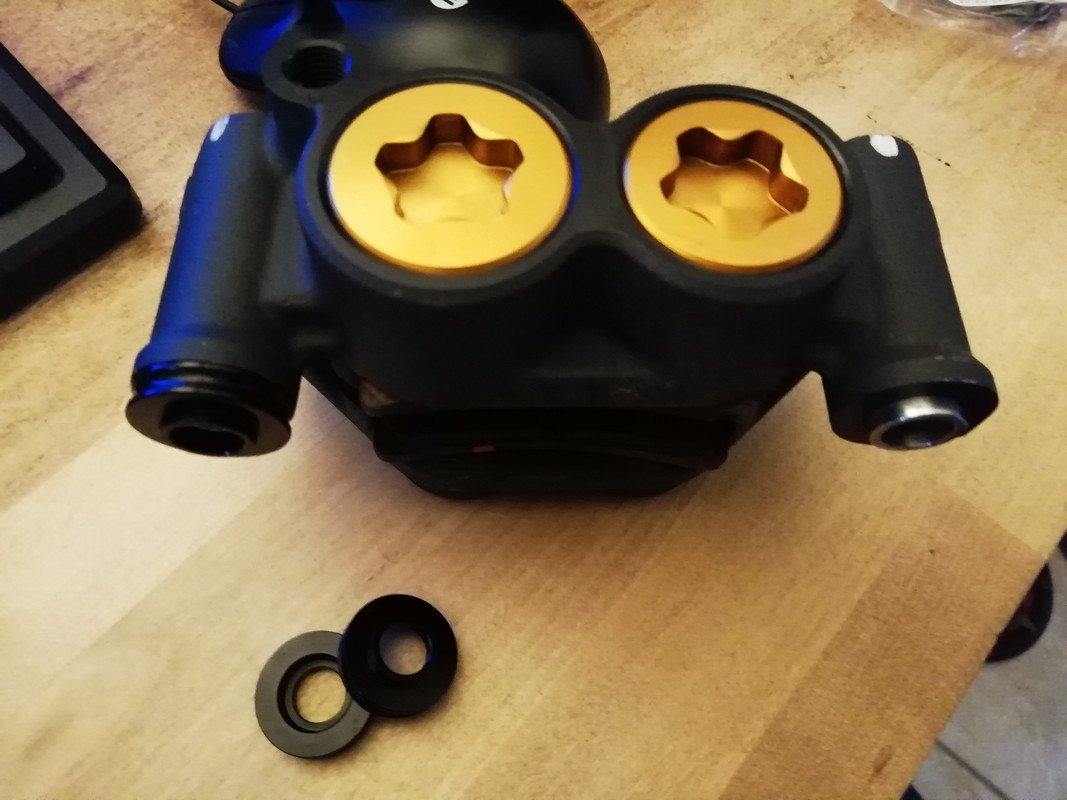

That's the bit to machine off.
The r6 calipers have a step which fits into the top of the spacer. The original nissin calipers bolt to the fork leg without any insert, just flat to flat. Doesn't seem ideal. It that's how they are.
Had thought about removing a small part of the thread in the fork bottom for the shoulder of the spacer to fit.

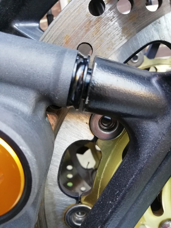

Some more helpful images
I'd take a photo of the original nissin setup but its raining and I don't have a garage.
