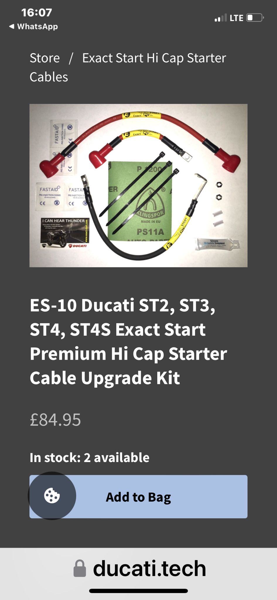

Battery terminal getting hot is a sure indicator of high current draw over an inadequately specified cable. Your mate needs to get on one of the Ducati forums or FB groups and start asking about heavy duty battery to starter cables. He'll need both cables (live and neutral) made in heavier gauge cable.

This is the guy I was thinking of - he does high capacity starter cable kits for just about all the more popular Italian models:
https://www.ducati.tech/shop/Exact-Star ... c155257294
I'm pretty sure he supplied a kit for my Falco which dramatically improved the starting, and the bike was only a couple of years old when I fitted them. Your mate might need to email/PM him to see which kit is suitable for the ST4.
Re: Ducati ST4 Starting Problem
Posted: Fri Apr 12, 2024 4:31 pm
Posted: Fri Apr 12, 2024 4:42 pm
He's gonna order leads and relay. He's back in UK in 2 weeks
