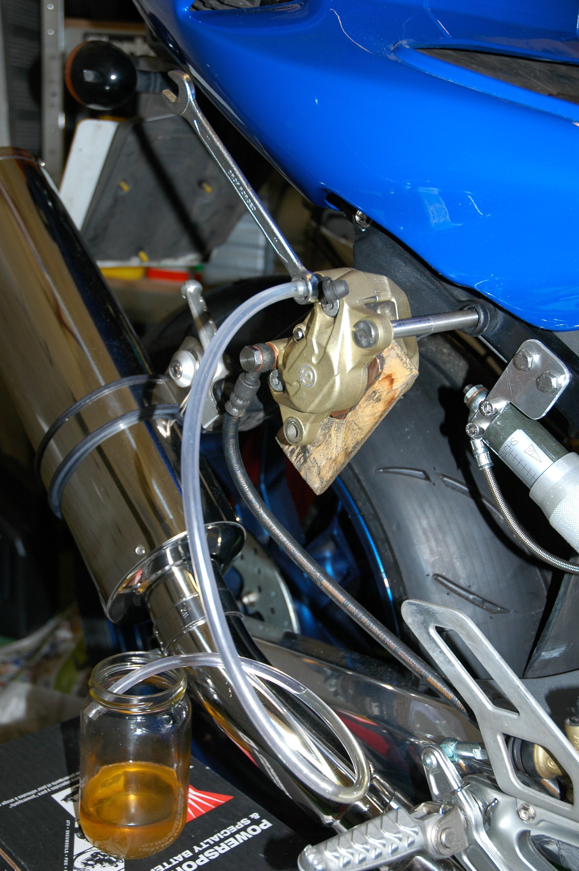

v8-powered wrote: Tue Nov 01, 2022 8:55 am Add non-working rear brakes,
caused by the bleed nipple being at the lowest point of the rear brake circuit...

It's apparently just had the stator circuit overhauled but I know these fail regularly but I'll see how that works out with the limited number of miles I do. If it turns in to a forever bike I'll replace the whole generator system from the later bike which solves the issue. It's just over 1k worth of bits but this is still way way cheaper than buying a new bike.
The bike will be on a smart charger all the time so I can look after the battery and sprag. The full sprag kit is a couple of hundred so won't break the bank.
I can balance the throttle bodies no problems.
I had an oberon on one of the ktms and will fit one if there are any issues.
The rear brake master can be angled to help with the problem or mounted vertically on a set of rear sets which feels like the way to go.
Posts: 8850
Has thanked: 2554 times
Been thanked: 4159 times
Re: Project Aprilia
I'm not sure if the RSV layout is the same as the Falco, but this is how I bled my rear Falco caliper. It needs a length of metal tube of the right i.d. and a long bolt, but does the job.

mangocrazy wrote: Tue Nov 01, 2022 11:17 am I'm not sure if the RSV layout is the same as the Falco, but this is how I bled my rear Falco caliper. It needs a length of metal tube of the right i.d. and a long bolt, but does the job.
I think thats the common solution for bleeding the rear brake on the Multistrada as well. They dont work well for long as the reservoir is next to the catalytic converter so the heat from it boils the fluid. The common fix is constant bleeding and flushing the fluid or the proper fix is to use high temp brake fluid at about 75 quid a small bottle .....most people remove it, turn the caliper upside down and place it high to bleed it ;)
