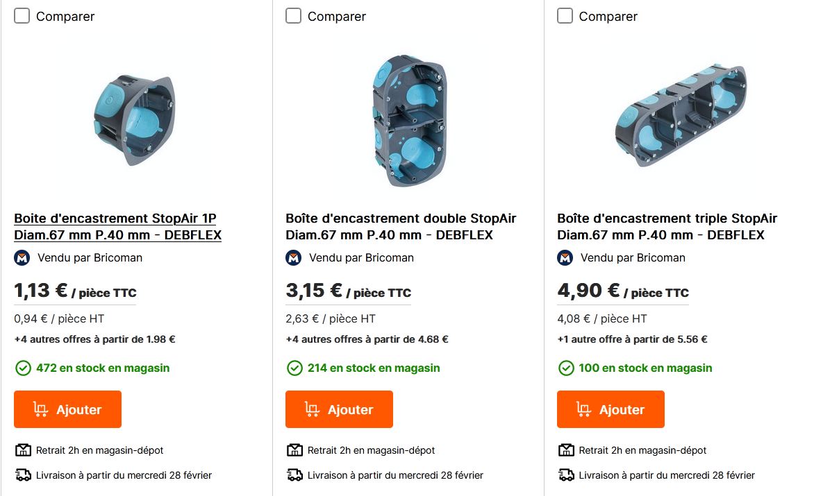

Which is why the back boxes for french power sockets are circular. Just use a core drill or hole cutter (depending on substrate) of the right size and you're good to go.

Modern fast fix lighting back boxen can be circular.
Re: Cutting rectangle holes in 1.8 OSB wood
What happens with a Fronch double socket then? Massive circular hole? Or do they just not have 'em?
Posts: 5463
Been thanked: 2730 times
Two circular holes, maybe opened out to a stadium shape.
Posts: 8857
Has thanked: 2557 times
Been thanked: 4168 times
Mr. Dazzle wrote: Sat Feb 24, 2024 10:17 am What happens with a Fronch double socket then? Massive circular hole? Or do they just not have 'em?
It's as cheb says, kinda like an oblong with rounded edges. Alternatively two circular holes side by side. You can buy single or double back boxes, as in UK.
Posts: 8857
In fact you can buy triples, as well...
