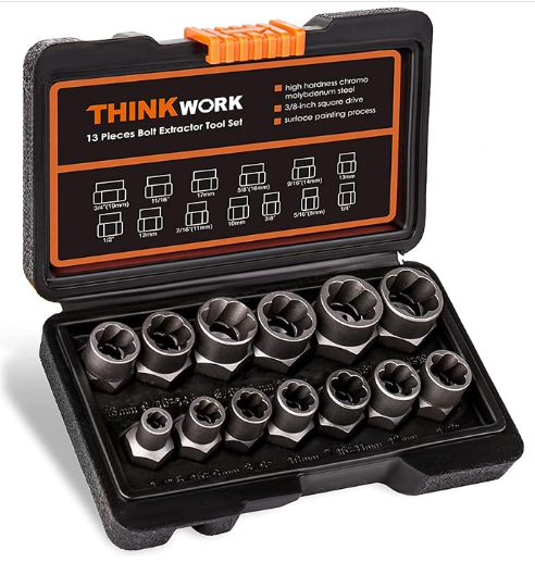

KungFooBob wrote: Wed May 29, 2024 9:53 pm The first person in human history that an easy-out worked for?
I would have chucked the screw. Wheel nuts hold it all together anyway.

ZRX61 wrote: Wed May 29, 2024 11:02 pm
These things are the dogs bollocks, they've worked every time I've used them:
It was the screw heads that were stuck, not the threads. I drilled the heads off then then went to drill a hole in the shank. They both turned in the holes, but there wasn't enough room on the back for the pieces to come through & fall out. They were already loose before I drilled for the doodads, spun right out.
I've got some of those and had some success with them. These are also brilliant, the harder you turn they more they cut in. I had a sh300 and when i went to do a belt change I found it the crank nut was rounded off. One of these saved the day!

Re: SBH Stuff...
Got some of those too (different brand, RocketSockets) & some meaty internal ones (Irwin).
