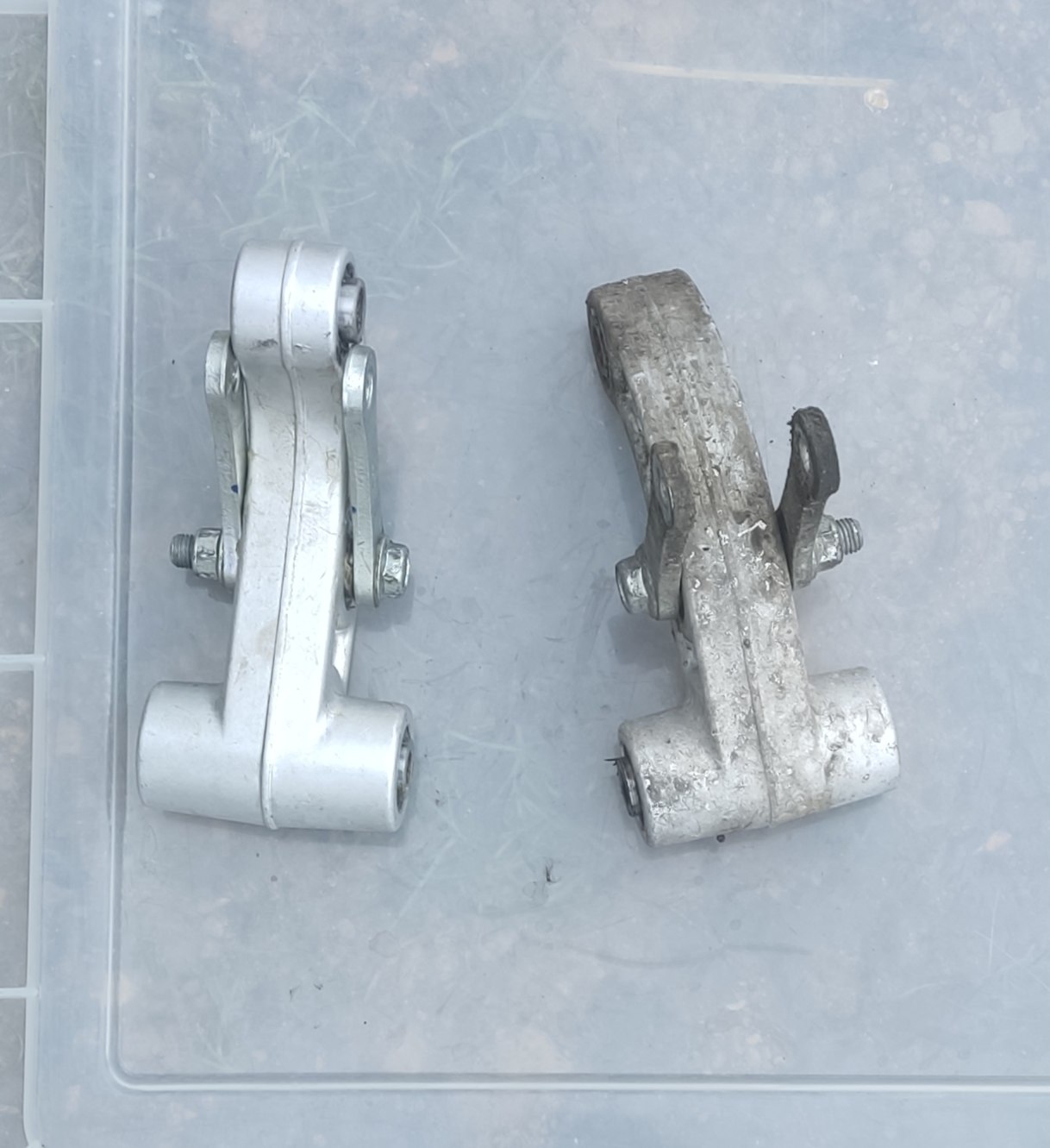

At the last MOT, there was a wee bit of play in the rear linkages. Not enough for a fail, but enough for me to scratch my chin.
A look on Fowlups spares page.....£18 + vat x 4 + seals x 6 + 3 shafts. Well over £100.

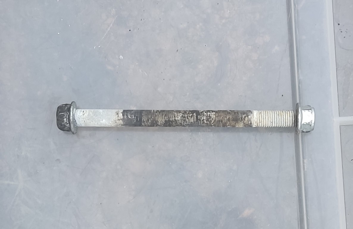

A quick check on eBay, very low mileage '22 complete bell crank.......£35 Whilst I was in there, this was the frame bolt Don't think it has ever seen grease!
All bolted back together, just a perceptible bit of play now, but it is a Yamaha......they're like that from new!

Kawasaki are notorious for letting the suspension linkages/headstock bearings/swingarm bearings on their bikes to barely smell the grease. I swear they have the same tub of grease still half full from 1969.
Not long from new I stripped those parts on my Zed and greased them properly.

When I fitted the ohlins, I made sure all the bearings/collars/bolts got a good dousing of waterproof grease.
My mistake was expecting Yamaha to have actually put some on the others.......silly me!

The dry bolt was part of the rear suspension linkage (frame pivot) which according to yamaha themselves should be greased prior to re-assembly.
