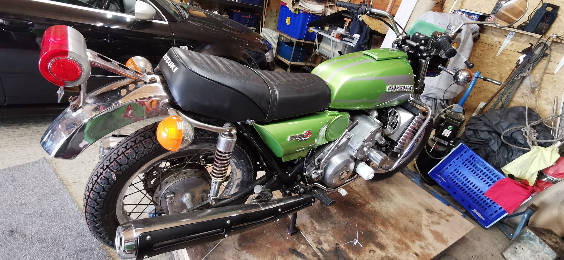

Anyone here really knows how they work friend R is Has been restoring one it has compression and seems that the second carb has been deleted It wont fire under any circs We guess that the thing fires in two different places hence the second carb? but that someone before took it off ( Figuring it want nessesary) anywell founded knowledge gratefully stolen....random RE5 pic of it been worked on

since this above pic was taken the whole back end has been done hub wheel spokes the lot

No I don’t know, but isn’t it twin rotor?
Two carbs not surprising then.

I always thought that the RE5 only had one carb.

As far as I can make out the lack of secondary carb shouldn't stop the bike firing up. They come into play at higher revs. Dunno what they had to do to get the same performance without it. :hmmm:

Just looked it up. It was fitted with a two-stage, two-barrel 18–32 mm Mikuni.

Didge wrote: Tue Oct 21, 2025 9:47 pm I always thought that the RE5 only had one carb.
It's hard to work out - they refer to both primary and secondary 'throats' of a two-stage carburettor, which actually sounds like you can't delete it.

Thanks for the replieswe are no wiser but have something to look further into we weren't sure if it had a second combustian chamber but the two throated carb sounds right to me two sets of wires to the throttle presumeably off set

There was a bit of an article in Classic Motorcycle Mechanics recently (July 2025 edition). One thing that could be relevant is this comment from an RE5 owner -
"I rang a place near Whitby and in explaining what was needed, including a small choke flap, I was told that without it I'd never get it running." Apparently, this part could not be found and one had to be made up. Unfortunately, there are no more details about this choke flap - but it might be worth investigating.

As an owner of several rotary cars, wet plugs/flooded motor are a no-no!
You should not fire it up and not let it warm up properly, they'll gas up and require dry plugs....again.
