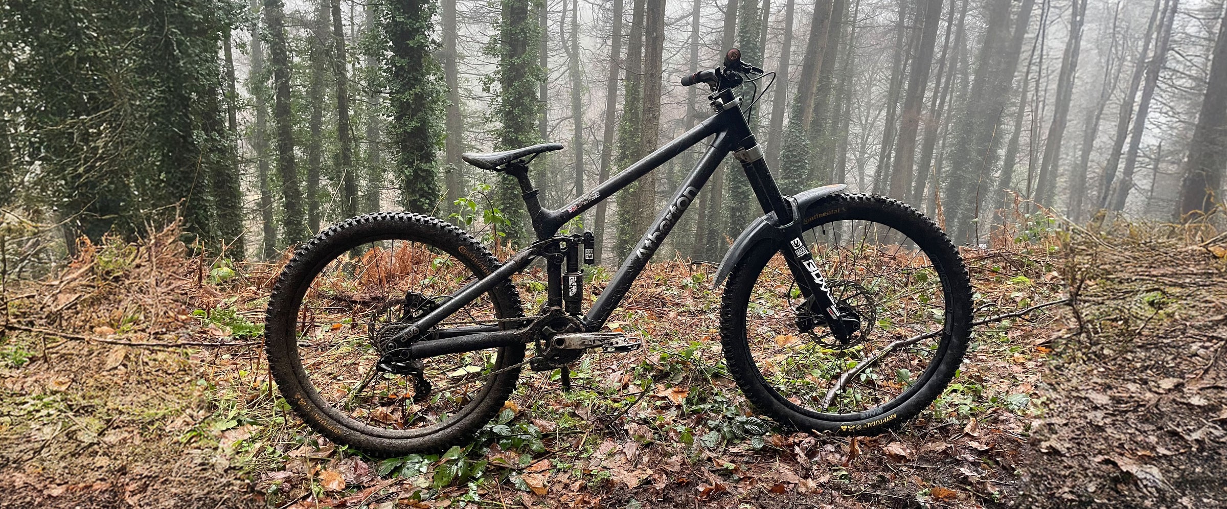

Another weekend of mud and slop, this time at Tirpentwys trails with me as uplift driver. It's not exactly the most enjoyable bit of my bike time, but it's OK being with the lads (and girls) chatting rubbish and having fun.
I then was sorting his bike this morning and looking at the rear linkage and thinking "that's a bit muddy in there... " but then as i cleaned it I could see more mud in unreachable places. I used a cable tie to get that bit out, then another...
Next thing you know i've got the Chainguide off, the cranks off, wheel off, the linkage is all apart and the chainstay hanging by a bungee to keep it out of the way. It's not a hard job but is slightly time consuming, but it's deffo a rewarding job and you get to check all the bearings and linkages etc.
Throw it all back together and torque everything correctly and we're good to go :)

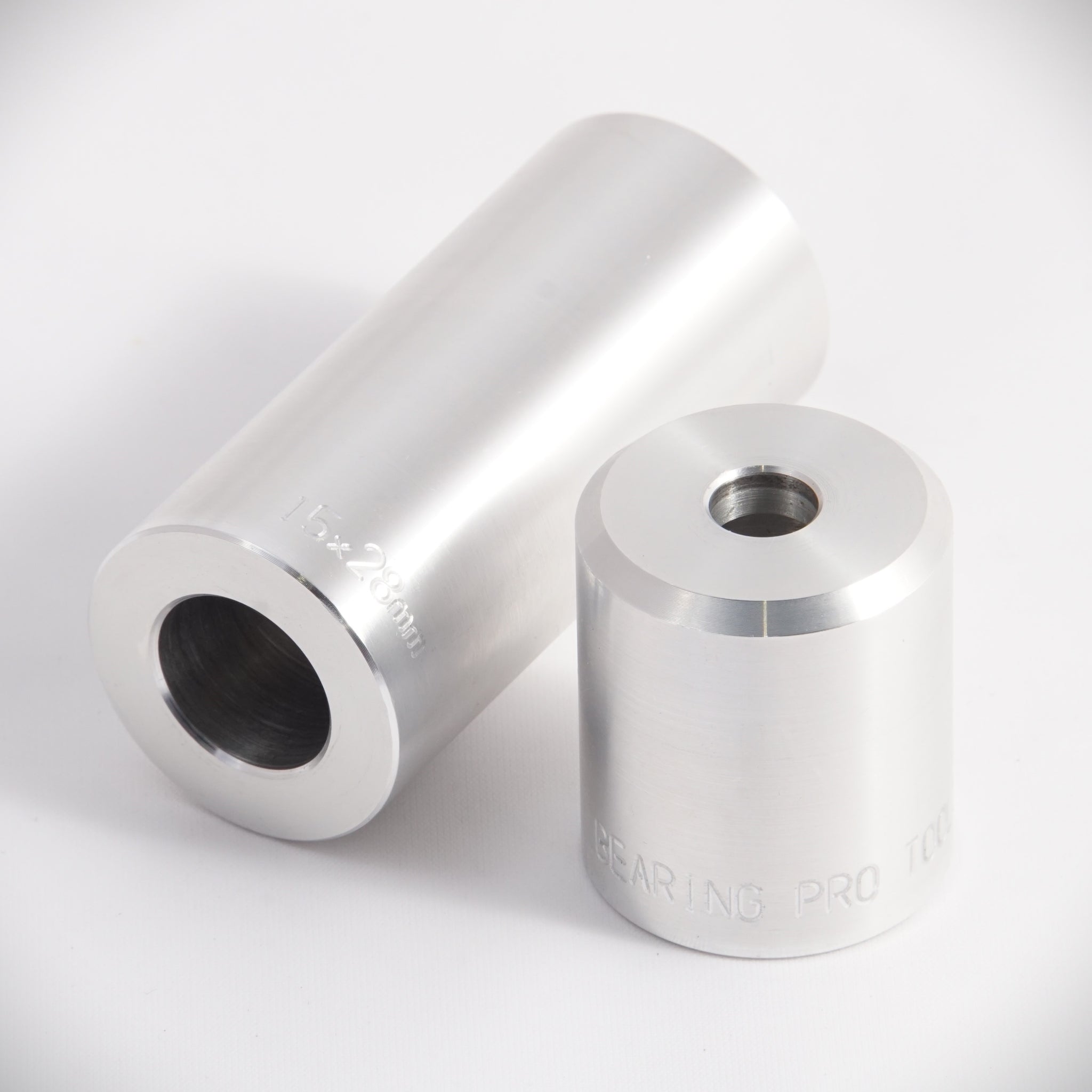

Had a sticky freehub on the Bontrager Pro 30s. They're the standard wheels that came with our Fuels.
The darn freehub endcaps were utterly insane to get off.. Jeez that took some effort and patience.
Then onto the freehub and main bearings. The main bearings i bought a press kit for which allows the internal spacer to go all the way through, which last night was the first time of using.
These turn a faffy job into a breeze and they were replaced easily.
The freehub was a bit more complex. At the bottom end you've got 2 bearings, then a spacer, then a circlip then a top bearing... The 2 bearings are a struggle, then getting to the circlip is somewhat challenging... but to get to that other circlip you've got a long spacer which takes up the free space. That also was somewhat of a sod....
Then you've got the fact that you lose all the pawl springs, which are the teeniest tinyest things ever... But eventually you find everything and replace the affected bearings there too :D You've then got a working freehub.
Considering the new freehub is £85, i'm not actually sure it was worth the time and effort :D :D

I would have just bought a new freehub (or non Bonty wheels)

Well the Pro5 is £240 even at trade price, which is a lot more than the £10 of bearings. But i do absolutely get your point :D
We've had them over a year so it's not terrible, but next time it'll get a Hope i rekon.
