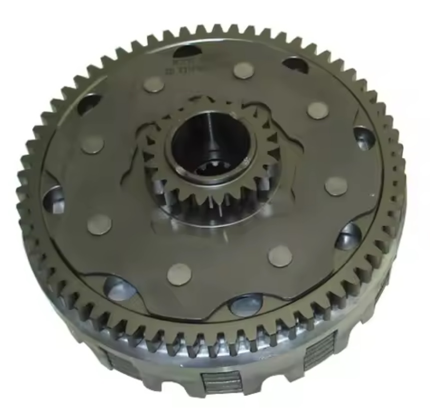

Post by ..... »
Doesthe gear engage off the centre of the clutch bsketoroff the outer teeth had all thinner teeth shear off ahusky610
Dave G
Posts: 143
Joined: Thu Sep 18, 2025 5:55 pm
Has thanked: 88 times
Been thanked: 71 times
Re: Fantic Caballero 500 and Kove 450 Rally kickstart mod
Post by Dave G »
Yes it does, here's a pic showing rear of clutch basket.
