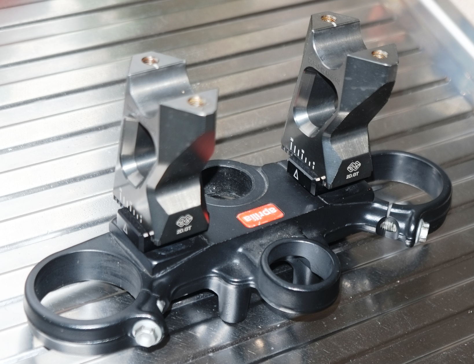

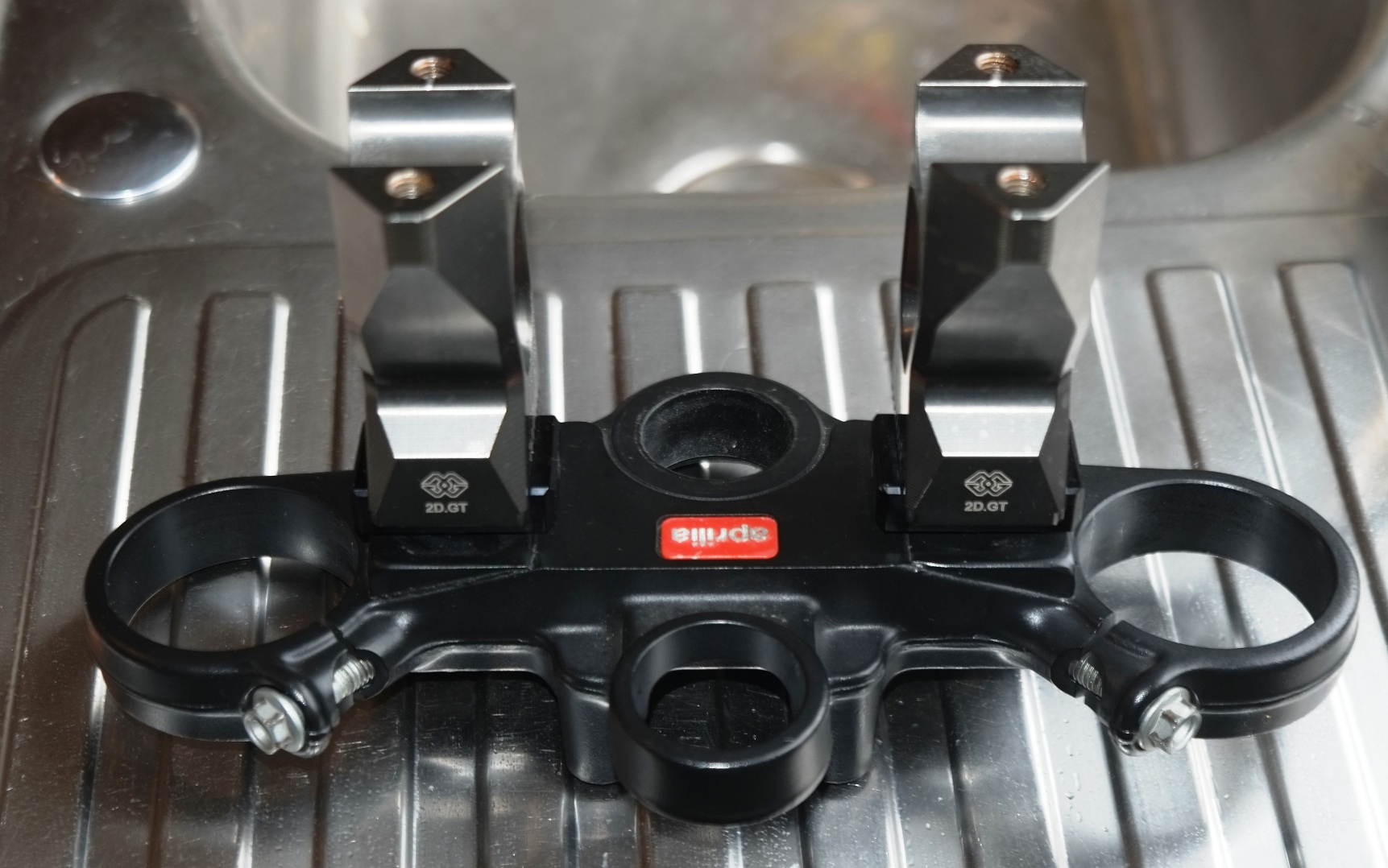

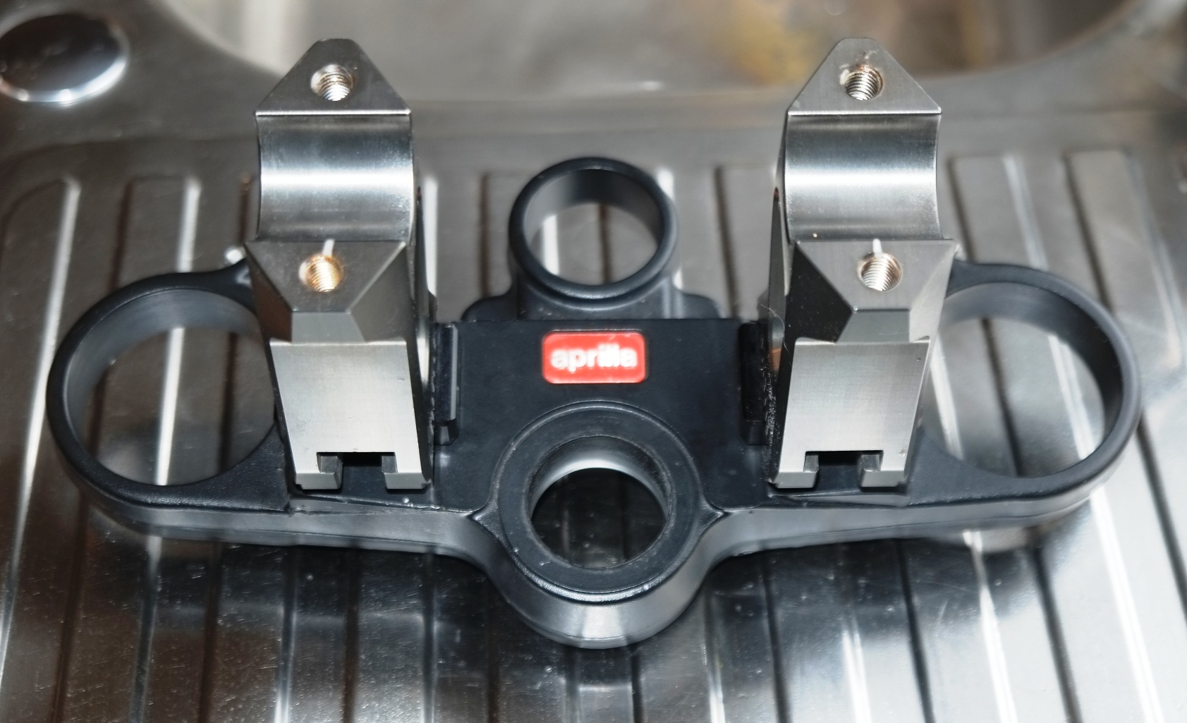

The first set of replacement bolts arrived, only for me to realise that they were a different thread pitch than the nuts that came with the previous MT09/Tracer risers. This was a problem as these nuts were a reduced head size (14mm as opposed to the more normal 17mm head/spanner size) and that reduction was crucial in them fitting between the ribs on the underside of the top yoke. So I then had to source some high tensile 10.9 M10 x 1.25 part threaded bolts with standard 17mm head size to work with the T-slot in the new Gilles risers.
Anyway, these arrived very promptly (shout out to Westfield Fasteners) and it was time to fit the risers to the top yoke and see how they fitted. First fitting was close, but not quite a cigar. The risers were just fouling the tank harness on full lock. So off they came again, and the risers were moved forward one adjustment notch (corresponds to 3.5mm of movement per notch) and the assembly was offered up again. This turned out to be spot on, there's clearance (Clarence) between riser and tank harness and brake/clutch levers and screen/fairing on full lock. That'll do nicely.
The real test will come when I can take it for a spin and see how the ergonomics have changed with the new risers. The bars are an inch (26mm) lower and slightly further forward, so not sure how much of a change I'll notice. Anyway, here's some photos of a Falco top yoke and Gilles bar risers on a stainless steel sink drainer.

I forget - did we already cover why you can't use tuono yokes or some other OEM part with risers attached other than by one piece of thin cast metal glued to another piece?
My mate was telling me about a street fighter where he'd done that and ripped the metal of the yoke at the mounting point. Sounds like a fun way to go out.

A_morti wrote: Sat Jan 31, 2026 12:12 pm I forget - did we already cover why you can't use tuono yokes or some other OEM part with risers attached other than by one piece of thin cast metal glued to another piece?

That was covered earlier in this thread in quite excruciating detail. With the benefit of hindsight a Tuono yoke would have been the way to go, but all I've done is essentially to replicate a Tuono yoke. What 'my' yoke has that a Tuono yoke doesn't are steel inserts to strengthen the top yoke. The depth of the mounting points of my top yoke are the same as a Tuono.A_morti wrote: Sat Jan 31, 2026 12:12 pm I forget - did we already cover why you can't use tuono yokes or some other OEM part with risers attached other than by one piece of thin cast metal glued to another piece?
Strangely enough, I do have a reasonable amount of the self-preservation gene in my DNA and if I honestly thought I was endangering life and limb I wouldn't be doing this. I've also put nearly a thousand miles on the Falco, here and in France, since doing this conversion and, shock horror, I'm still here to talk about it.
