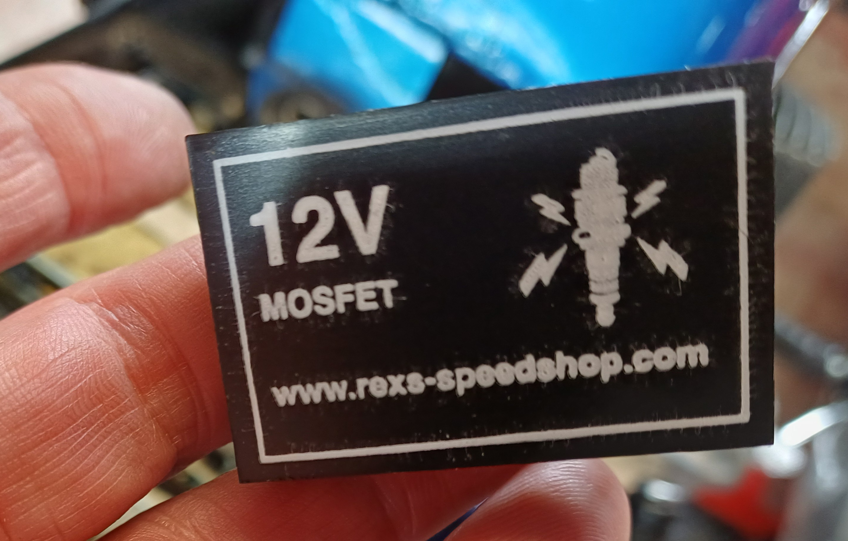

Stator,rotor,voltage regulator and rectifier all tested as per manual and found to be within spec. So,according to my reading of the magic meter everything is working fine and I should have 14 volts when the engine is revved.
The only problem is...I still get only 12 odd volts when blipping to 5k.
My tenuous grasp of sparkery tells me,since there is good output from the stator,then the voltage regulator maybe isn't allowing enough juice to the battery.
It's a mechanical regulator,so can be easily removed from it's case for examination. I fired up the bike with the reg casing off to see if there was any action between the little coil and the bi-metal contact. All looked good visually and I cleaned the contacts anyway,but not being entirely certain of what I should be seeing,it was all a bit inconclusive.
Eventually I bit the bullet and ordered a Mosfet solid state regulator. Plugged it in,fired up the bike and fuck my old boots I have a good 14 volts on the blip.
As an aside,during the testing process I had difficulty with my digital meter when the engine was running. There's no spark plug resistors,no suppressors and the old Mitsubishi cdi is mega electrically noisy. The digital display just fed me random,scolling numbers. Impossible to get an accurate reading.
I had a cheap analogue meter lying about,but it was cheap for a reason. It was shite. I bagged an old (1963) Avometer 8 mark 2 off the bay for not much money. It isn't a pocket model.....
