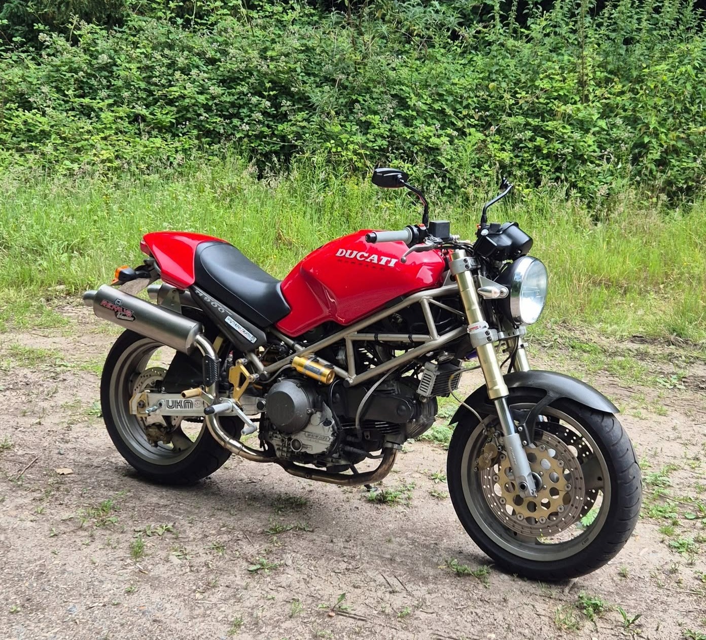

Re: Monster rustoration
Passed MOT this morning, no advisories
Went for ride, hmmm, not good, feels like tyre is flat except I know it's not as I pumped it up yesterday. Once up to speed it's ok but at low speeds not good.
Pop in to see Mr Weeks for coffee and catch up. While I'm there tighten up a couple of screws and remove steering damper, yup it's not just damping it's stiff as hell. Resume ride and it's back to how I remember it, light steering and flickable.
Really nice ride home the long way and it's great, revisiting an old friend, gradually getting back into the groove.
What's next? Take it places, visit sister in Dorset. Ponder improvements, more to come.
- Monster back on road 17.06.2026.jpg (778.8 KiB) Viewed 268 times
