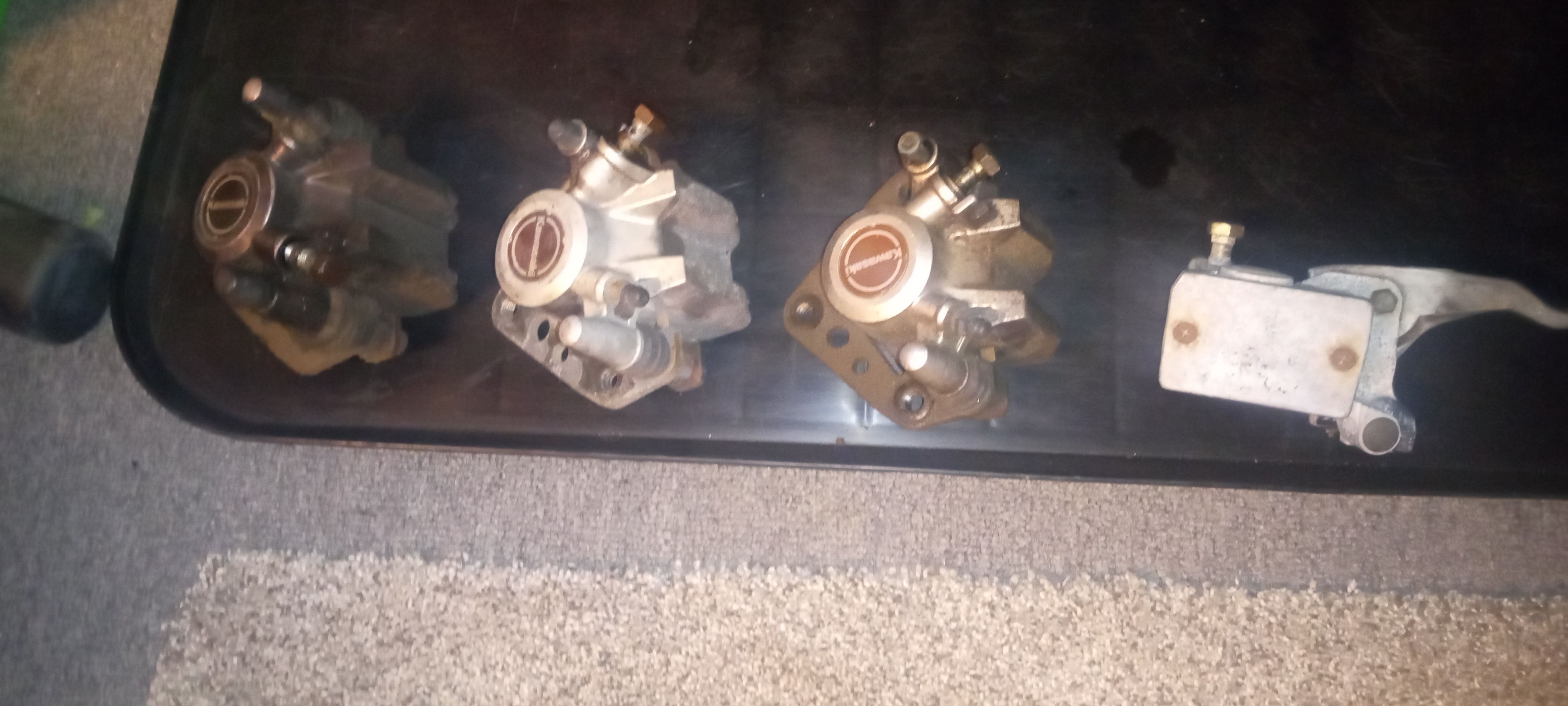

Visited the GPz, mate wasn't there but the bike was outside.. :think: so I pulled a sneaky ;) removed the three brake calipers & the m/c from the bars :hmmm: then left before he got back. :shhh:
Posts: 8984
Has thanked: 2271 times
Been thanked: 2654 times
Re: '83 GPz750-A1 malarkey.
Fresh pile of crap to overhaul/IRAN.
That front m/c might be toast, but will assess after it comes apart.

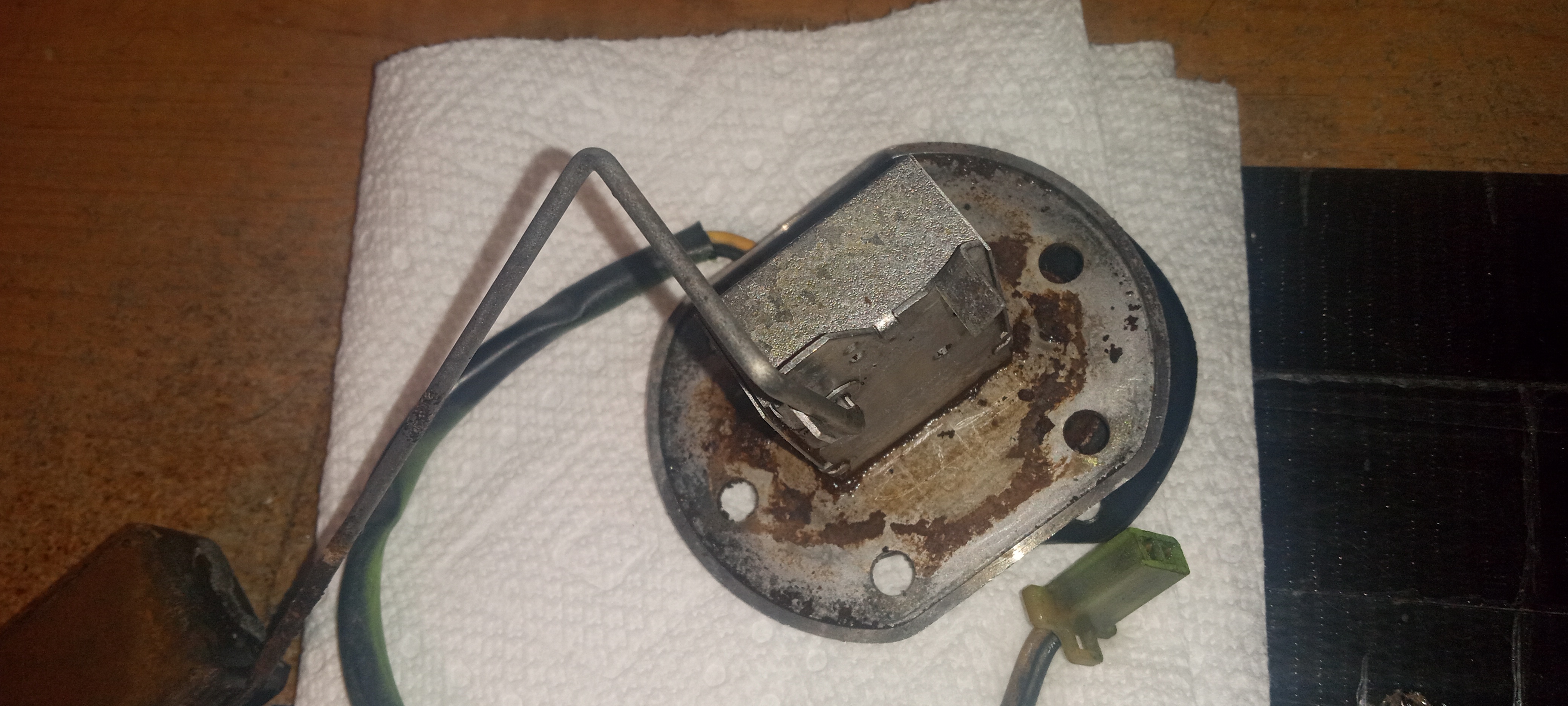

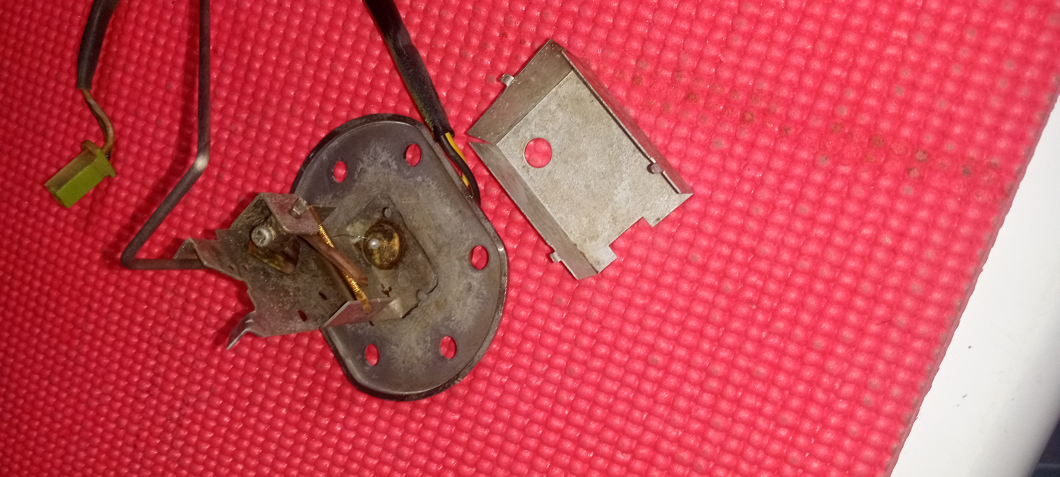

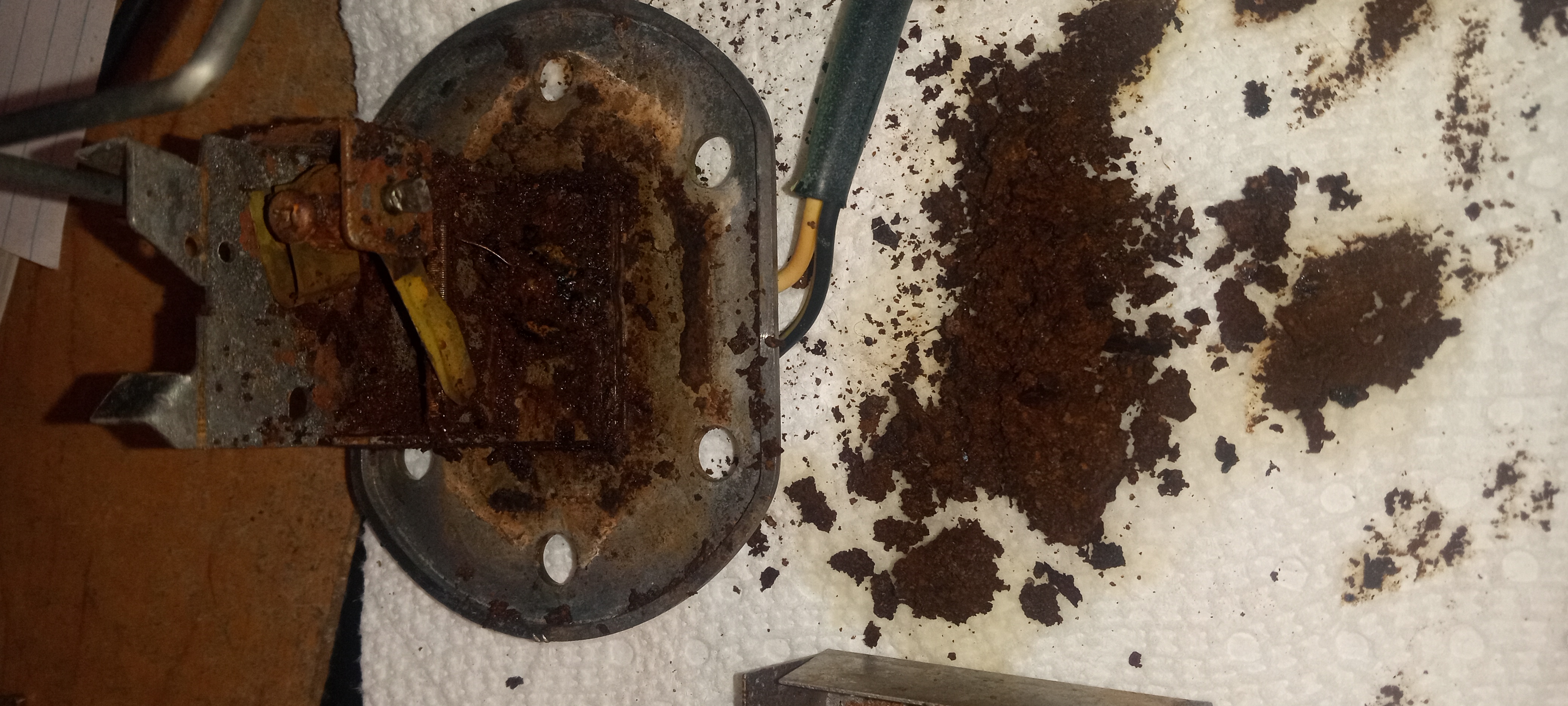

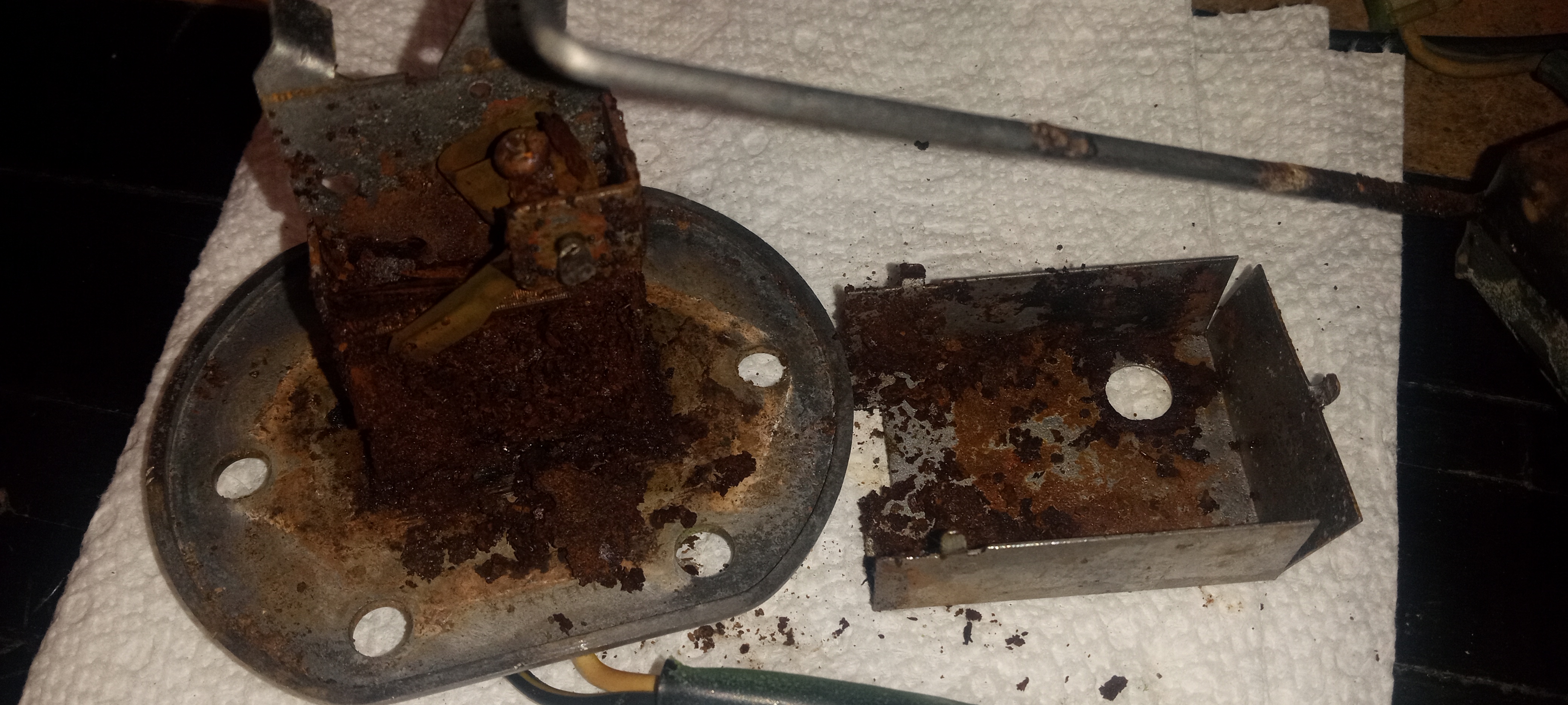

Initial soak in Evaporust didn't seem to be doing the job, so decided to pop the sender unit apart... :shock: :wtf:
ARRGGHH!!
It's now in the small ultrasonic with water, SG-HD & some Evaporust

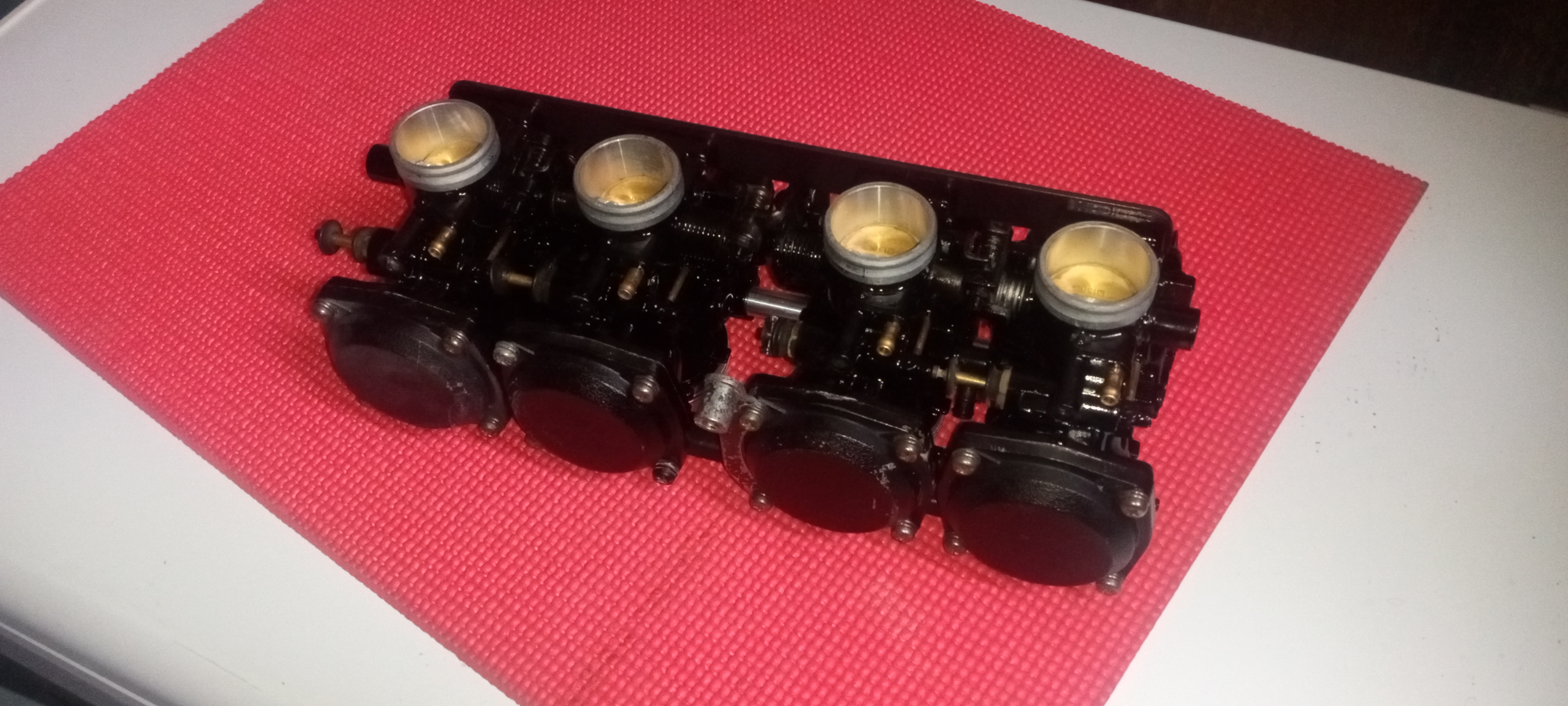

WooT!! Carb rack assembled... Tres spiffique
Still need to soda blast the throttle cable guide doodad (so it will come off again), fit the air screws & install the choke rod & associated gubbins.

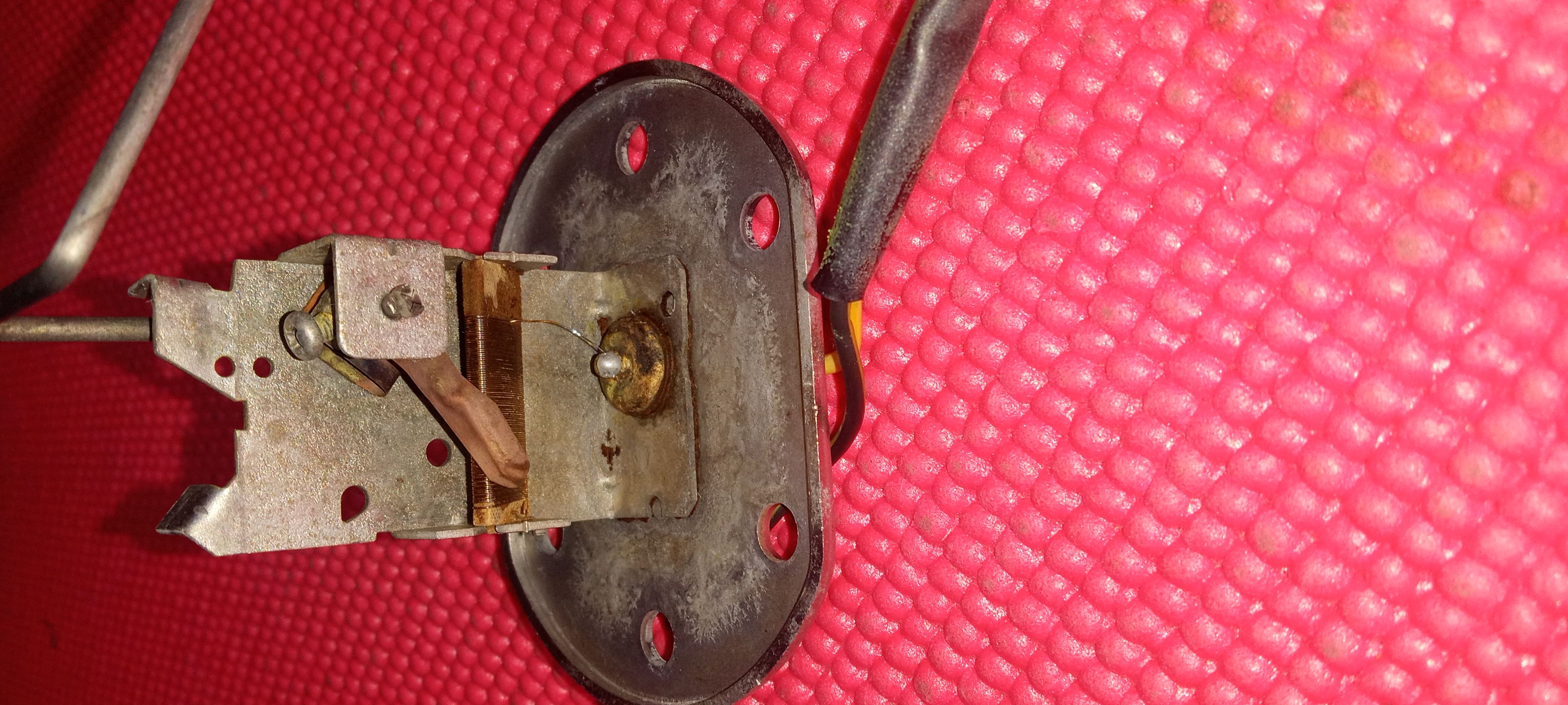

Sender unit is sorted.

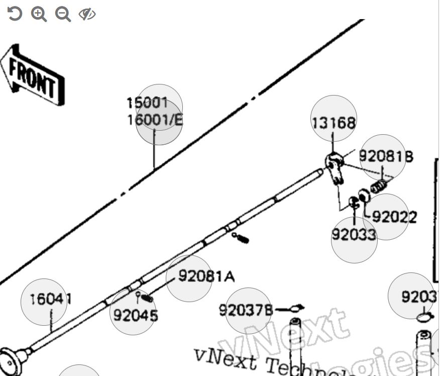

Finished up the carb assembly. There are two very small springs & matching 1/8in ball bearings that hold the choke rod in position. What a fucking faff they were... The hole they fit into is inside the tube the choke rod goes through and then there's faff of the doodads that pull on choke plunger doodads that have a spring, cup & a Ping!FuckIt!
and then throw in the fact that I have 3 different pairs of glasses depending on how close something I want to look at is...
I was starting to question my life choices...

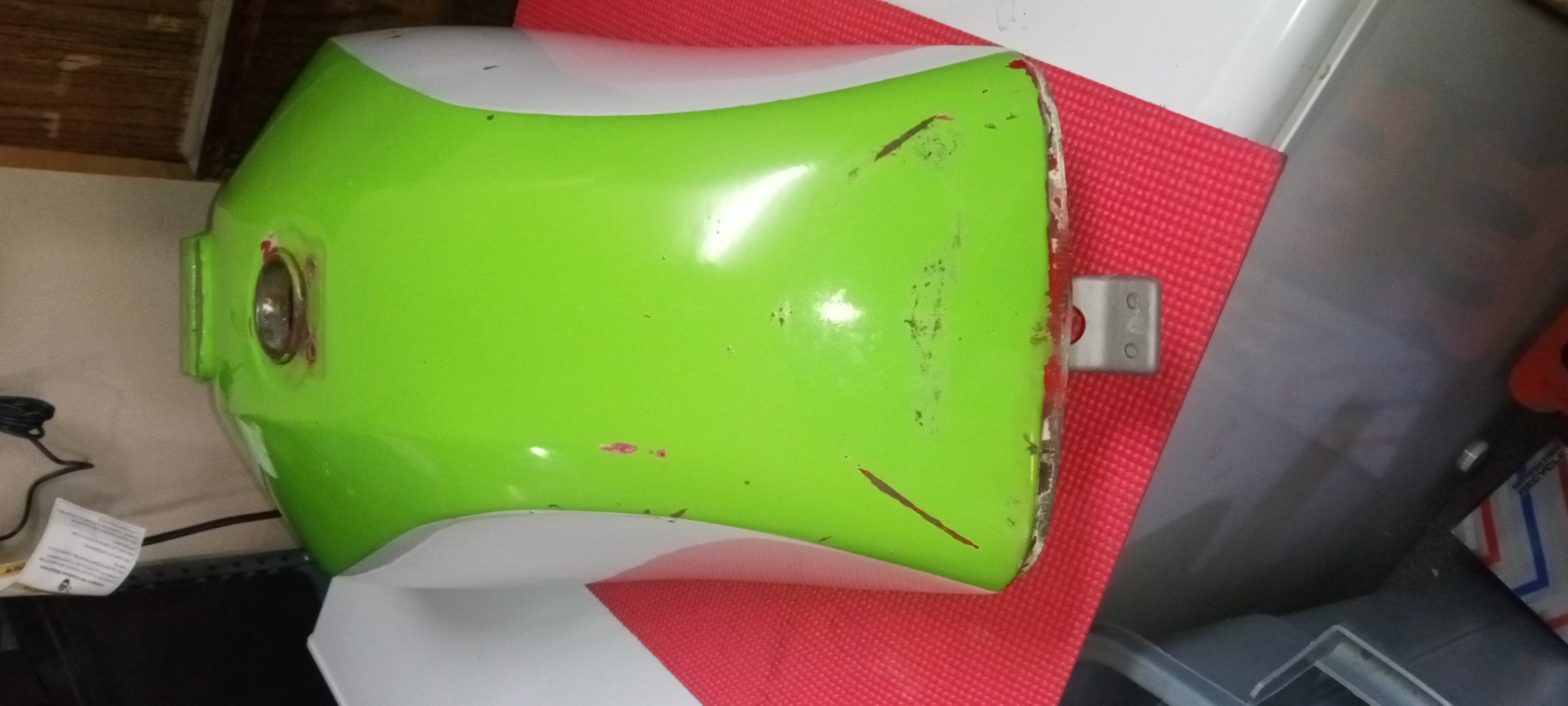

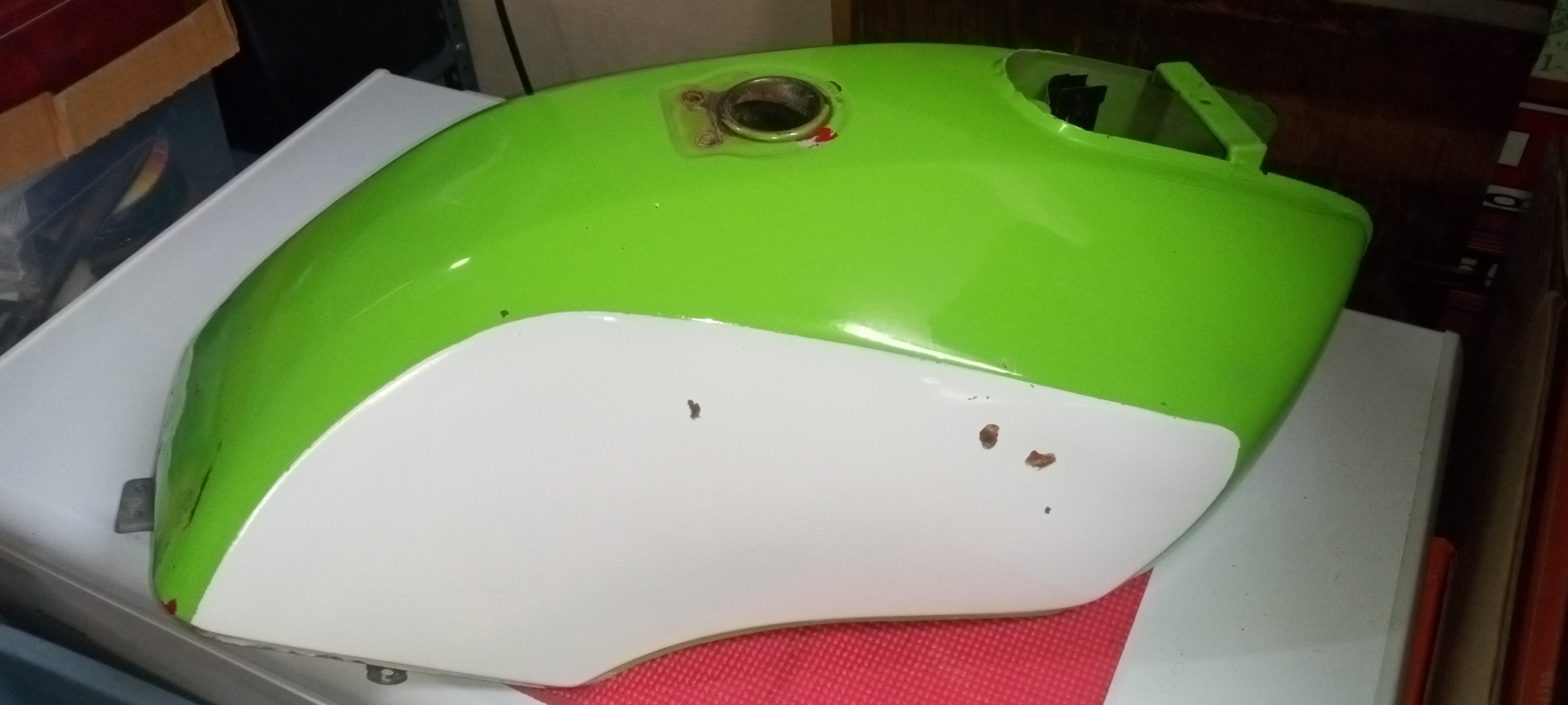

Decided to take some 1200wet/dry & the polisher/buffer to the gas tank to see how it looked... Total waste of time as it has terrible orange peel, scratches, crap quality paint & needs a total strip/repaint anyway.
But I would ride it like this...

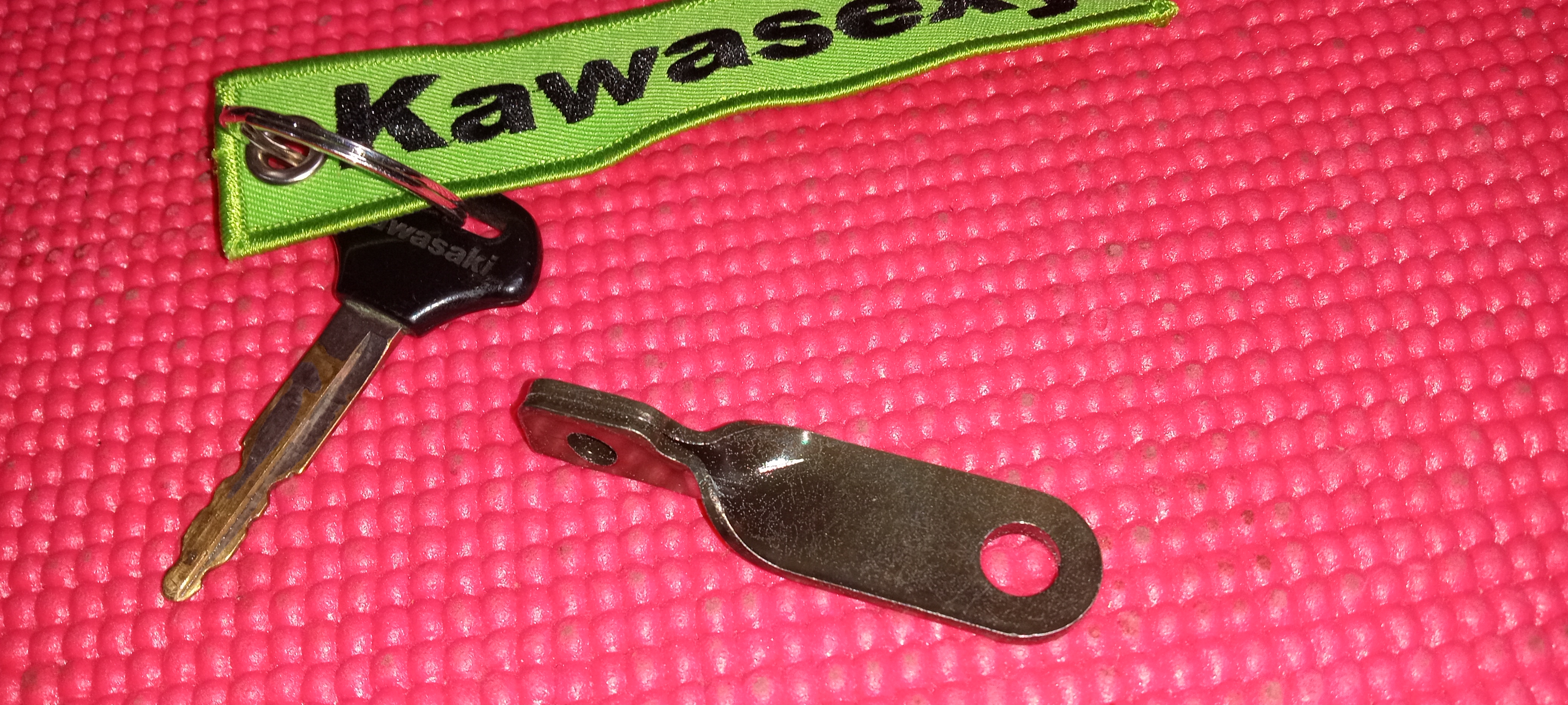

Kickstand doodad arrived.... $80.04 FFS
