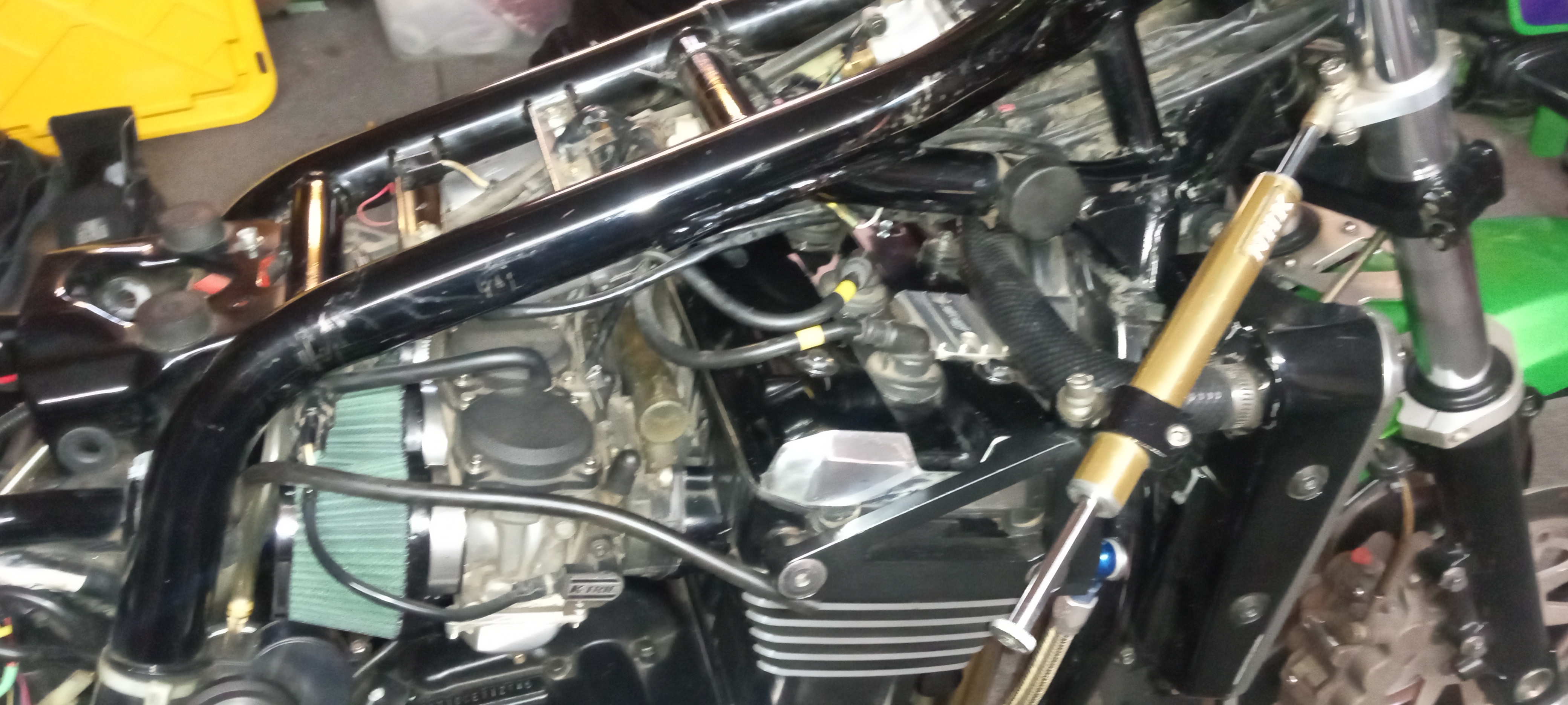

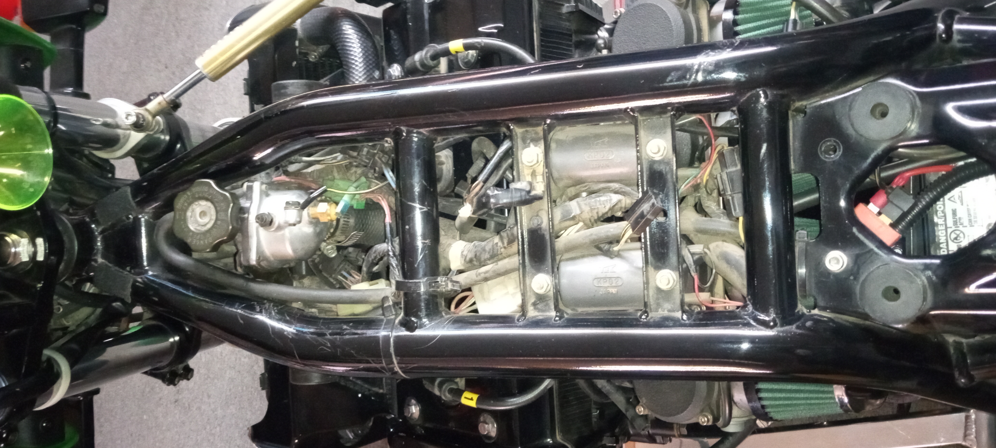

Investigated coolant leak on ZRX11... no bloody sign of a leak anywhere, even after pressurizing the system (which was full) etm. Put it back together.
Not looking too shabby under the tank for a 27yo bike...

Re: '95 ZX11-D3 & '99 ZRX11-C3 stuff
That's minty, you'd have to be seriously fastidious to have it looking like that after 27 years in the UK

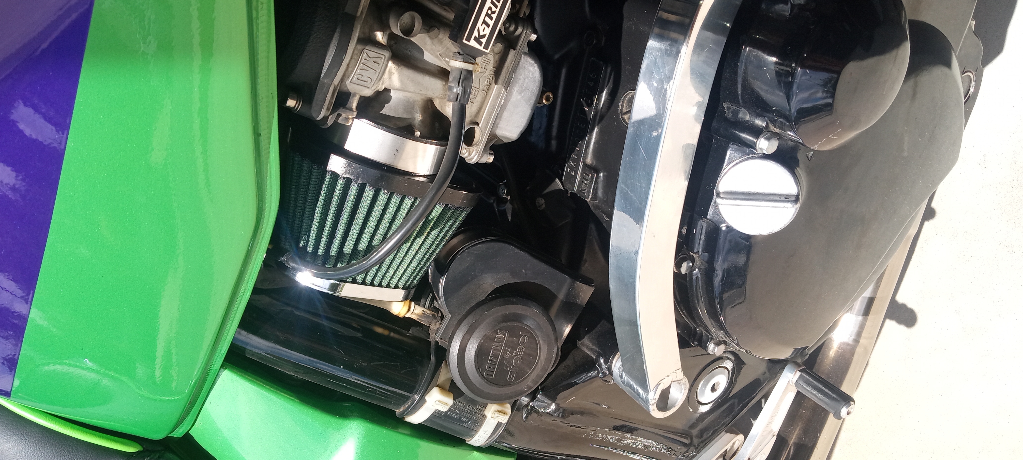

Bizarre issue with the ZRX11 last night. Bike was on reserve as it was low of fuel. Went to the local bike night, gassed up on the way there. Bike was acting like it was drowning in fuel, strong smell, but only at idle.
Once it got moving it cleared it's throat & ran normally.
Went to leave the bike meet, it wouldn't start, Not turning over...for a moment I thought it had hydrauliced. Faffed about & it fired up, still acting like it was drowning in fuel.
Half way home I realized it was still on reserve so turned the tap to *on* & after that it ran just fine & the smell of fuel went away.
Having a brain fart here trying to work out why it would only run rich on reserve...

Arsebiscuits, oil level is definitely higher, so there's gas in the crankcase.. & I just did a fucking oil change, so that's $60 down the crapper.

Mystery solved, Fuel tap isn't shutting off & #3 Carb is pissing fuel.
