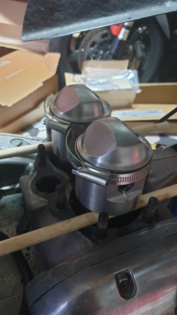

Pistons back on. Its a long old stroke motor is this...
Before sticking them back in I had to check the piston/bore clearances. On paper I shouldn't need to, but I've learned with this old bike that the paper values don't count for much!
Unfortunately it's not as simple as it once would have been. In my old job we were fully vertically integrated, meaning that we did everything from initial design to customer delivery. The upshot of that was a massive metrology cupboard chock full of all the micrometers you can shake a calibrated stick at.
In my new job we do all the engineering ourselves and we do all the assembly ourselves, but most of the actual metal bashing is done out of house due to higher volumes. This mean far less measurey stuff knocking about. I was able to blag a micrometer big enough to measure the pistons accuratey, but we don't have a bore mic that goes up to the necessary 2.8 something inches.
So I came home today with some accurate piston sizes and I had to assume the bores were cock on 40 thou over stock size. Making that assumption, the piston/bore clearance is a tiny smidge over 0.005" - which is about perfect. I also realised on the way home I have more than one set of feeler gauges, so I could do a second test. If I put the piston in the bore and insert a 4 thou gauge on one side I can get a 1 thou gauge between the piston and bore on the other side, but a 2 thou is a bit tight. So that means the piston/bore clearance is over 5 thou but less than 6
TL:DR - the pistons are the right size

Cylinders back on tonight.
I first had to go to B&Q to get the official Triumph ring compressors and piston alignment tools.
After that it was just a case of making sure the gaskets were in place, the cams had a nice dose of assembly lube and away you go. I was expecting to need 2 or 3 stabs to get everything together but it just slid on like butter first go!
I was actually a bit suspicious of how easy it was, but I figure if the rings or pistons are on the piss it would be HARDER to get it together.
Putting it 4th gear and spinning the rear wheel shows that everything moves nice and smoothly. There's gentle 'sssshhhhhhpppp' sound as the pistons come up and then a properly steam train 'chuff' as they go back down. The two pistons move together so the crankcase gets pressurised as they go down.
