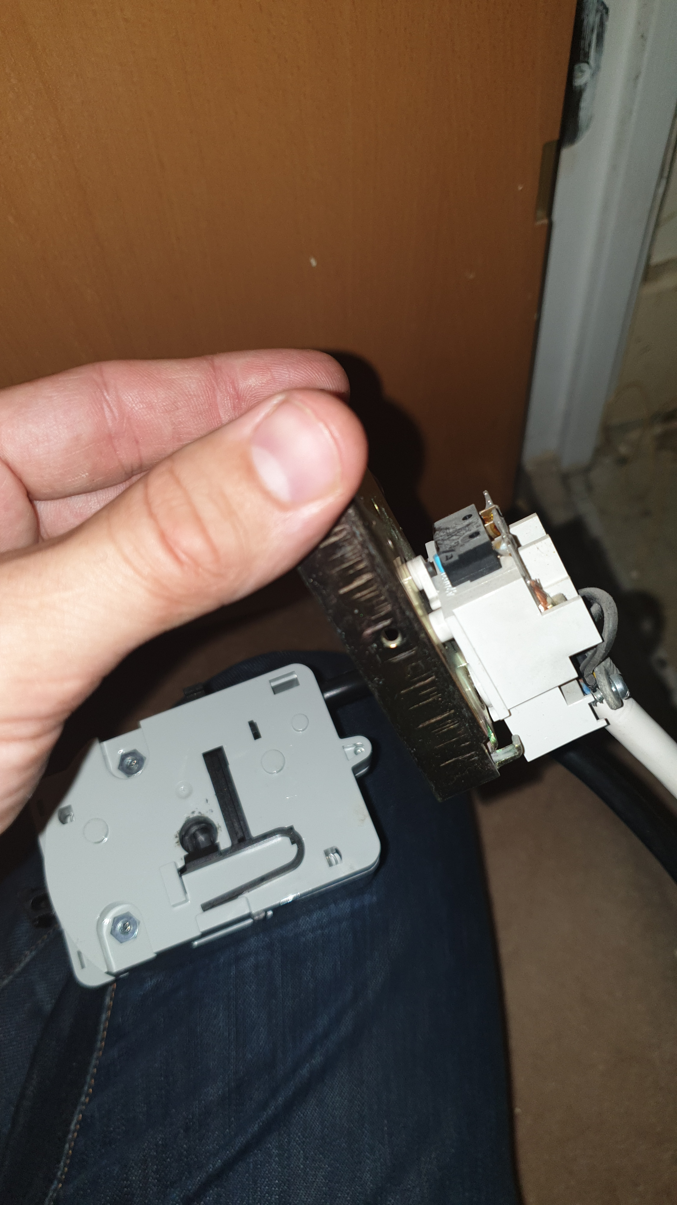

So I think i get how it works now, thanks to Doc's insight.
The thermostat has little microswitch in it (the little black box). That switch is actuated by a bimetallic strip which sits against the tank. By manually actuating that switch i can make the system open/shut the circuit valve (the grey box sat on my knee) and turn the main pump/on off.
I have a double problem in that the mechanical aspect of the valve is stiff so the actuator struggles to move it.
The adjuster in the stat is broken inside, so the bimetallic strip never turns the microswitch off and the tank just calls for hot water all the time. I have never touched this stat before in my life so fuck knows how it broke.
So yeah...broken stat! Every day is a school day.
The bit I don't quite get is why it would never turn off before even when the timer said it should be off. Did it just get stuck on waiting for a switch off signal that would never come?

If the mechanical part of the zone valve is stiff, waggling it open and closed with a pair of pliers might help to free it off. If the servo motor can't physically close the valve, the circuit will continue to call for heat from the boiler. It can also burn out the servo motor!
Re: Hot Water Timers
Servo motor is brand new. I was wrong about the valves BTW, its the other two circuits which have brand new valves. This is the only original one left in the system.
At the moment I've got the valve fully open and the servo on the floor next to it. I have just turned the stat over and the boiler comes on, turning it the other way up turns everything off again (literally gravity moving the switch) The man is coming on Weds...It's not gonna die like that is it?
