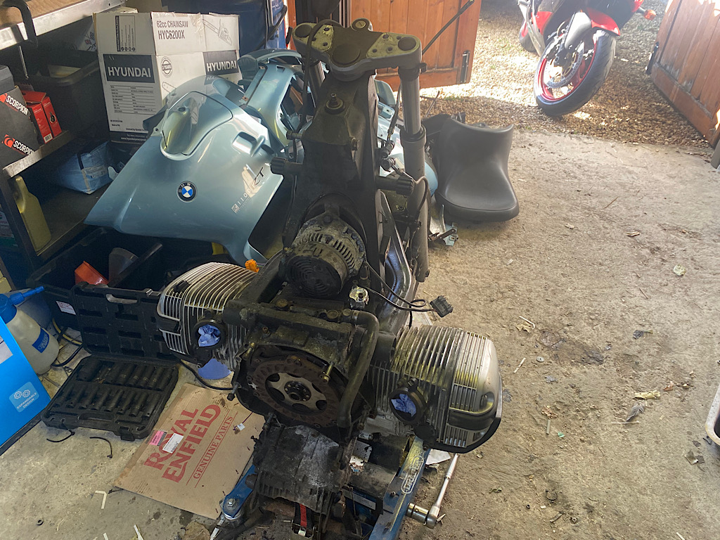

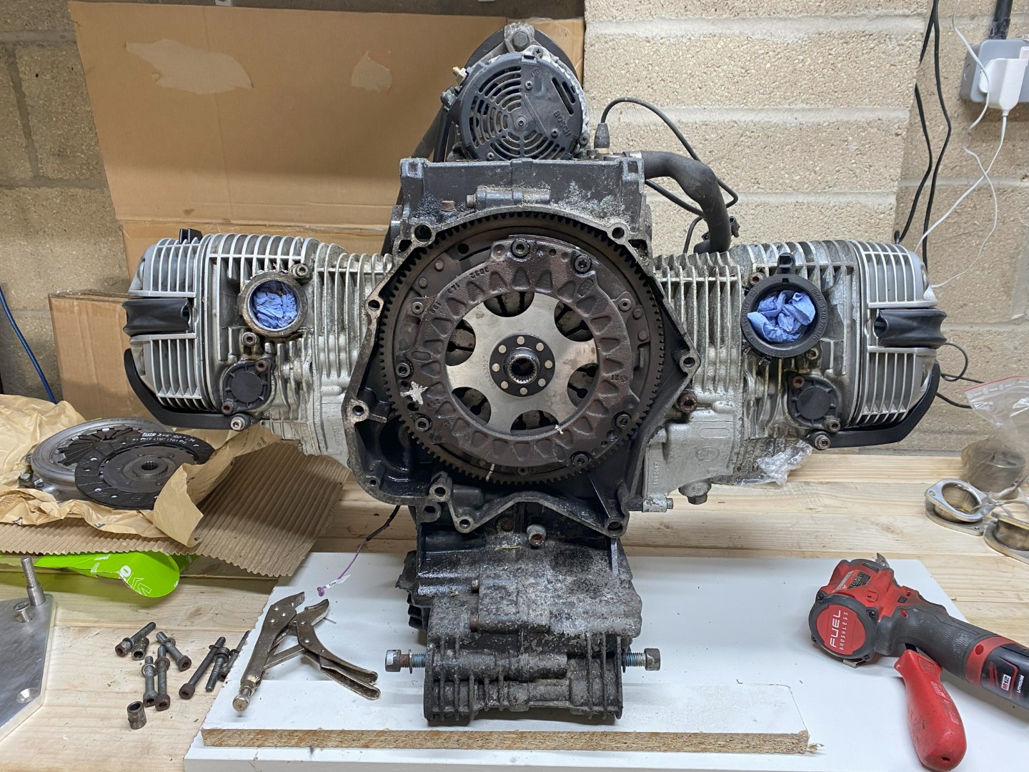

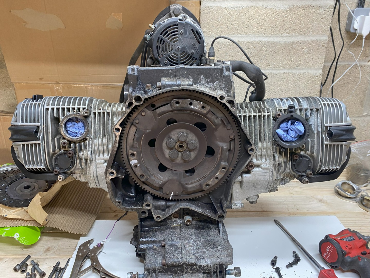

More work done over the last few days. First images are the removal of the bmw clutch and flywheel...

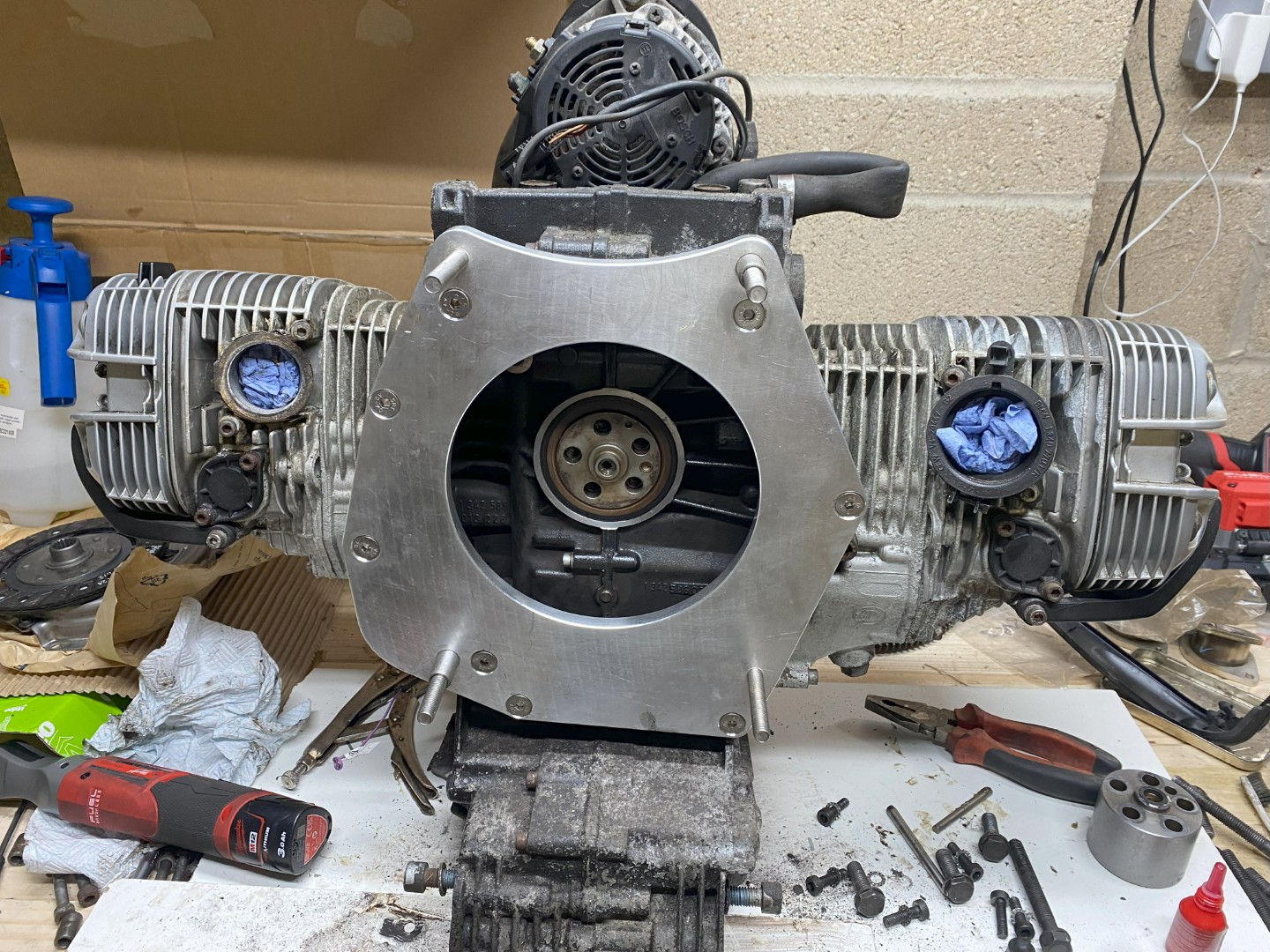

Then the gearbox adapter, crank adapter, modified 2cv flywheel and 2cv clutch are fitted...

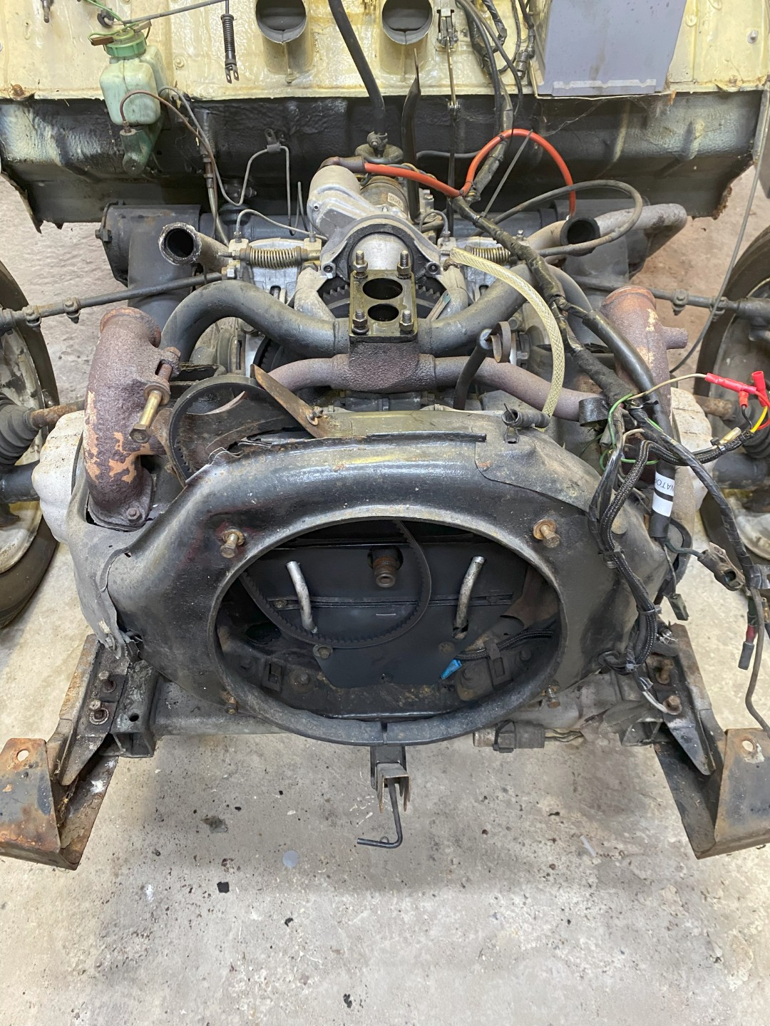

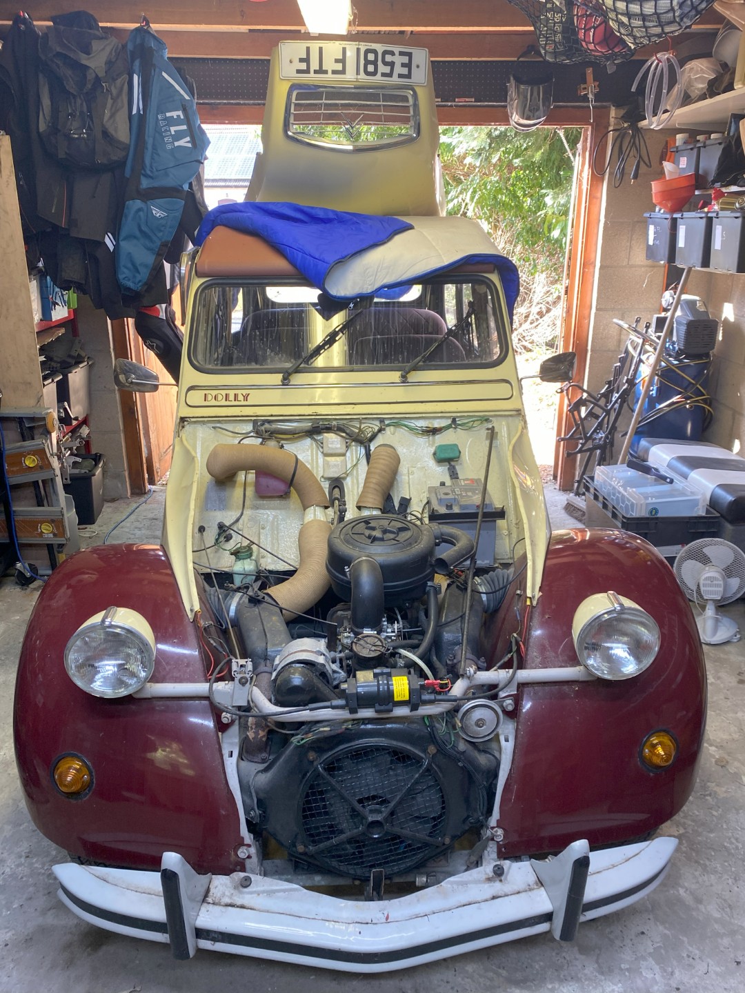

Start to remove some bodywork to give better access...

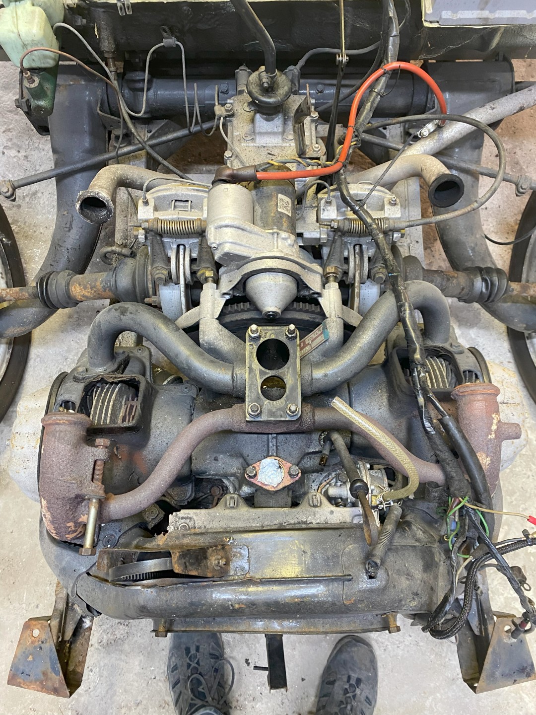

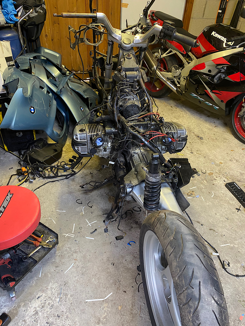

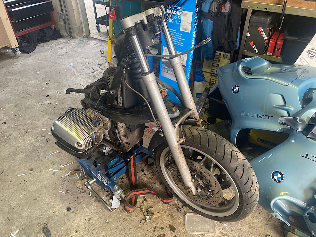

Finally for today some other bits are removed. Next step is to pull the engine. The gearbox has to come out for a small modification too.

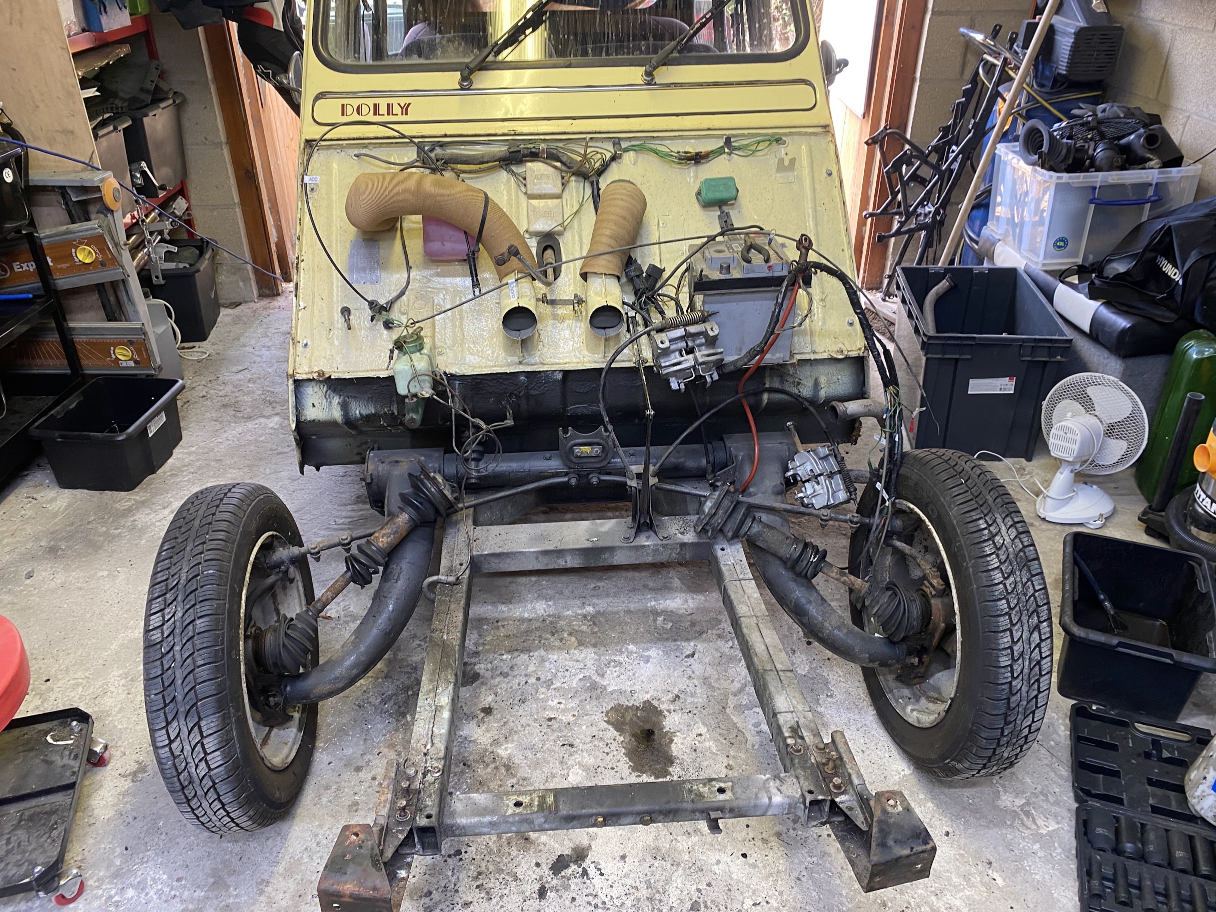

Dry run fitting the gearbox to the engine and the engine bay ready to accept them both.
I have to pause now while I wait for a part for the gearbox that's broken. Next step is to get the engine and gearbox in place in the car so I can make some engine mounts and start to plan the exhaust.

Chassis looks in good nick, is it a replacement galvo one?
dern
Posts: 2535
Has thanked: 1179 times
Been thanked: 2275 times
Re: 2CV6 Project Thread
Post by dern »
KungFooBob wrote: Sat Jul 12, 2025 11:51 am Chassis looks in good nick, is it a replacement galvo one?
Yes. Also helped by the oil leak.
