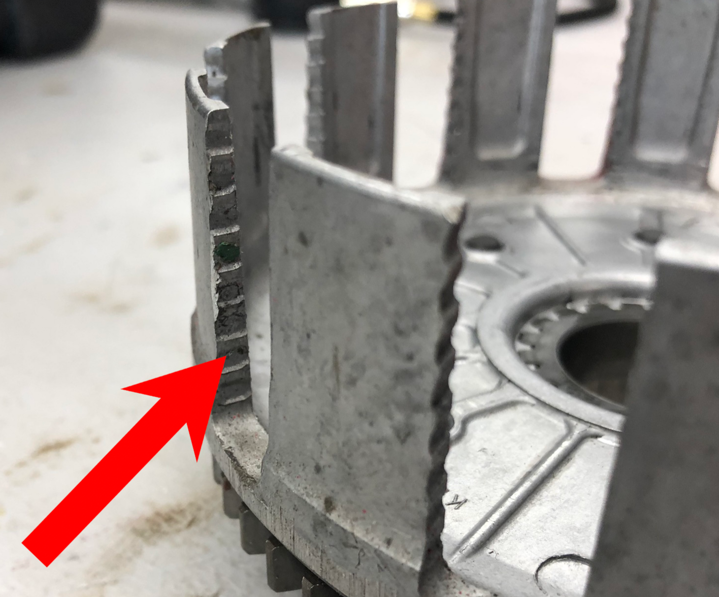

Check these too!

Sadlonelygit wrote: Wed Aug 14, 2024 5:26 pm Check these too!
Out of curiosity, what are "these"?

Beancounter wrote: Thu Aug 15, 2024 11:40 am
to my mind.... (and obviously I'm possibly completely wrong), that photo is of a completely knackered clutch basket: the notches worn into the gates will prevent the plates moving apart: the edges of the gates should be flat, not ridged.
unless of course I'm completely wrong, and the notches are there to hold the plates firmly together when under load?
Like I say - I'm not that up on the mechanical cleverness of modern clutches.

Yup, notches caused by vibrating plates, it's mainly a problem on dry clutches... Like older sporty Ducatis.
If a Ducati sounds like a bag of nails at a standstill it's got a dry clutch.
That's the bit of your outer clutch basket that the friction plates slide along.
Smooth is good, picture shows a fubar'd basket

Outer clutch basket is fine, no notches.
Friction plate standard is 2.8mm, service limit is 2.6mm. All of our friction plates are between 2.3mm and 2.5mm.
The only place I can find just friction plates is eBay and whilst they're cheap at £90 they are unbranded and from China so will take a few weeks to get here. Seems like false economy so looks like £230 from the Ducati dealer.
