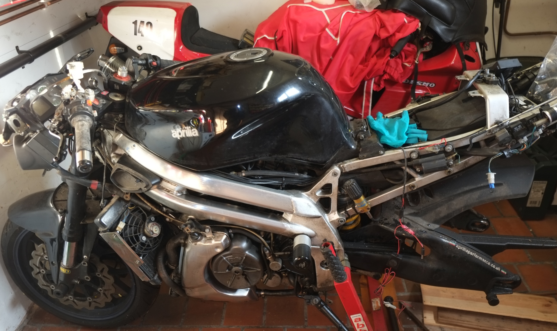

I'm flip-flopping between the LC and the new (to me) Falco at the moment. Today was the turn of the Falco. One of the main things I need to do is to rid the wiring loom of all the add-on tat the PO festooned the bike with. To do this I need to get to the bones of the bike so today was initially about removing the rest of the body panels - lower fairing, side panels, top fairing and circular wind deflector that sits under the bottom fork yoke and is a twat to remove, as was the top fairing. Here's the bike minus bodywork (with an 888 SP3 lurking in the background.) :
Eventually all the bits were off, then it was time to remove the Ohlins steering damper. This was situated in the hardest to get at place of all - bolted to the frame by the bottom yoke and to the RH fork leg. As with a number of other bolts on the bike, they seem to have been partially rounded off, probably by over zealous use of a twelve point socket. The steering damper will be for sale once I get a round tuit. Falcos don't need steering dampers.

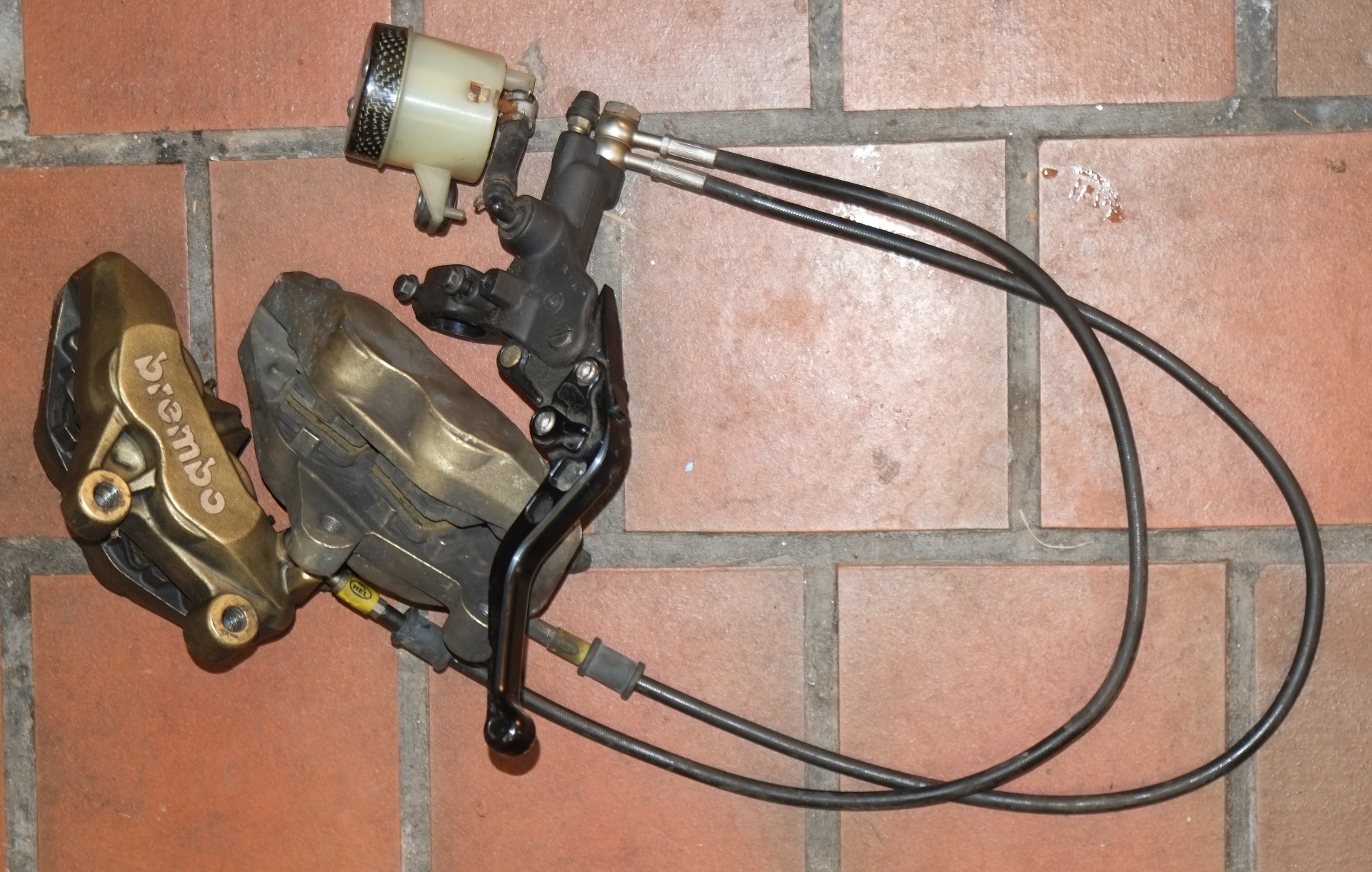

Next the front brake was removed as a complete system (the only way to avoid brake fluid getting all over the place, in my view). On the bike this felt horribly spongey and looks like it needs a good stripdown, possible new seals and definitely new fluid. Like the rest of the bike, the brakes don't look like they've received any attention in the last decade. Here they are liberated from the bike:

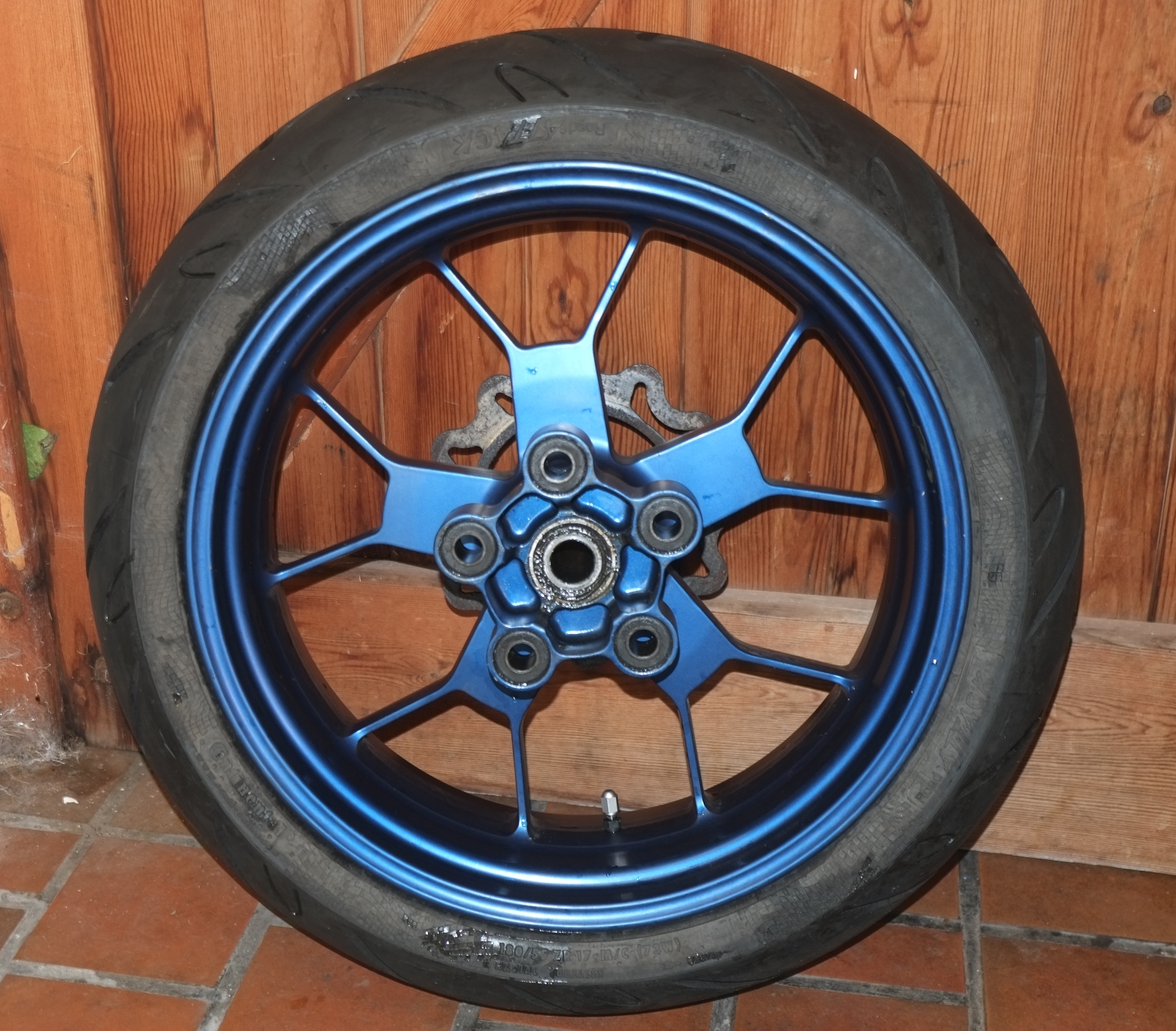

The last job of the day was the one I'd been dreading; getting God knows how many years worth of Scottoil and road grime off the rear wheel, sprocket and carrier. It was a case of nitrile gloves on, a reasonably stiff brush, Jizer and elbow grease. I can't pretend it was fun. I was disturbing layer on layer of filth, and it was clinging on tenaciously to the wheel. Eventually I got to the point where a) I'd had enough and b) I was running out of Jizer so it was time to wash all the unpleasantness off with lots of hot soapy water. Once it had dried off a bit this was the end result:
It's not proper © WeeksyClean™, but it's way better than what it was. I will go over it again with Jizer to clean off the bits I missed this time round and then it will be treated to some polish for the first time in well over a decade. And as it happens, Mrs Mango will be working in the office for the next few days, so I will have the full run of the kitchen. This could work very well, or could go horribly wrong...

That's a nice colour for a rim. Didn't imagine it'd be that good.
