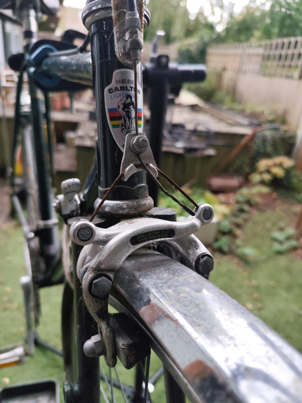

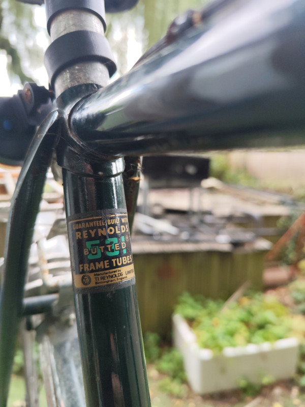

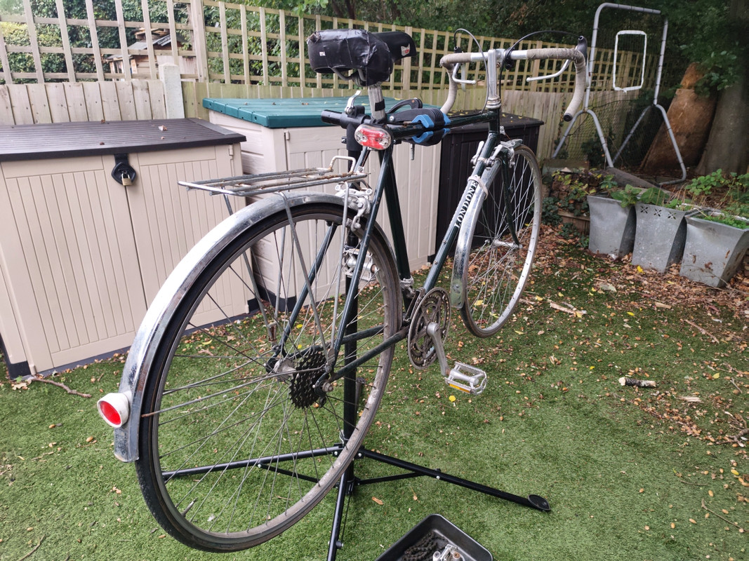

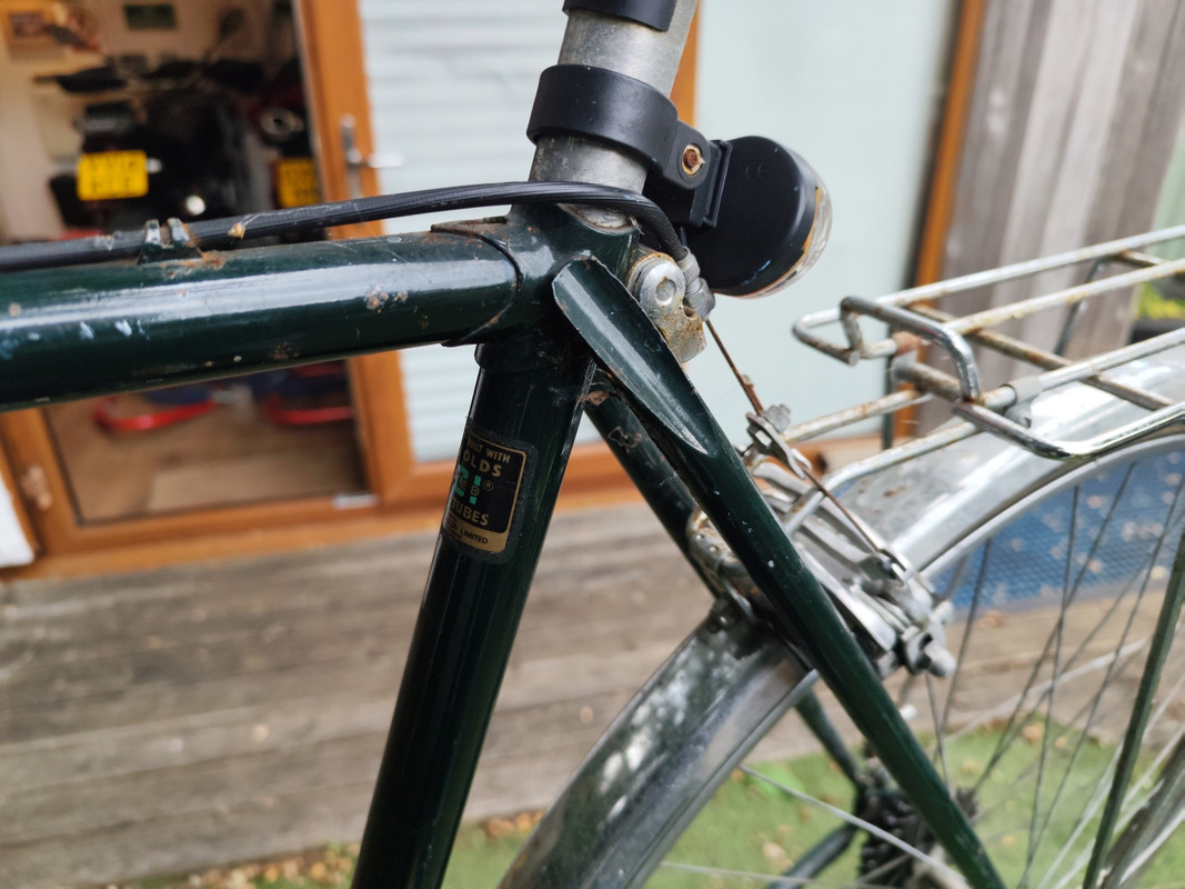

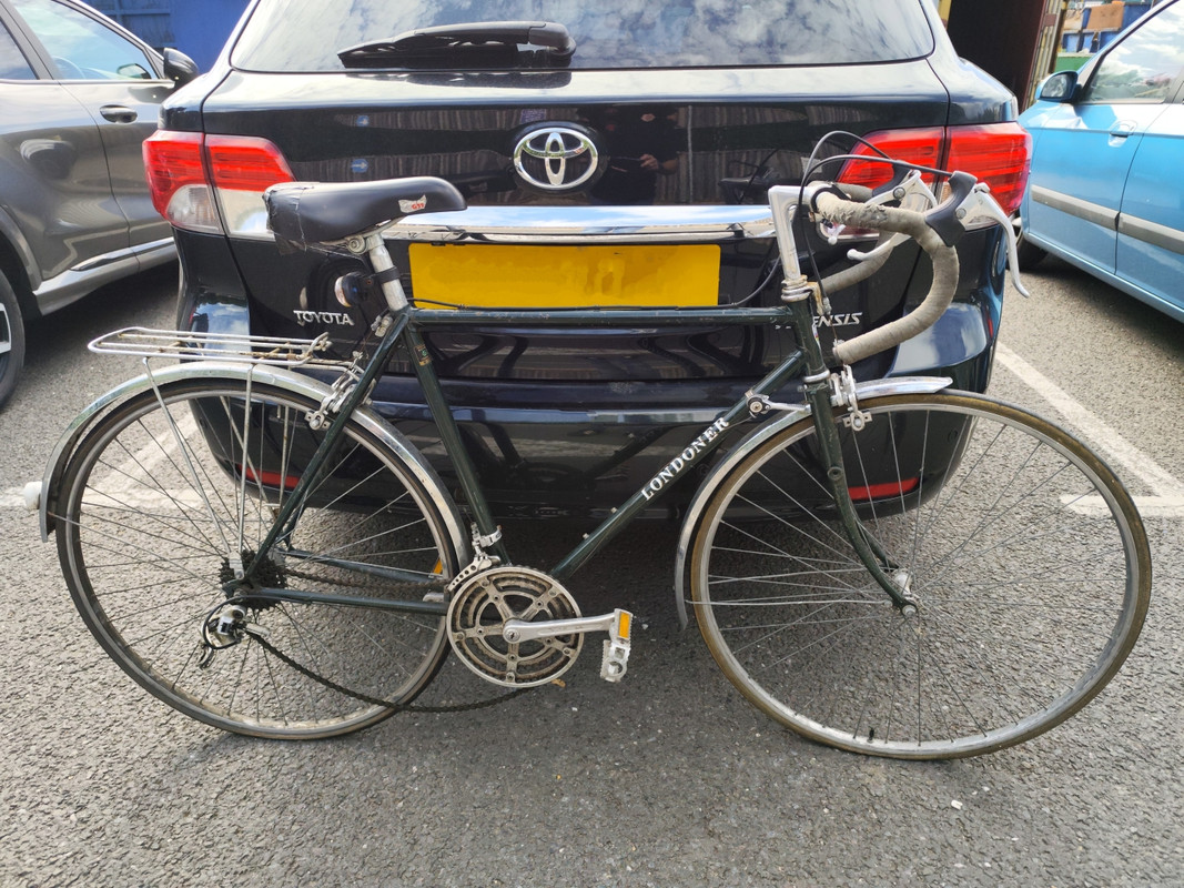

Picked this up at the tip the other week, the 531 tubing label caught my eye and upon closer inspection is looked to be a potential project. £20 changed hands and I dragged it to the car.

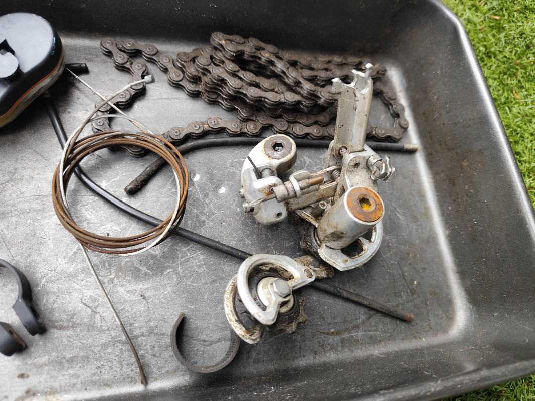

Tyres/tubes shot, chain and rear mech need replacing along with all cables. The rest of it looks like it could be cleaned up.

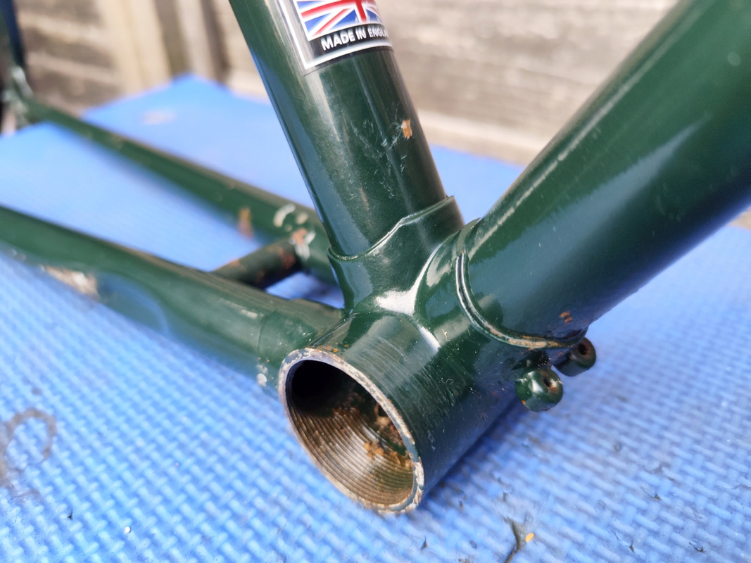

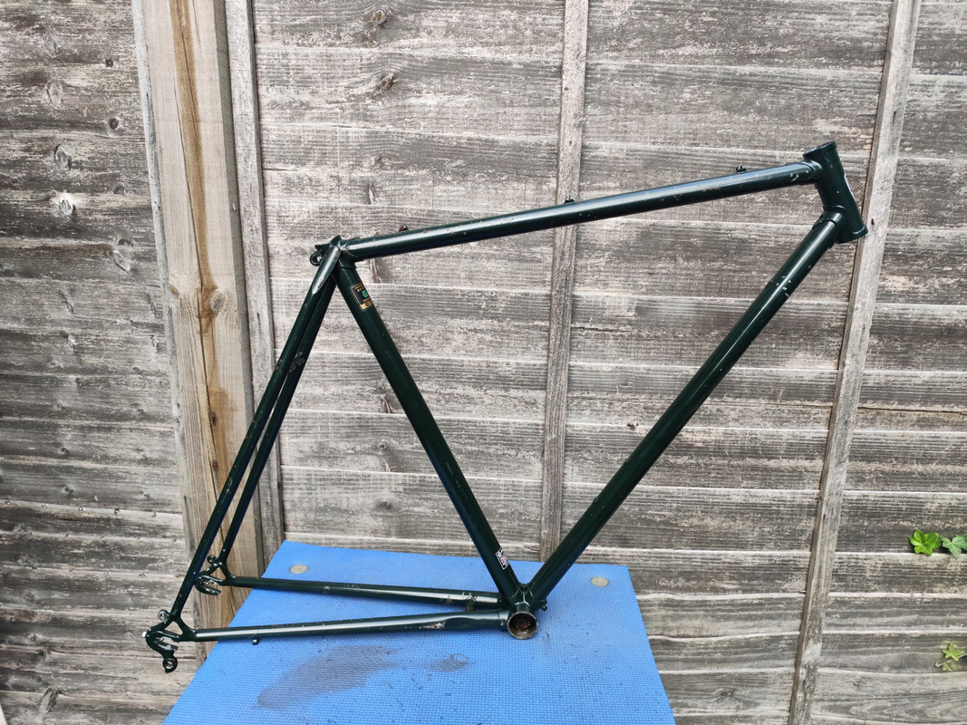

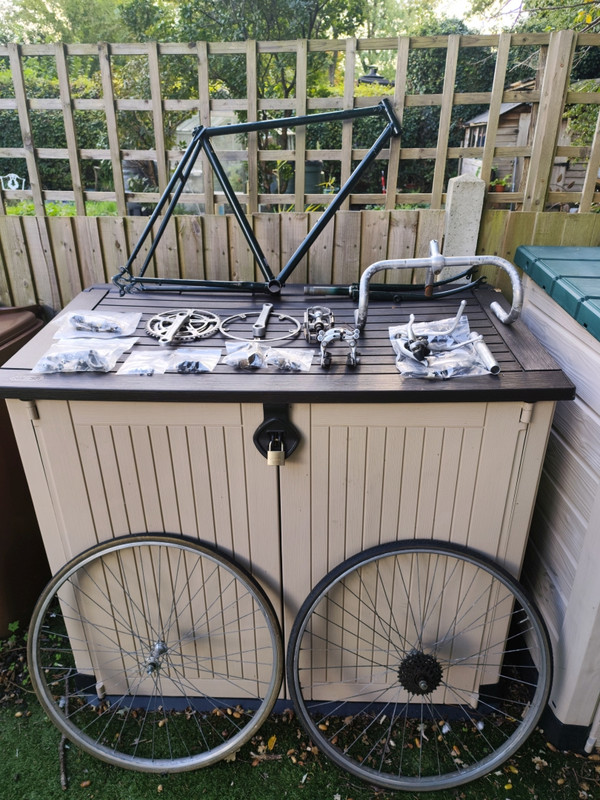

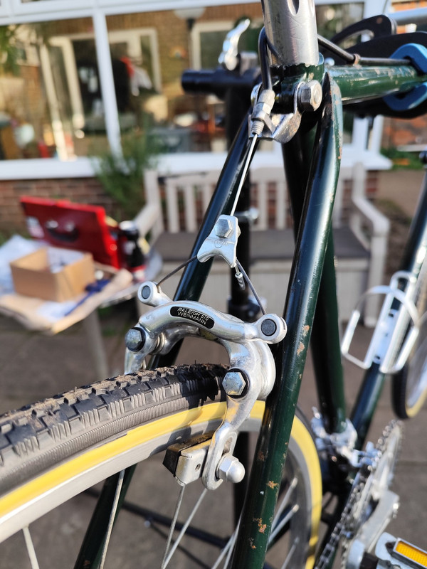

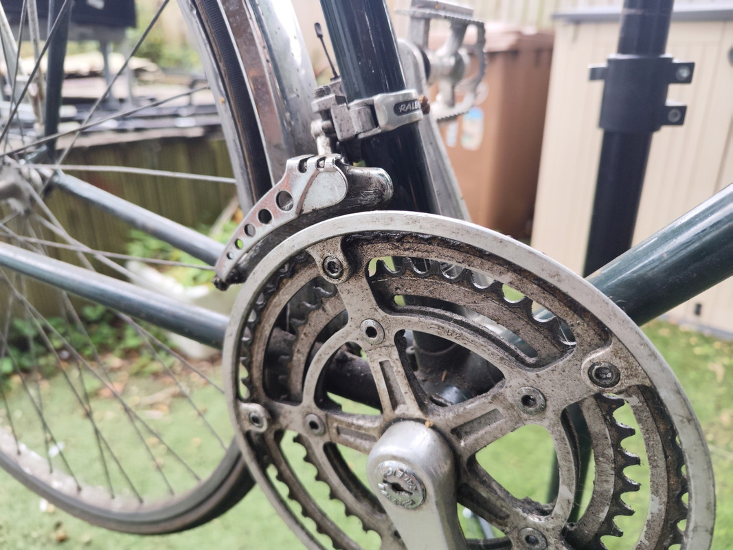

Stripped it down to a bare frame and began cleaning components to determine what needed replacing and what could be serviced.

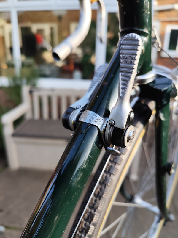

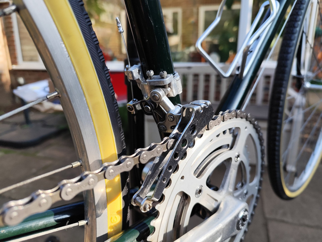

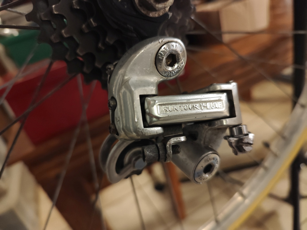

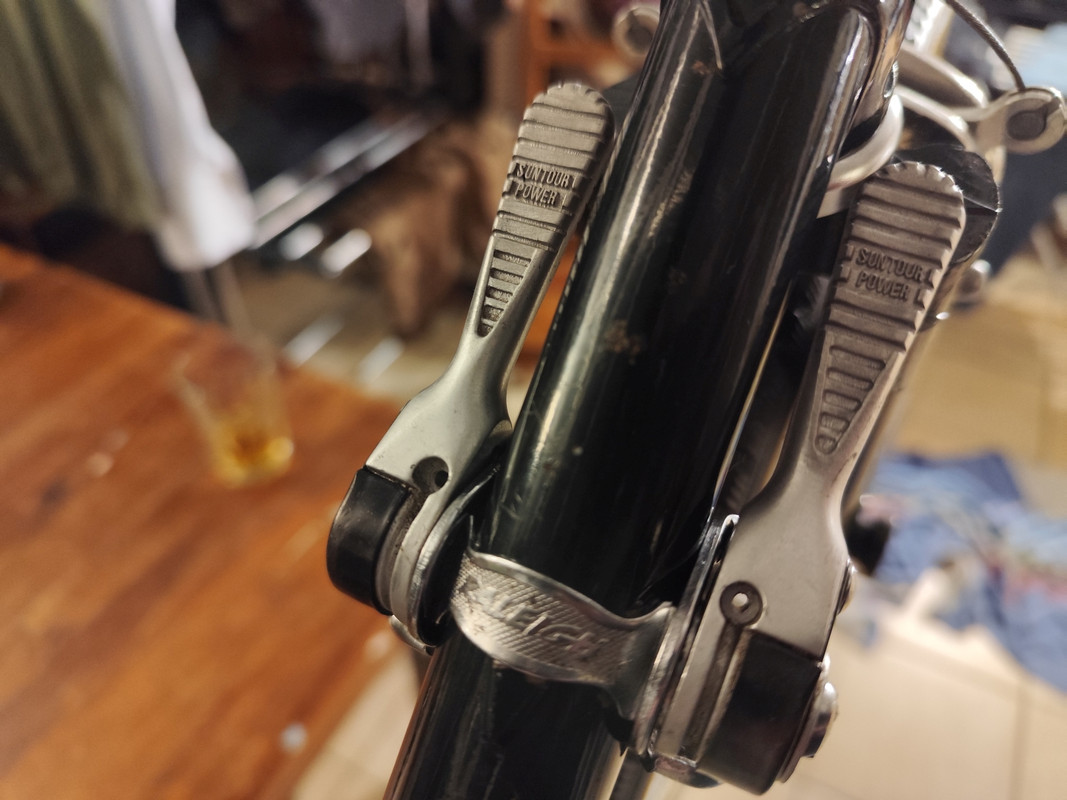

Rear derailleur had snapped, front was okay. Brake levers were serviceable, but I had the safety levers, centre pull brake callipers were in decent condition.

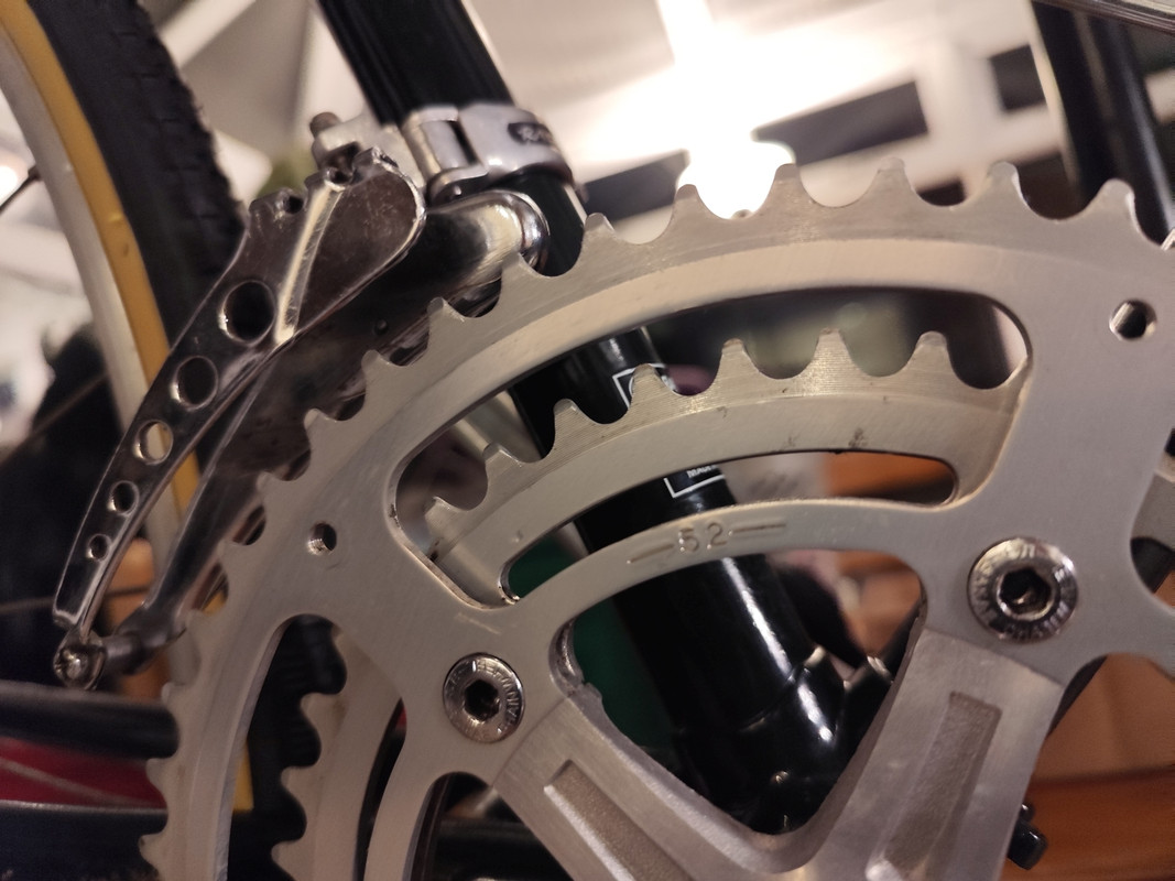

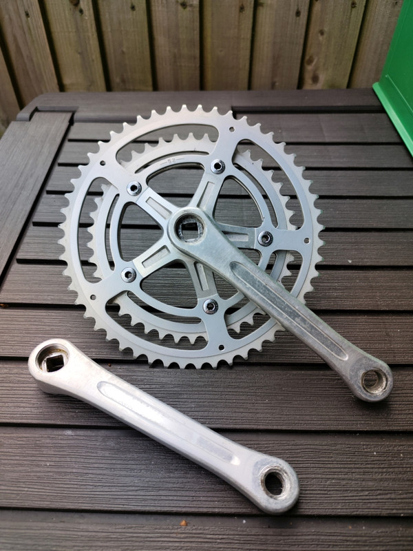

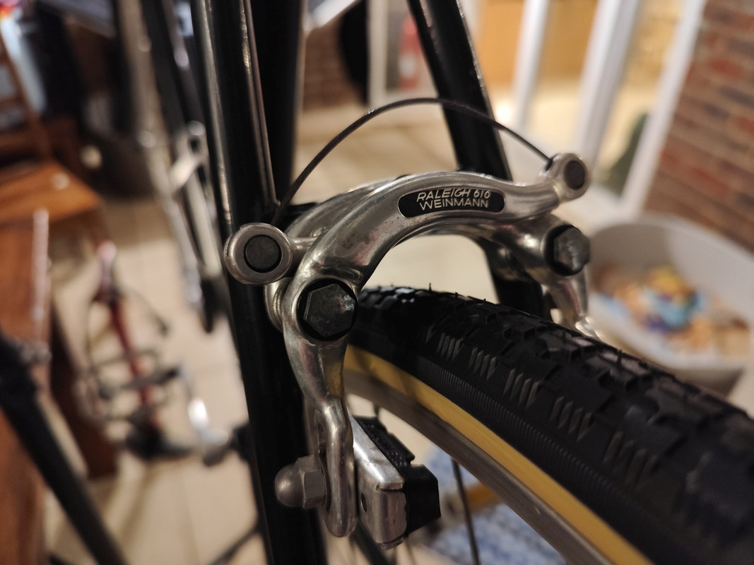

So according to the frame number it's a 1973 and made in Worksop. Raleigh and Carlton sold the same model under their own brand for a while, but the 'Londoner' moniker related back to old 1920's models. I'm still trying to work out exactly what model this is. Brakes are Weinmann, but badged as Raleigh. Gears are Suntour, but again badged as Raleigh. Crankset is an SR Sakae, again rebadged as Raleigh.

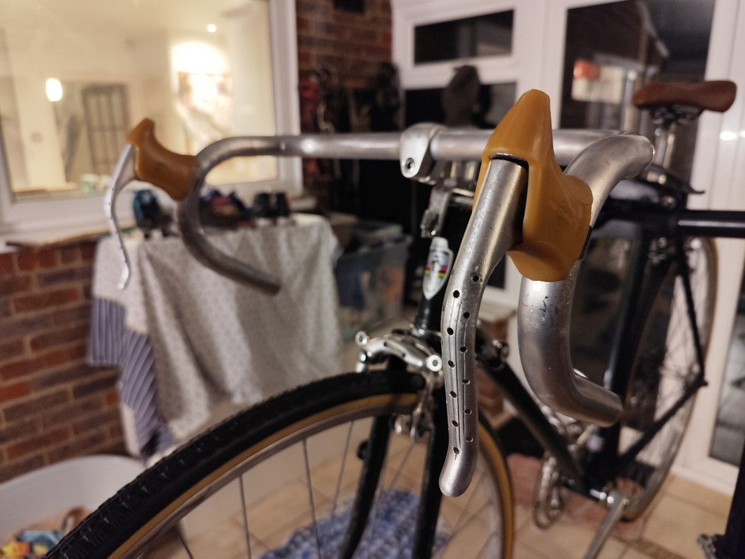

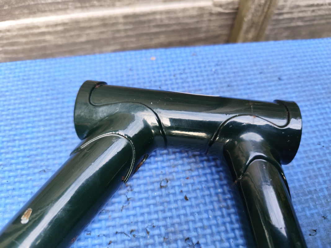

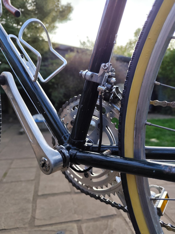

Everything that is being reused cleaned up pretty nice with just Muc Off, brake cleaners and a good scrub. I could have used the ultrasonic tank, but I don't want it gleaming. There are some lovely old details on the frame, brazed lugs and nice cable routing. I've washed and cleaned the frame, but will leave the surface rust.

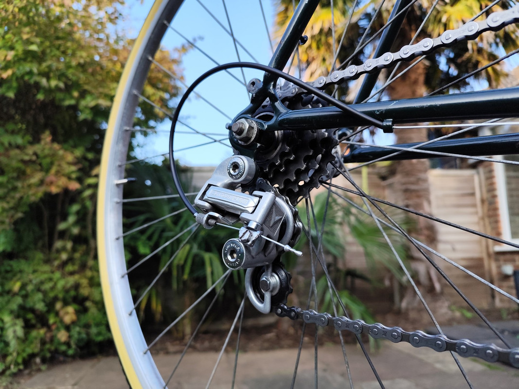

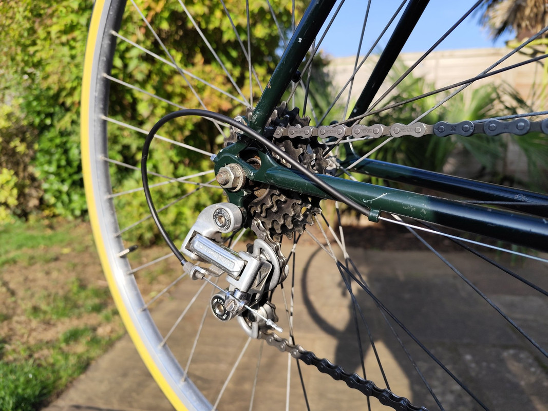

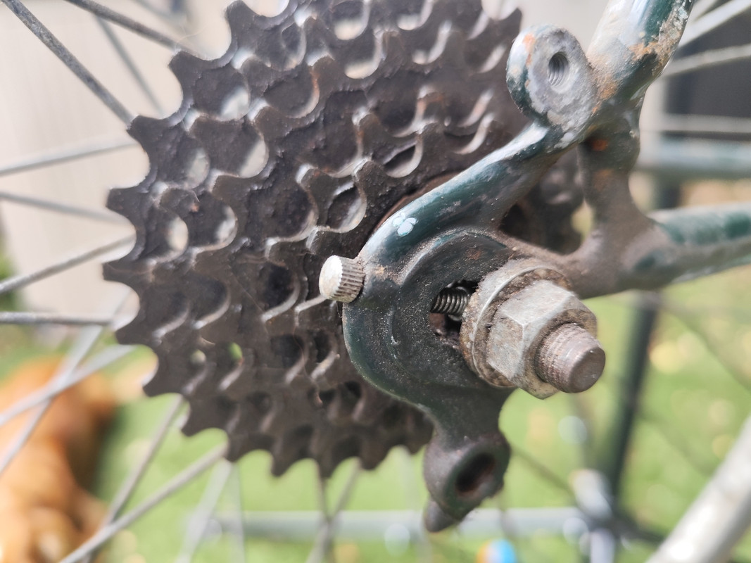

Bottom bracket was stripped and no wear on the cups so was repacked with grease. Head bearing races and cups were worn so the whole thing was replaced. I found a Suntour rear mech from the same era and also some drilled Wienmann levers plus NOS boots.

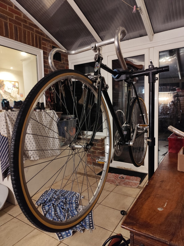

5 speed freewheel has no play so got a scrub and clean up. Front wheel is fine, rear one has a couple of loose spokes and needs truing up. They are 27 x 1 1/4" and mated to Mallard hubs, tyre choice is limited but I found some gumwalls that look okay along with new tubes.

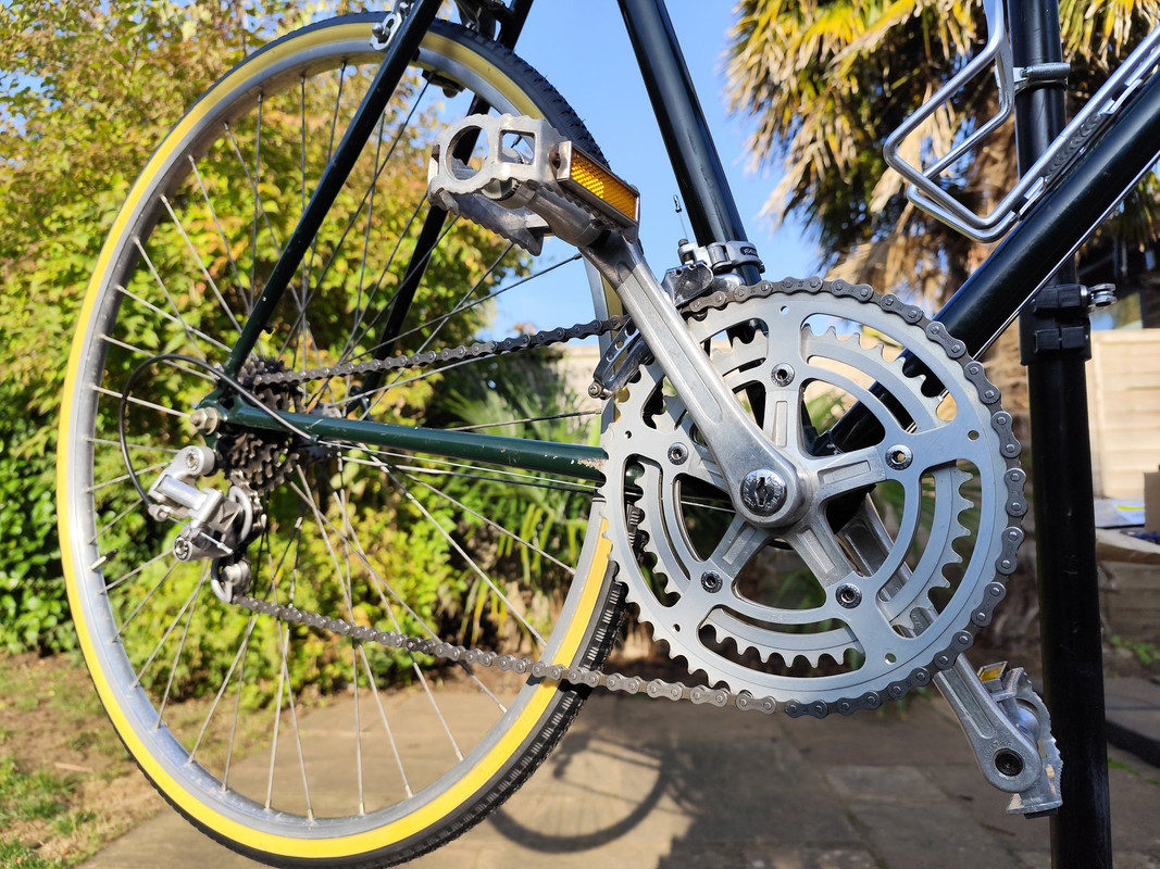

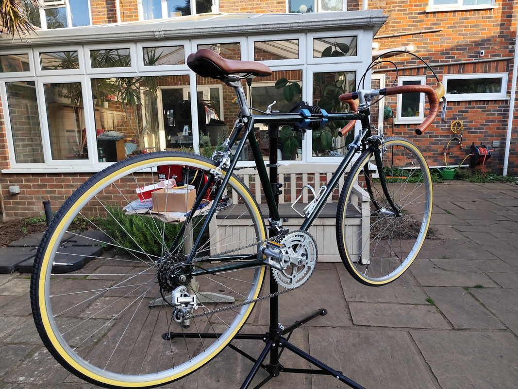

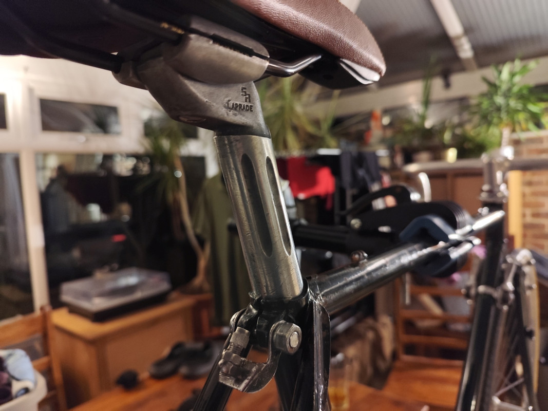

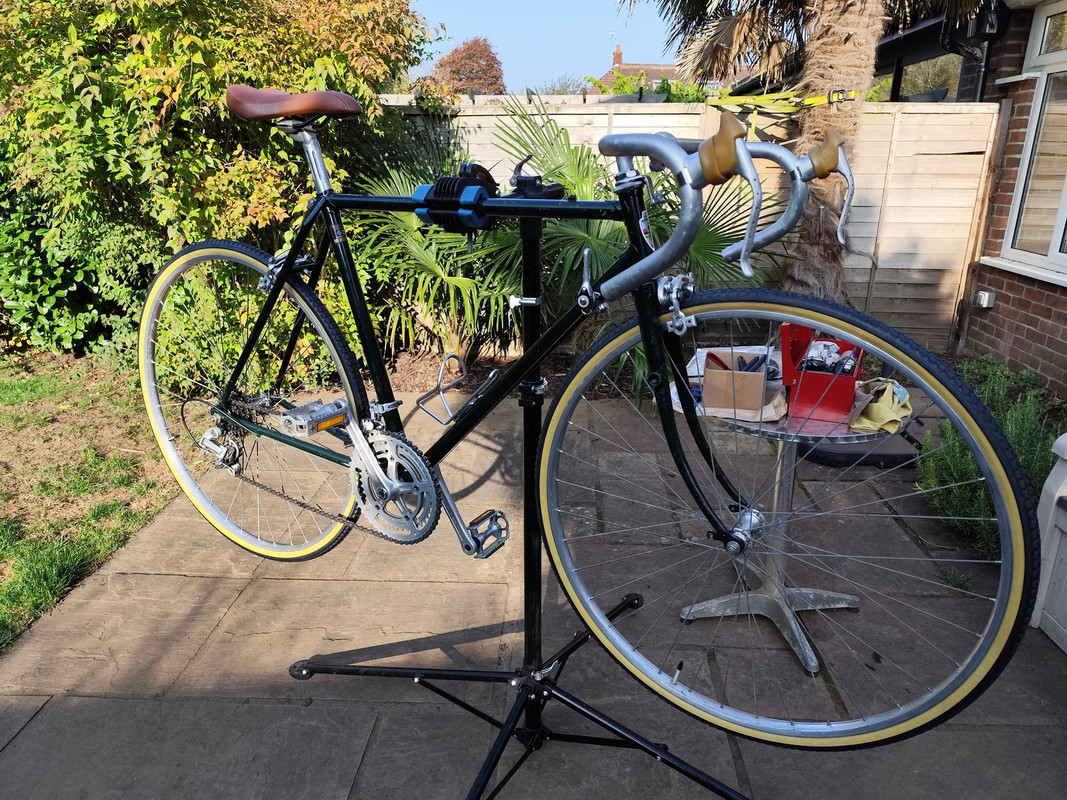

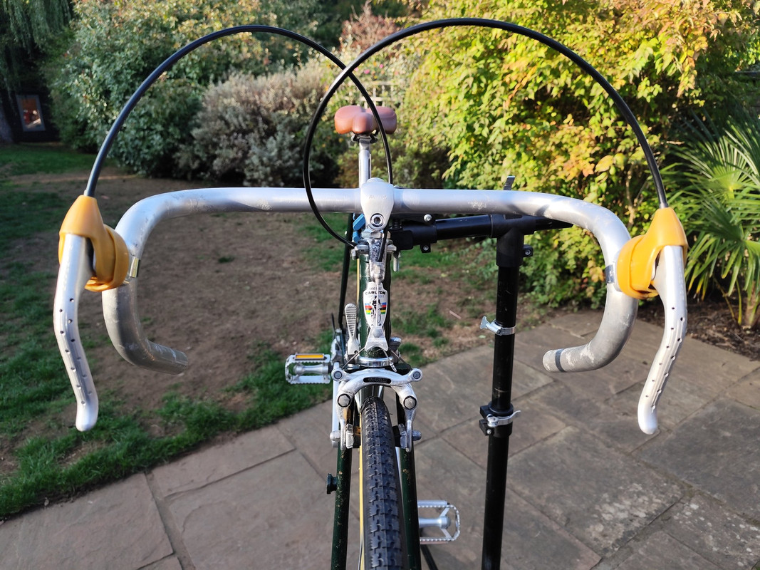

Got back from Las Vegas yesterday and all the bits I've ordered from eBay and Ali Express have arrived. The chain had escaped at some point in transit and just an empty box was delivered, but I got a refund and Amazon will deliver another tomorrow. A 1970's ally SR seatpost replaces the old chromed steel one, and a modern brown saddle and bar tape should keep with the retro theme. New cables are to be fitted and I still need to true up that back wheel.

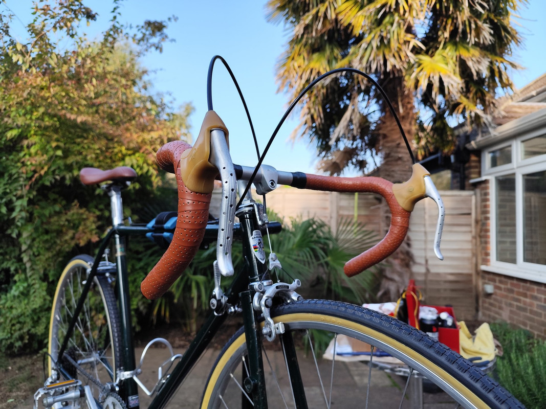

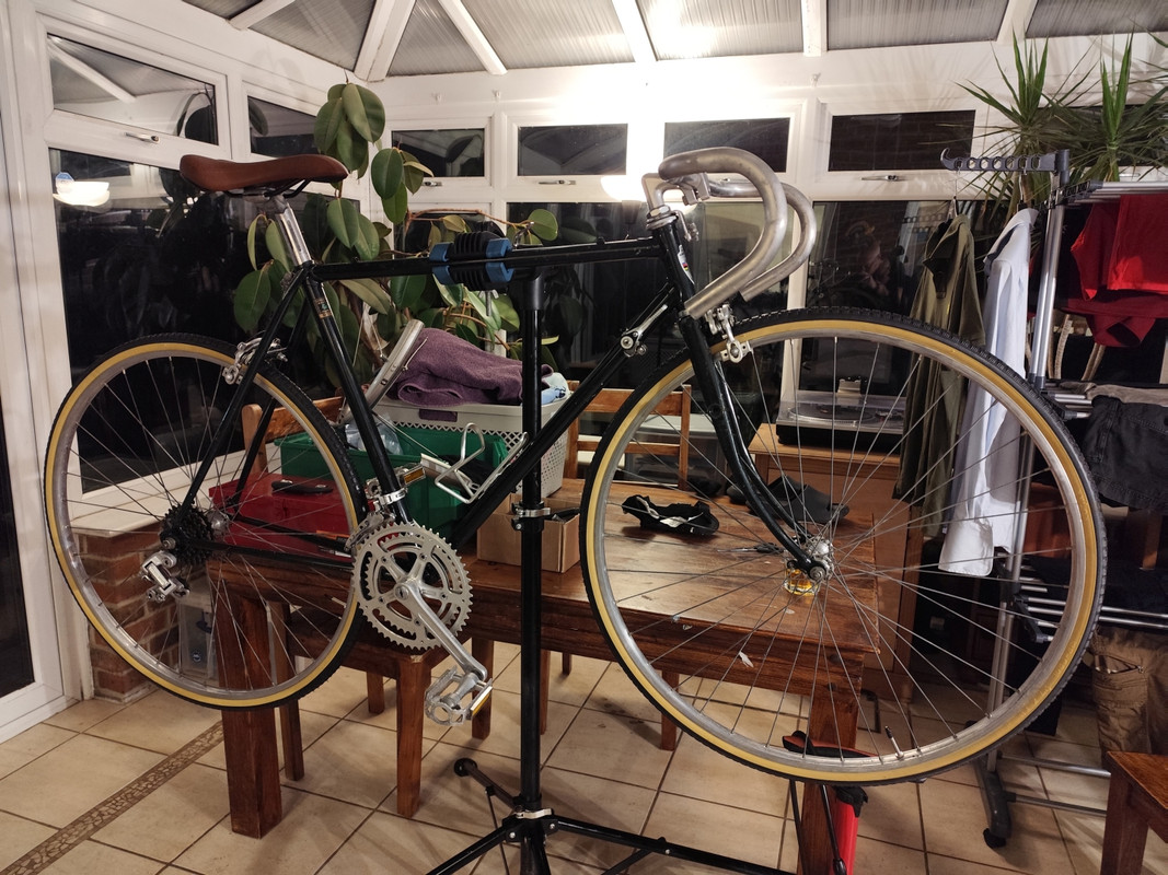

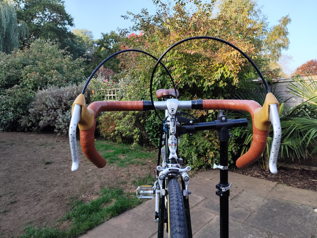

Chain and bar tape arrived today. Fitted the gear and brake cables also. Lovely looking bike. Just the buckle and loose spokes to sort in the rear wheel and regrease the pedals.
