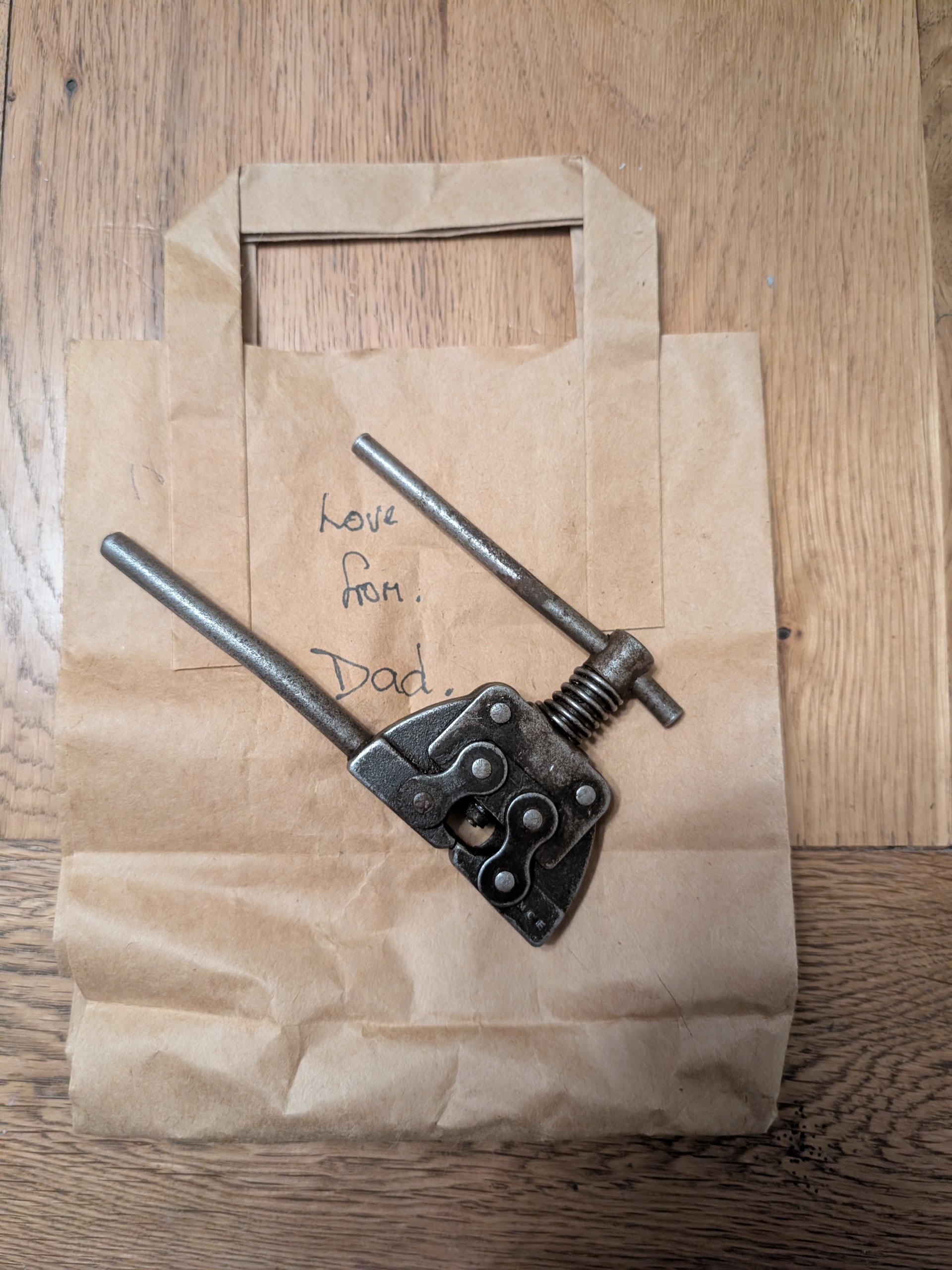

Since I was in my early teens my old man told me he'd leave me his chain breaking tool, 30 odd years later they read his will and he'd left everything to my mum... except for this.
I'd still use the angle grinder tho'

KungFooBob wrote: Tue Apr 21, 2026 9:11 pm Since I was in my early teens my old man told me he'd leave me his chain breaking tool, 30 odd years later they read his will and he'd left everything to my mum... except for this.
My dad's still going, but I borrowed his one of those and then emigrated with it so it's mine now :banana-dance:
You're supposed to grind the rivets flat before pressing the link off or you can break the pin.
I've got one of those, it might push the pins out of a bicycle chain, it wouldn't do anything to a 525 chain, I tried a heavy duty chain splitting tool in the past, I just bent the tool, you definitely have to remove the heads before trying to push the pins out.
