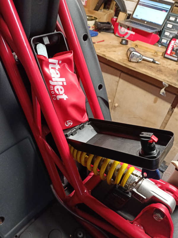

or of course, the original toolkit, which mine has 8-)

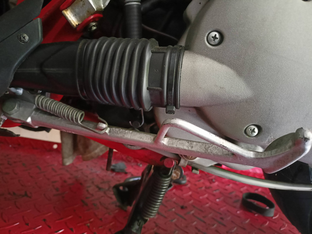

Pretty much as soon as I got it I adapted an old ZX6 ( I think) sidestand to fit, as they don’t come with one as standard , and it looks so much cooler just flicking it out as you jump off rather than lifting it onto the centrestand :-) ) , and just used it for fun little local runs to the shops in my shorts and flip-flops for a few years.
Along with adding a sidestand, I did make a few other small changes to it in the first year or two that I had it, all cosmetic, as I thought they made it look nicer, and they were to replace the chromed plastic top-yoke/instrument surround and handlebar switches (also chromed! ) with black ones, replace the silver brake levers with black to complete the look, and lose the massive standard stalk mirrors with a small single bar-end unit.

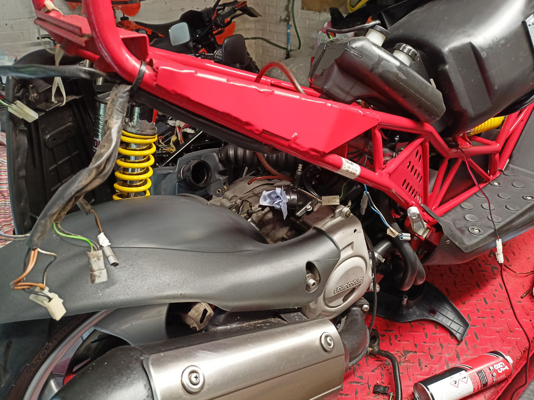

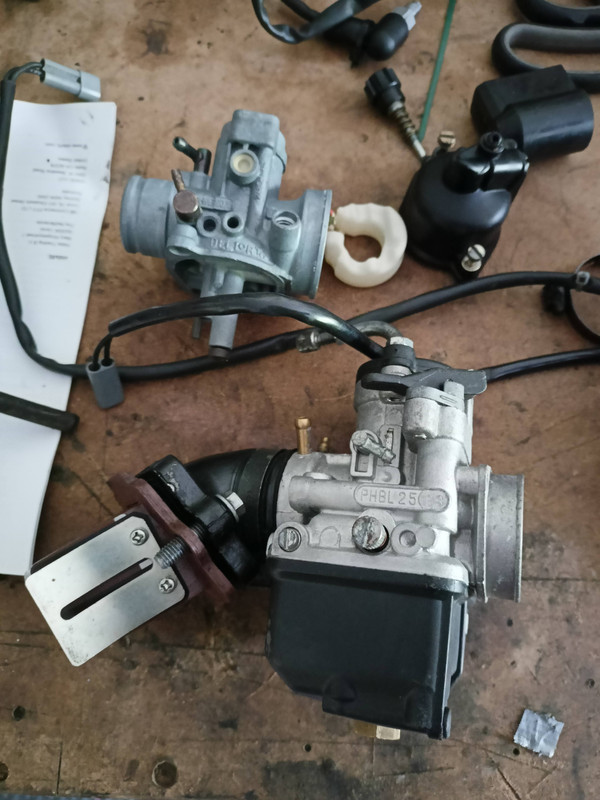

A little bit of an update on the dragster- I topped the battery up (it's a whopping great YB10L on these, feck knows why other than it fits neatly in the space) with getting on for half a bottle of de-ionized water and the Optimate brought it back to life after 24hrs or so.
It seems to be holding a charge so all good there, and after giving all the pipes and clips/clamps a once over, taking the plug out and dripping a little bit of Motul's finest down there, I just went for it and tipped a bit of fuel in, turned it over a few times on the kicker with the ignition off and throttle open and she fired up on the button instantly.
It was very very rich and smoky for the first minute or two whilst the choke was on but within that picking up OK - as soon as it heated up a bit and the auto-choke went off however, it was shite.
It would tick-over and if you could manage to nurse it past the bit above tickover then it would rev out OK, but most of the time would die getting it there- the good news though was that the revs weren't racing away like I seem to remember they were a number of years ago, so I'm reasonably confident this is just carb problems, so the spanners came out and this is how it currently looks
I started stripping the carb down ready for the ultrasonic bath, and the penny almost immediately dropped- these have a "tamper-proof "sealed pilot mixture adjustment screw, and that remained untouched from new - somehow when I previously bathed the carb I'd missed that, feck knows how, but I am 99.99% sure there will have been a blockage in that air bleed passage, and sure enough, although the rest of the carb and jets etc were still nice and clean from their last bath, when I'd managed to extract the (headless) screw, it looked pretty yucky down there, so it got a blow through with the airline and an hour in the bath, which has brought it back to how it should be.
I did briefly think about buying a new proper adjustable brass pilot screw as the Dell-Orto importers are the sames ones still that I remember from 30+ years ago , are only down in Reading and hold good stocks, but have decided for the moment I'll save myself a tenner and just try things with what I've got, so I got the hacksaw out and put a slot in the top of it.

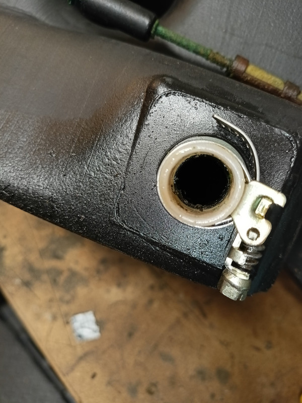

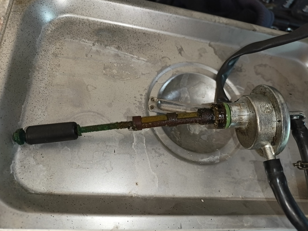

While I was at it, I had the tank off as the vaccum-operated fuel tap is permanently "on", so I was pretty sure that and the tank would also have suffered from leaving that fuel in it all those years ago, and I wasn't wrong- this is the tap and the exit hole in the tank where the tap sits....
New taps are available and pennies relatively speaking, so that one is going in the bin and a new one is winging it's way to me now along with new pipes to replace the now very brittle current ones, and I'm off down to Tescos later for some white vinegar to sort the tank, and when the tap arrives I'll nail it back together and we'll hopefully have a runner.
Along the way I've also managed to find the little stash of bits I accumulated some years back for it, and in amongst that the big-boy carb and manifold ( pictured below with standard for reference 8-) ) so assuming she runs as expected when I get it back together with the standard carb, once it's MOTd and I've run it around a bit, I think an anti-social ped-boi spannie and some different weight rollers etc will definitely have to be sourced for a little bit of dyno experimentation along with the big carb, as it would be rude not to eh :D
