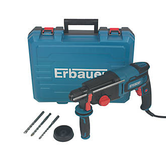

I've a cheap SDS like this one. It has seen little use up until now,should do the job.

I'd be checking out hire costs of a diamond core drill and arbour/masonry bit and compare with how much the same costs from Screwfix or other discount sheds. Your SDS drill should be up to it if it's only single brick. Don't use it on hammer, though.

Oh and don't use it on hammer, I'm surprised nobodys mentioned it yet.
