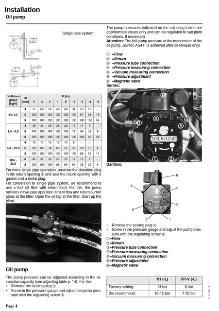

Re: Bleed oil pump
Yes its exactly that pictured top right (albeit on my boiler it's orientated 90deg clockwise and the "pressure tube" and "pressure adjustment" are flipped). It even shows the same two-way feed-return filter set-up.Taipan wrote: Tue Nov 14, 2023 10:24 am Doesn't look like it has a bleed valve as such? Not sure this is the same though?
But yeah - nowhere obvious to bleed it - like I say, fuel does bleed, although no noticeable air if you crack various unions - and it will piss out in a lovely stream if you undo the 'P' and 'V' ports.
