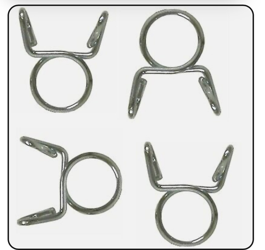

Like these?

Those clips are hopeless. These are much better although need to be carefully sized.
