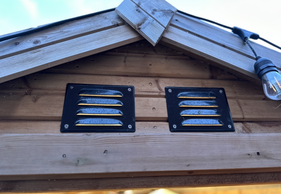

Right, went in the shed today, some very small fine mould in forming on the roof.
I’ve not finished putting up all the insulation boards (it’s a slow process due to time 😂😂)
Basically how much ventilation do I need/should I have.
The shed is 5 meter long and 2 meters wide.
I’ve attached a picture of the vents over the door and at the rear. Other than those 2 there is nothing.
One suggestion I’ve had is turn 1 or 2 of the sealed windows into something that can open and close.

The vents will only do so much. You probably have static air where the mould is. I'd be tempted to get a greenhouse heater (fan heater basically but I assume a bit more robust that the cheapie indoors things - I got a couple, one to keep the condensation at bay in the conservatory and one for my cabin). Just stick it on slow blow and don't worry about using the heat (or set it to come on at 7° - which is what the heaters are set at in the cabin and conservatory. There's a panel heater on thermostat in the cabin, the blower is really only to move the air around or a quick burst of heat if I just pop in for a short visit).

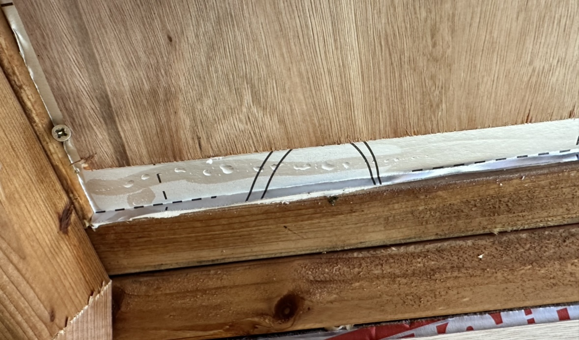

So I did some investigation today, and I’ve found these water drops on the top of the shed (please excuse the fact there are gaps) they seem to run along the Center beam or what ever it’s called.
So the sheds pretty warm, all the wood inside and along that part feels warm and dry, it’s been hammering it down the last few days as well and I am sure water is Not getting through the roof.
So my guess it’s condensation 🧐🧐🧐
And the fan should eliminate that right ?
Going to order something tonight (anyone have a good suggestion on what to order, or just go with my link above)
