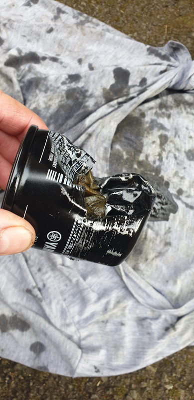

Time for a quick oil and filter for the MT. First 2 had been done at dealer for warranty bollox. Off with the sump plug and oil in container, sorted.
Now the filter. Ffs could I move it 🤬. I've read in the past that Yamaha are notorious for over tightening filters from factory, but this should have already been changed at least once. Do I trust dealer's, no i don't.
So me thinks this could be the original, who knows. First attempt to remove was with proper socket that fits to the flats on outer edge, rounded them. Next was a belt strap, just slipped. Next was chain wrench, this squashed the filter so finally the screwdriver and hammer. Again further destruction of filter and no movement.
Finally, back to chain wrench but with plenty of grippy bits of filter to grip on to and I saw movement and eventual success.
Why o why do they tighten them like this, arseholes. Anyway, job done and sorted but not as quick as expected. 🌝👍

I had one once where I applied so much pressure using the screwdriver method (after all others had failed), that it just sheared the whole thing from the base. What a ballache that was. IIRC I ended up drifting it off.

Hand tight + a wee nip with a filter socket is all I've ever done. I'd not trust a shop who employed anyone to swing on an oil filter.

It was just the same in my experience with a Yamaha dealer service, and I'd done the first filter change so it wasn't the factory.

I've never done them up more than (as tight as i can get) hand tight.
