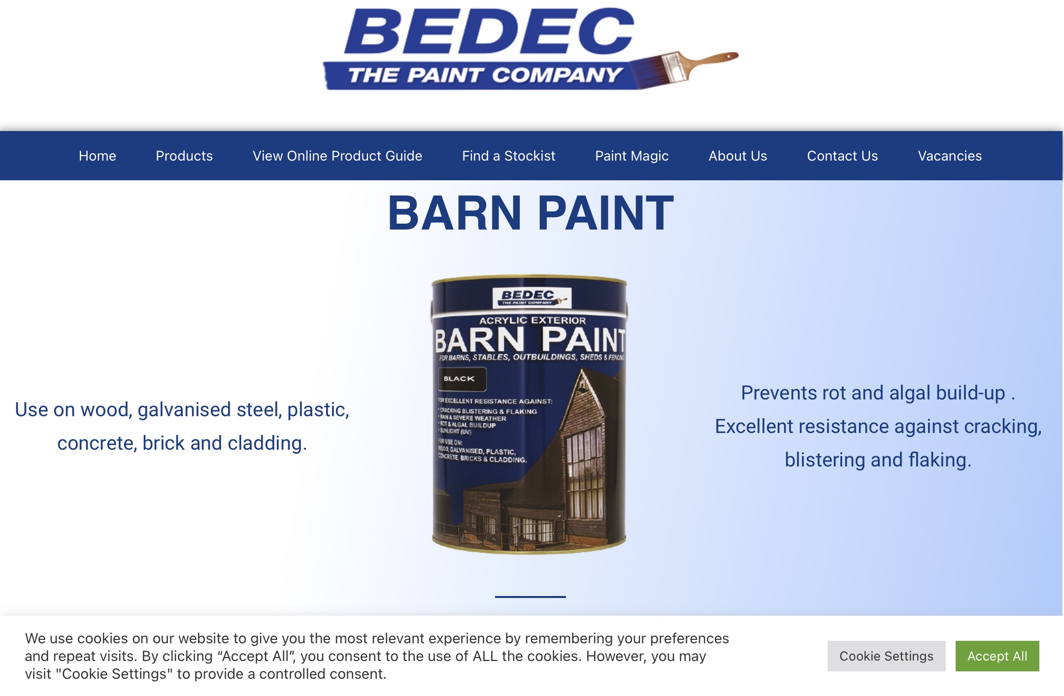

I used white Acrylic Barn paint on mine after a quick sanding and wash down.
It still looks good after 10 years.
This one
This one
