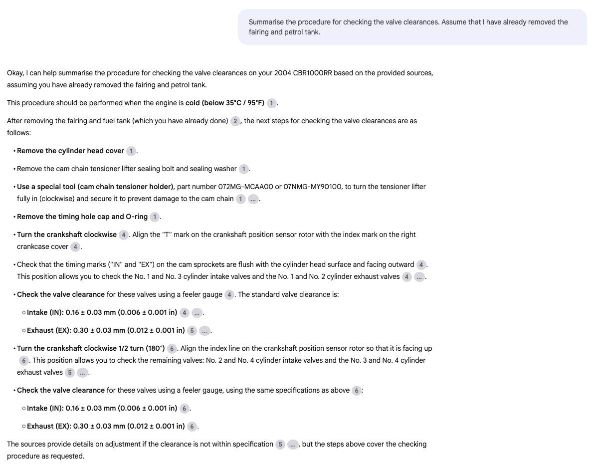

Here's something you'll either find interesting and useful or decry as the work of the devil...
Open up notebooklm, add sources such as your workshop manual and youtube videos about servicing your bike and then you can ask it questions such as...
Screenshot 2025-05-28 at 13.59.07.png (105.44 KiB) Viewed 343 times
It even provides links for you back to the documents and videos you gave it.

dern wrote: Wed May 28, 2025 2:02 pm decry as the work of the devil
That one.
If it's 'learning' from the sources you give it access to, why don't you just go to those sources first and look up the answer and avoid any potential 'AI' hallucinations.

Because it can summarise and cross reference in a way that's interesting and useful. Also, as it gives you the references, you can verify the answers. Obviously the examples given were relatively simple.
