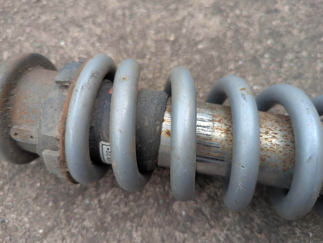

The boring bike keeps on being boring and staying every day 🥳 but the rear end has been feeling a bit crap for a while so I bought a YSS shock to go in there.
This thing was not designed to be able to change the shock easily but it's done and test ride will be later after I've changed the fork springs as well.
Lol at the state of the OEM shock, the rod is corroded and scored too fuck, no wonder it didn't like to squish very much.🥺

Taff wrote: Fri May 30, 2025 1:49 pm The boring bike keeps on being boring and staying every day 🥳 but the rear end has been feeling a bit crap for a while so I bought a YSS shock to go in there.
faark.
I assume it's completely exposed the crap flying off the back wheel?
Even having a hugger doesn't always prevent this: I've seen factory fit huggers with holes cut in them in precisely the right place to allow crud to be thrown directly at the rear shock.

Yep, that's exactly the problem, directly in line with the rear wheel and riding all year around.
I guess I need to find either a flap to attach to the under tray or fruit a hugger.

Taff wrote: Fri May 30, 2025 3:41 pm Yep, that's exactly the problem, directly in line with the rear wheel and riding all year around.
FWIW my Rocksters have a small flap that hangs down to protect the shock, it works surprisingly well.

I fitted something similar to my Tiger from pyramid plastics, I've had a look and can't seem to find any sort of generic flap that can be glued / riveted on.

R&G shocktube?
I've no idea if they're any good, they probably make the shock over heat quicker or trap moisture inside making them rot quicker... or maybe not?

KungFooBob wrote: Fri May 30, 2025 6:33 pm R&G shocktube?
I've looked at the shock tube but the moisture thing niggles me, I can't imagine overheating ever being a problem on the CBF :lol:

Coat the whole thing in Vaseline (or LM grease), then put the shocktube on so you can't see it.
