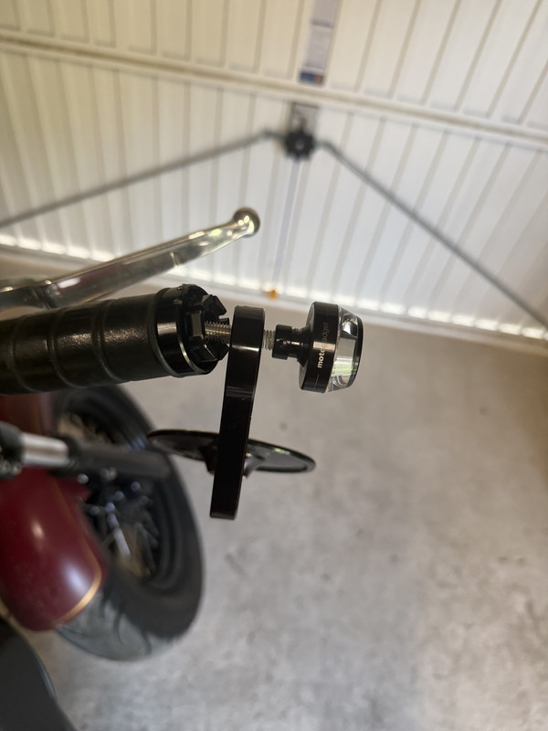

So I’ve managed to tap the ring thing closer to the grip
When putting the indicator back in- I can’t tighten, it just spins and spins. Indicator still works

Any genuine suggestions welcome. I’m stuck

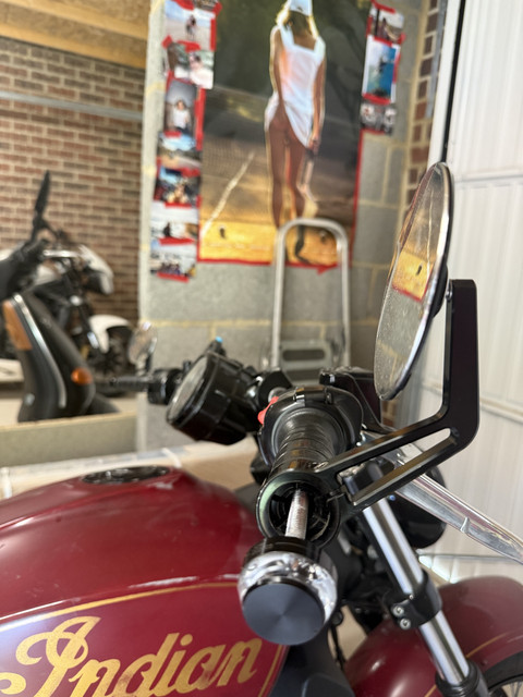

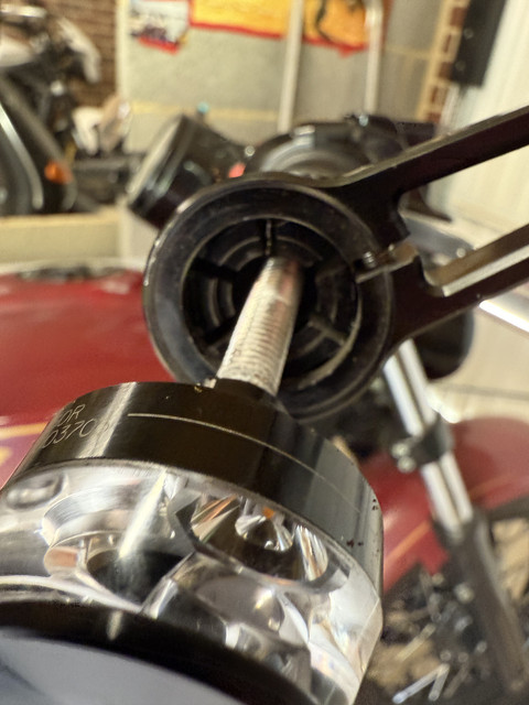

More pics. I can’t pull the indicator out because the wires are attached internally and the screw is too long.
Posts: 17513
Been thanked: 9505 times
Re: Need to be concerned?
https://manuals.motogadget.com/docs/mo. ... ctions.pdf
You're missing the washer, rubber part and m8 nut.
KungFooBob wrote: Sun Jun 01, 2025 6:18 pm You're missing the washer, rubber part and m8 nut.
Might still be inside the handlebar.

They will be they've no way of escaping, they should be on the other side of the collar he tapped back into the bar.
Best guess is the nut has gone walk about if he can't get it to engage the threaded bar on the indicator.
