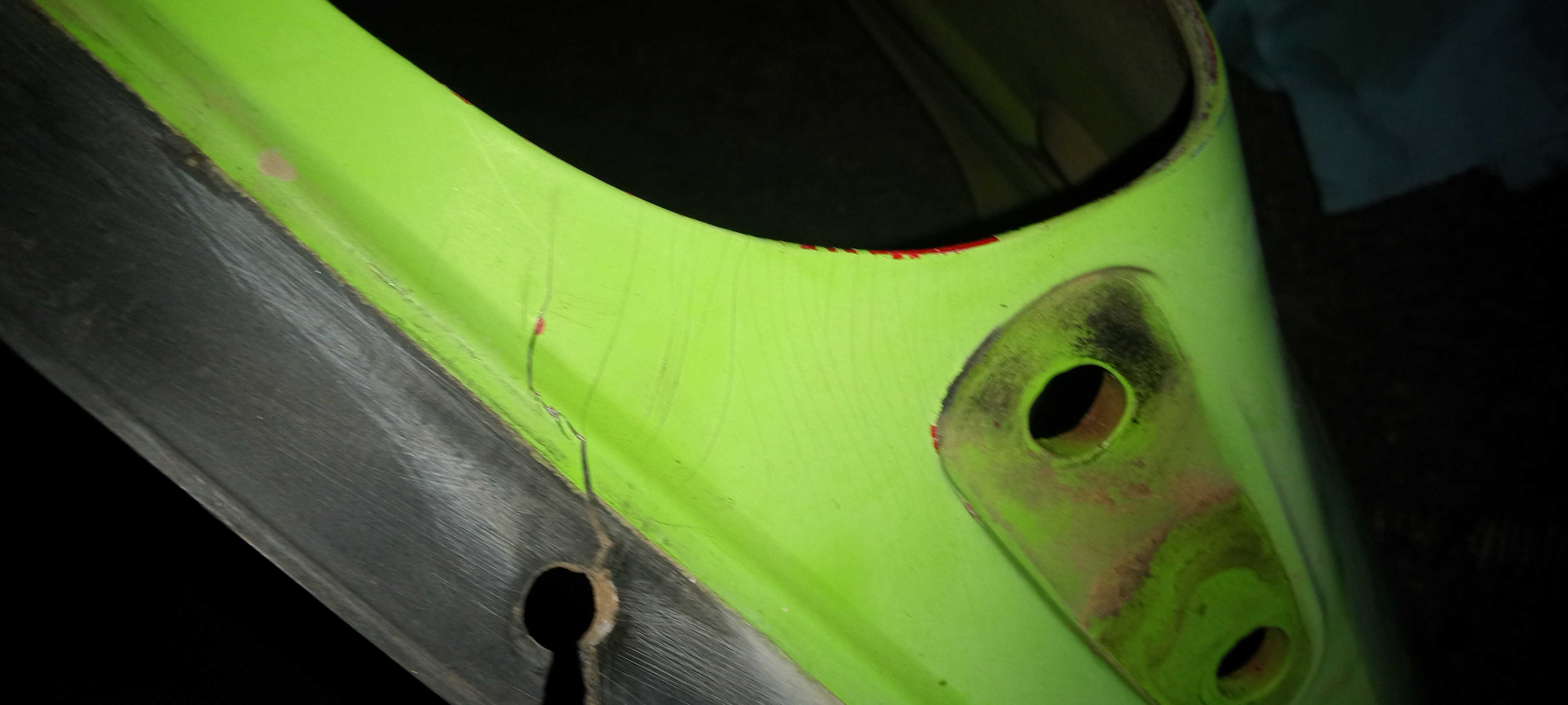

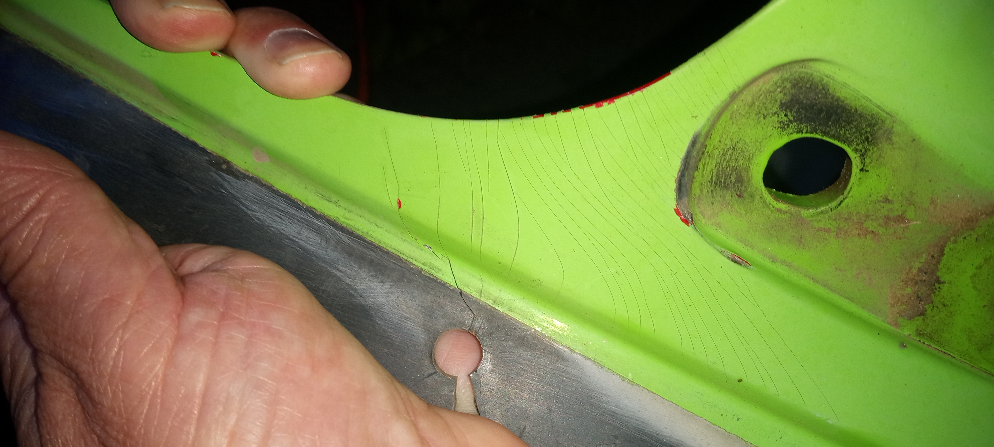

This crack closes up when manipulated, so it will be getting a hot staple or two on the back side. Picked up a 50W hot stapler from Horrible Fright for a pittance. The reviews of the 100W versions on Amazon were all over the place & the 200W jobbie had even worse reviews.
Got a lot of sanding to make those stress cracks disappear... I see a lime green rattle can in my future...

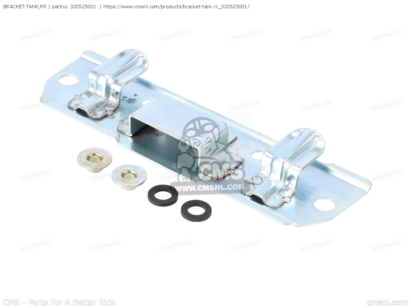

Crikey, found some bloke in the US who made some exact replicas of the tank/seat bracket doodad! Hope he has some left as he made them a few years ago...

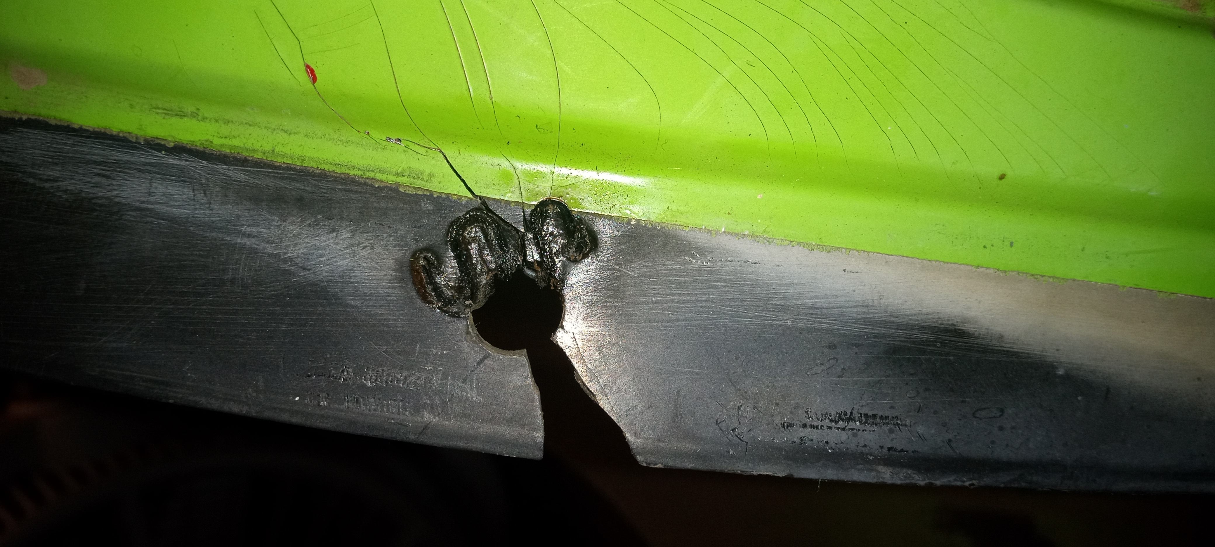

Fired up the hot stapler. Thank fuck I didn't get the 100w or 200w versions...
First attempt I managed to put the staple right through the fairing. Reheated it & removed that one... started over, got the hang of it by end... two wrigglies, two wavies. Probably should have used four wavies.
and should have used those visegrips instead of trying to hold the crack closed with one hand when I put that first one through the fairing.
No biggie, short, but steep, learning curve is all.

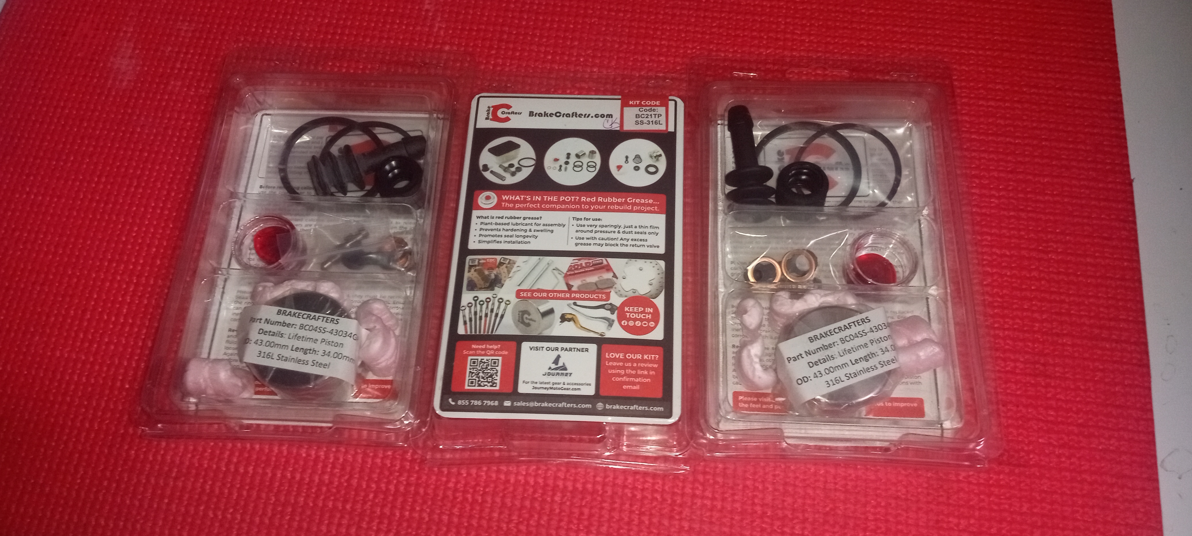

Arsebiscuits & buggery bollocks...
On the left is the caliper kits I ordered without the pistons, then realized I needed the pistons too.. so ordered the kits with the pistons. What showed up today are the kits on the right.
Original pistons don't use that big fat dust seal & have no groove. New pistons have a big groove for that dust seal.
Old pistons WITH the isolators are the same height as the new pistons WITHOUT the isolators, With the isolators they're 3mm taller.
& the other rubber gubbins is obviously different.
New piston on left, old piston with isolator in the middle & without it on the right... Isolators aren't removable on new or old pistons, two of the old pistons had isolators that were buggered & fell out in pieces.

Plan was to put the first (pistonless) kits in the parts stash as the GPz11 has the same calipers as the GPz750 (& GPz900-R, KZ1000-P etm), but the 11 has 280mm rotors to the 750's 270mm

Brakecrafters were great to deal with, They've already sent the correct kits & sent a doodad to print out to ship the wrong kits back. Will be dropping them off at FedEx today.

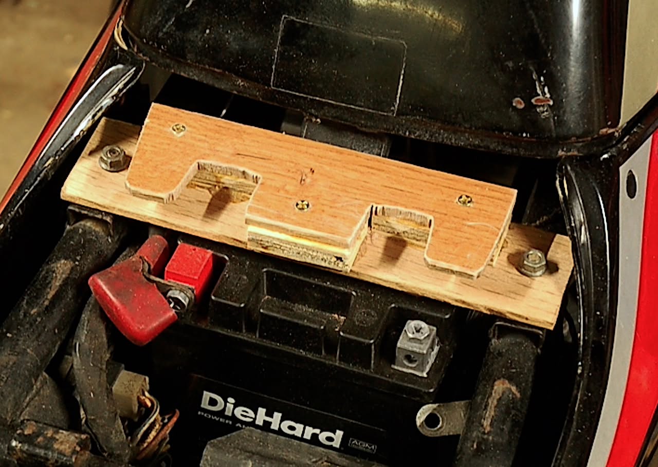

Second buy was an exact replica of the bracket that secures the battery, the front of the seat & the back of the gastank. This part:
I decided not to ask the self-professed *carpenter* to make me one like he made for his own bike... Thank fuck we weren't relying on this guy to build the Ark..

That's a scary thing to see.ZRX61 wrote: Sun Jul 12, 2026 3:39 am I have abandoned my Luddite ways & signed up with PP. This was to facilitate buying parts without the ballache of not owing a checkbook.
First buy was a box of stuff from a guy here in Ca that had all sorts of gubbins I require for the GPz750 (especially the front master cylinder), but I also spotted some bits I can use for the GPz11 (indicator relays).
