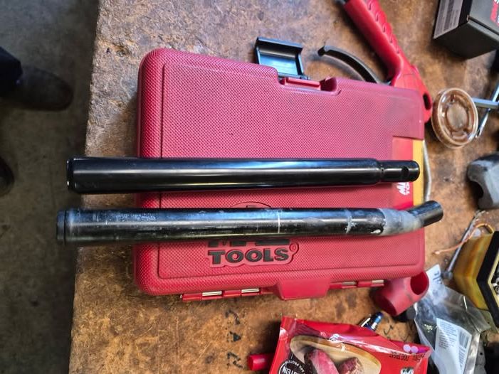

Mech mate texted me saying the handlebar I got is the wrong one... it's the right part #...
